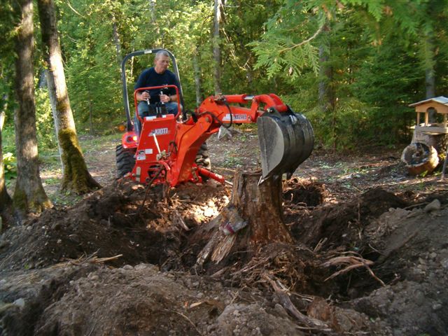

I am not sure whether you want a TLB in the 30-40 hp range or you are talking about something that compares with Kubota's BX26. I have made my own comparisons between the smallest TLB from Kioti (22 h.p CK-20) and a Kubota B-25.
I chose the CK-20 because it appeared to be a capable and sturdy tractor for my needs. It is actually not fair to measure those two because the small Kubota is a SCUT (sub compact) while the Kioti is more of a CUT. I felt the KIOTI'S considerable weight advantage of over 1000 lbs was an advantage so far as I was concerned and I was also impressed with the specs for lifting and all the rest of numbers for the backhoe and FEL. The Kubota BX-26 is a great little tractor and I was impressed none the less.
I now have over 700 hours on the CK20 in the three years since delivery and I have removed well over 50 mature tree stumps and it ripped every one without crying Uncle. That CK20 fitted out with a backhoe and FEL weighs in at over 4000 lbs.
