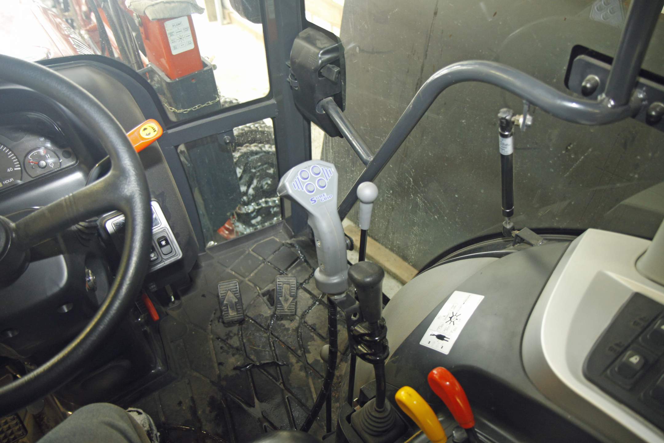

The Kioti Won't have the float action. What you want is both remotes with the detents removed so the lever will return to neutral. The remote closest to the FEL will be your grapple remote make a extention to bring the handle just below the FEL hanldle.Ggrsthegreat made the extension for me.
   / Kioti Hydraulics - What do I need for a grapple and hydraulic top link? #4

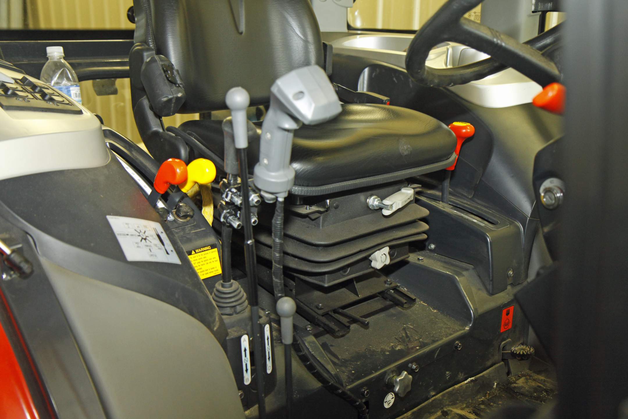

also, you can easily make extensions for those handles....i did and love them. Way easier to control while moving the bucket control. The 4 button remote is used to control the front mounted snowblower in winter blower control 6.jpgblower control 8.jpgblower control 9.jpg

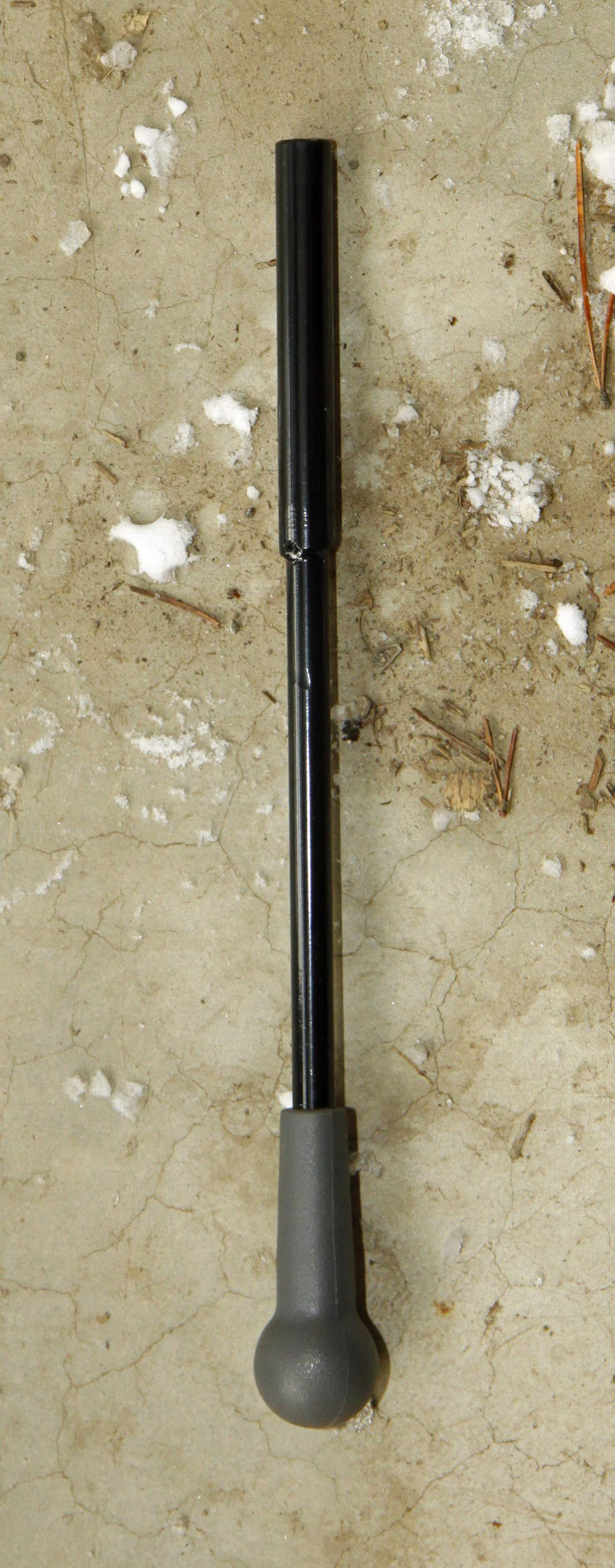

the rubber knob simply slips off. I used a solid rod the same thickness as the original and a piece of hollow tube that fits over the knob with minor widening with a drill bit. i welded one side and the other simply slips over the original.
I can get the dimensions of the metal later today and post them. Whole thing takes about 20 minutes to manufacture. It slips on and off in seconds.

ok, heres the dimensions
solid rod is 3/8" steel stock, solid. I got mine from Home depot item # 48930
the hollow rod used to make the connector is 1/2" outer dimension with 1/16" thick wall. leaving the inside just shy of 3/8" (.375). Home Depot part # 35170.
I had to run mine thru drill press to make it a scosch bigger opening so it would readily slip over the tractors shaft without scarring the paint. Then i tack welded the pieces together after pushing the connector sleeve 1/2 way onto the solid shaft.
This unit can now slip on and off as i need it.
