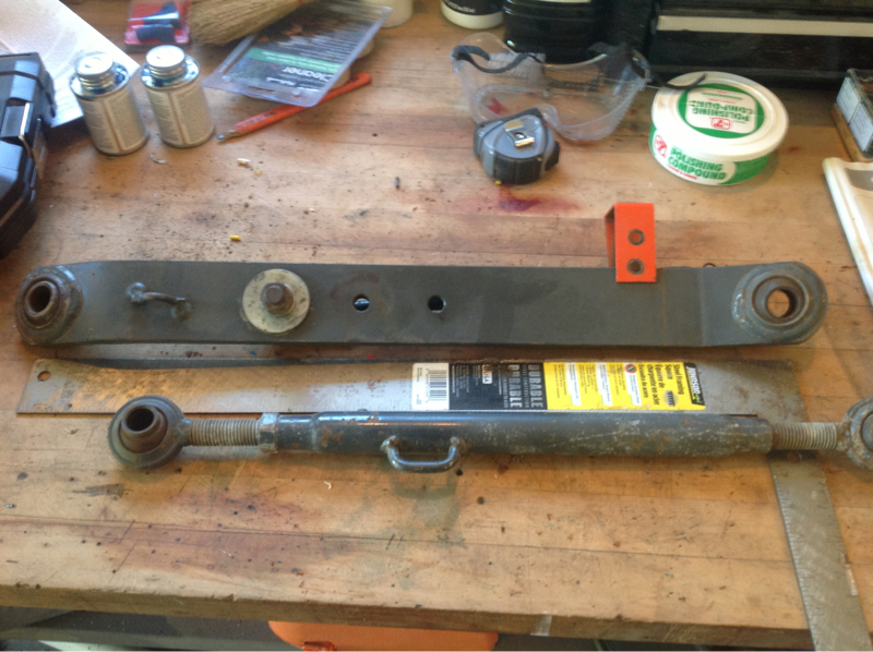

   / Kubota B21 - 3 Point Hitch #2
Arm length 25 3/4: top link 14 5/8
Thanks Mikesee. Appreciate the help.
I'll see about ordering one.
John
