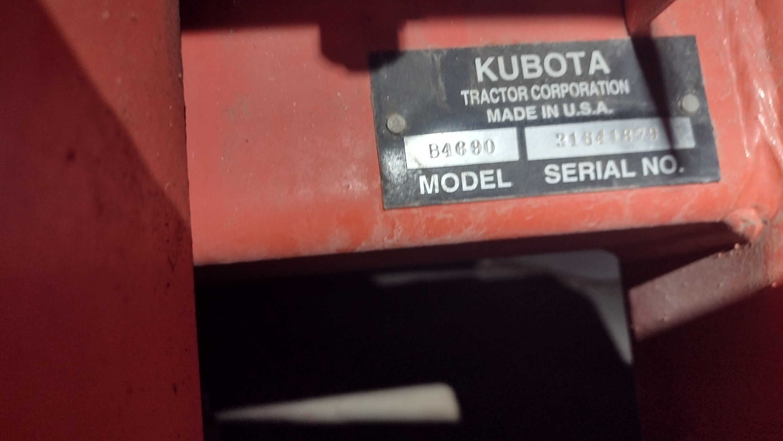

I have an early model Kubota B4690 3pt backhoe. This is not the BL4690a/b later model. The placard says made in the USA, the bucket placard says made in the USA by Woods, and all of the hardware is SAE.
Does anyone happen to know if the backhoe itself was also made by Woods and branded Kubota?

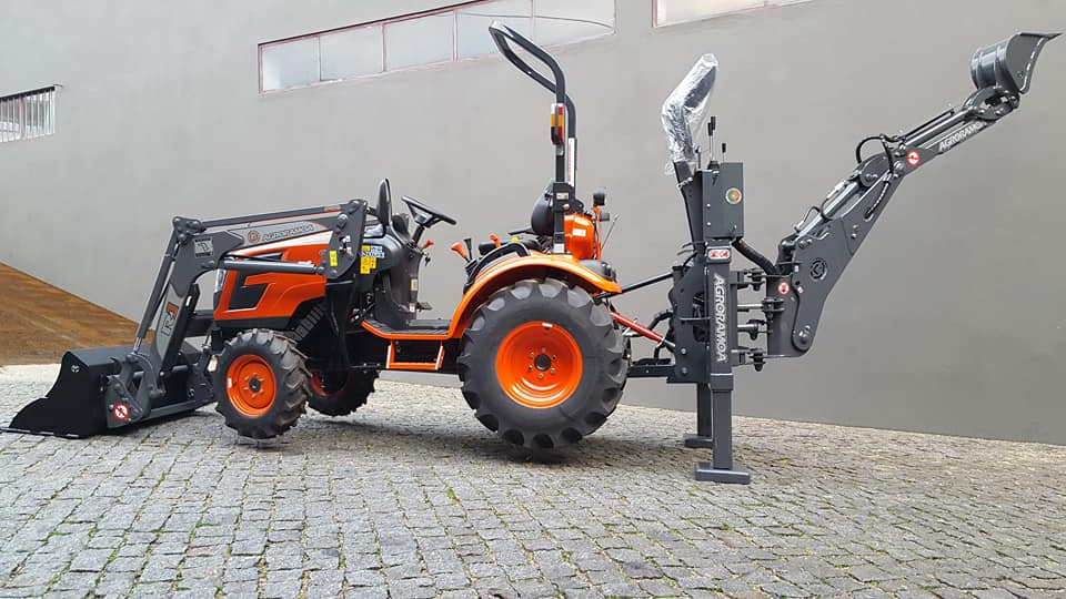

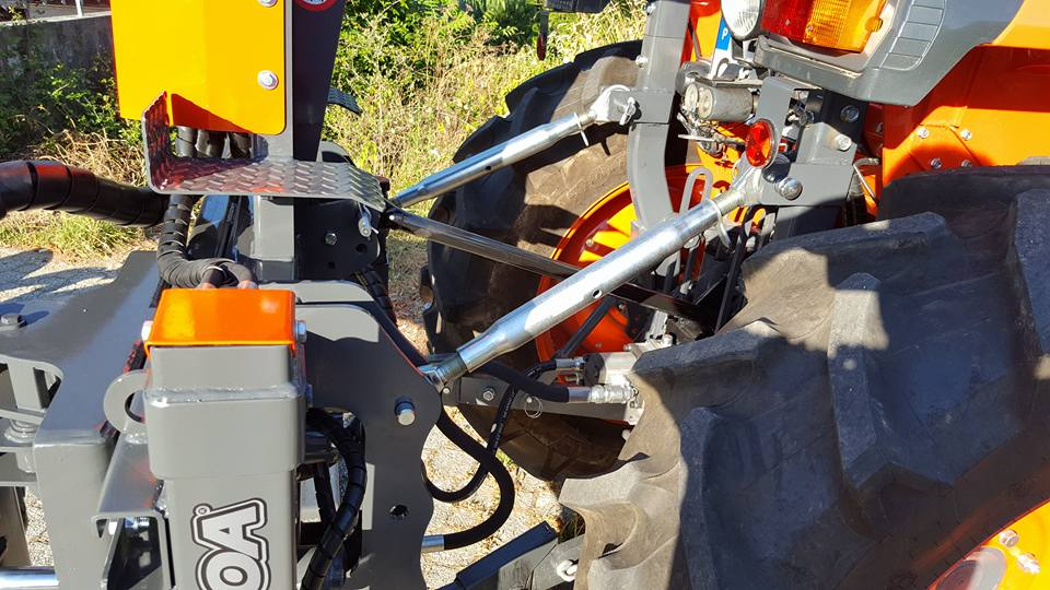

Around here, pretty much the only backhoe for a tractor one can get is the 3 pt one. However, these are setup with at least two extra top links that attach on different areas on the tractor, typically to the ROPS or somewhere around the rear end housing, so it spreads the loads on more areas than just the top link mount as shown in pictures #1 and #2.
When these extra links are not used, damage is more prone to happen, however since most tractors here come standard with draft control, the top link mount usually pivots on a shaft so it sends feedback to the 3 pt valve. This mount usually ends up acting as a mechanical fuse and avoids a lot more expensive damage like broken castings that we've seen on this forum over the years.
A couple great benefits of the backhoes we have here, is the vertical telescopic stabilizers along with the side shift feature, usually manual with hydraulic locks or fully hydraulic. These two features make it possible to work up close to a wall or fence, plus, you can slide the backhoe all the way to one side and swing to itself, making for a very compact unit. Usually around 2 ft long and you don't get the arm way out the backhoe create all kinds of ground clearance issues on uneven ground or even simply loading it to a truck or trailer, like show on picture #3.
