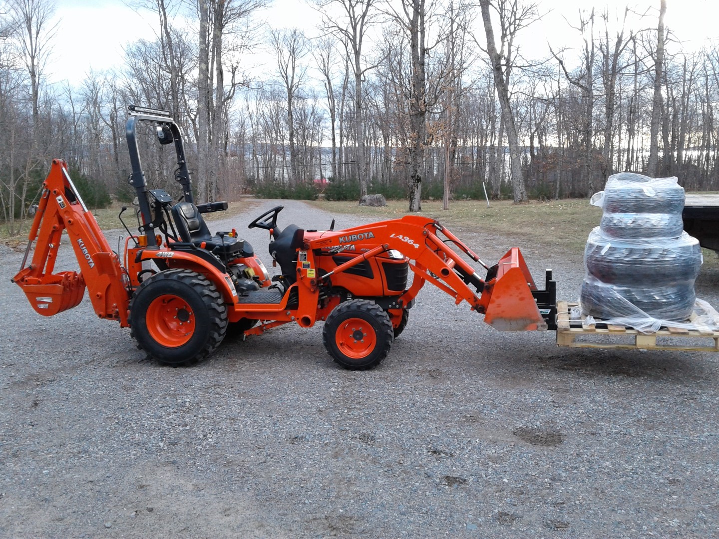

   / Kubota Backhoe Question
They dropped it off last night before I got home. Then went to dealer today to pay for it and my new rims and tires even came in early!!
I'm surprised how well balanced it is, even climbing my steep hills. Didn't feel lite on the front compared to a full size backhoe.
