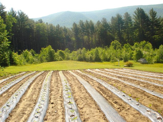

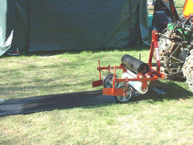

Well not much is going to work to keep weeds in check in between plants except for hand weeding or hoeing unless you use plastic.
You could use a 3 point spring tine cultivater to weed if you have clearance over the plants to weed each side of the row or in between.
For years I used a walk behind tiller in between rows and planted on plastic.
My mulch layer along with my 3 point rototiller are my best investments :)

I've grown commercially in 3 different states here in New England and never had a moisture retention issues using plastic. University level publication always point out the four major benefits of using plasticulture are warming the soil, weed control, increased crop yield, and moisture retention. Normally and when applied correctly more often than not when I slide my hand between the plastic and the soil it there will be condensation underneath the plastic. Most issues facing those grower using plastic usually lie with timing the condition of the soil when putting it down too dry some times but more often times too wet. Especially in the spring.
It can cause issues for growers in extremly hot climates though. Actually heating the ground temp too much . Researchers are always experimenting with other colors than black, like silver and white to reflect excessive heat and also find different colors seem to increase yields on certain crops.
http://extension.umass.edu/landscape/sites/landscape/files/publications/mulch_colored_plastic.pdf
Of course it is not naturally biodegradble and has to eventually be removed and disposed of somehow. I have tried double cropping on plastic film, planting on the same piece two season in a row. Seems to work ok the only thing is I see with that is there really isnt any other way to improve the current soil fertilization for the new season except by side dressing the rows or a liquid application directly to the planting.
I've been working with plastic in the field since the late 80's. Some of larger units can lay a drip at the same time and some also have built in bed shapers. There are bio degradable roll type mulches available now They cost more than conventional plastic and arent as strong. With my little unit I can lay out 2000 feet of plastic for less than the price of 12 bales of straw. :)
Organic mulches are terrific mediums for for soil building though. Thats the whole theory behind cover cropping. The biggest problem using straw in a garden I have experienced beyond the expense of course, is it provides a haven for mice and other small rodents. It provideds them a place to hide and they can wreck havoc with ripining crops, especially tomatoes.
