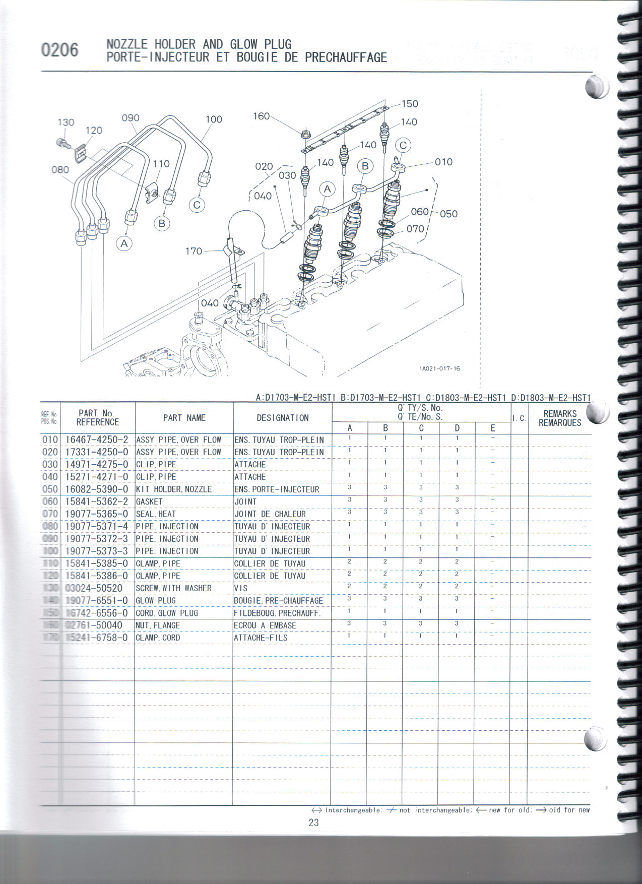

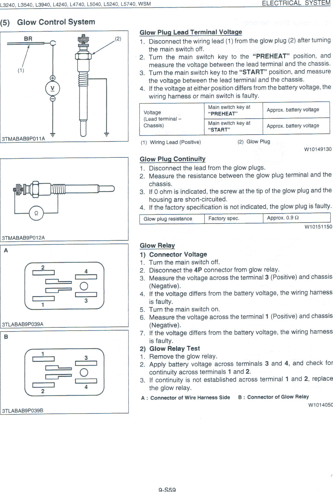

Morning all , I have a 2005 grand l 3430 can someone help me find the glow plugs on my tractor and tell me how to test them , i went through the problem last year with tractor hard to start in cold weather and its back again now its cold ,when its warm out above 45 it starts right up . my panel shows glow plug on and then goes off but i don't believe its accurate , I need to be able to test the plugs and the relay , the nearest kubota a dealer is 30 miles away and its a pain to load up and take to them, if i can figure it out that would be great ,
any suggestions would be great

Here's the information I have for my L3540. It may also apply to your Lxx30 series.
I hope this helps.
-Len

Check for voltage on the glow plug buss strip, with key turned to the "on" position & While the dash 'glow indicator' is lit, there should be 12 volts. KennyV

again want to say thank you , the information was very helpful , narrowed it down to glow plug relay, took it apart and sanded contacts and cleaned terminals , works now but i can feel and hear it click when it works , when it doesnt just the light but no power coming through , seems to work a lot more now that i did that ,
