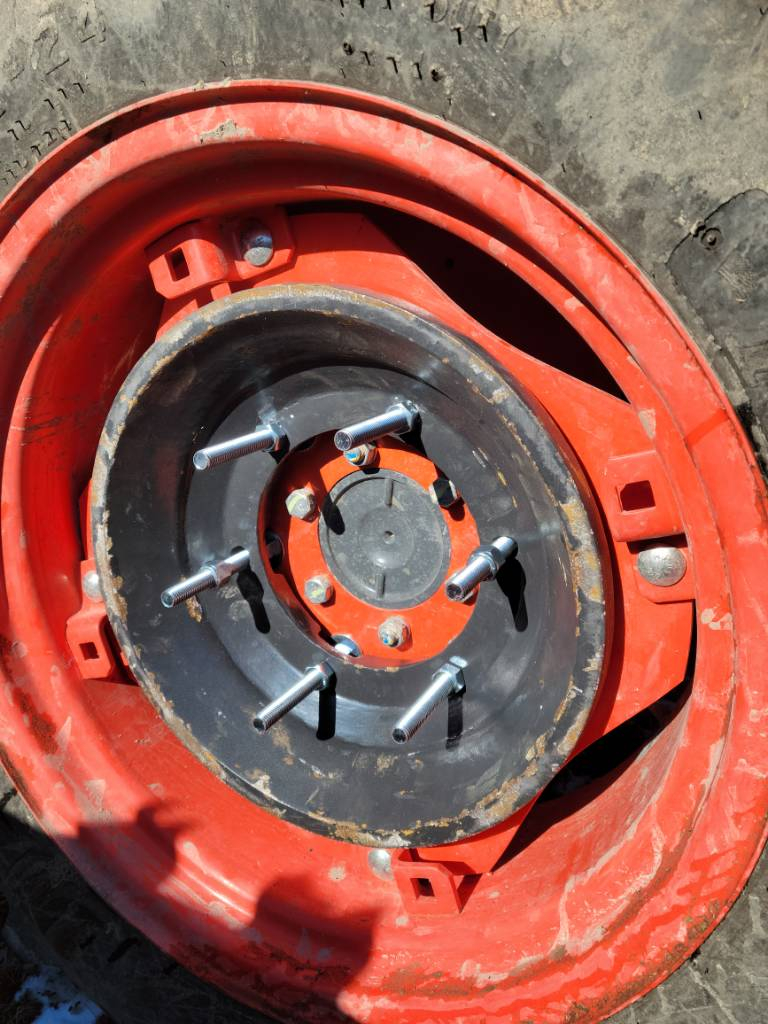

Decided to add a set of wheel weights to my 3901, there wasn't much online that I found explaining how to do it.

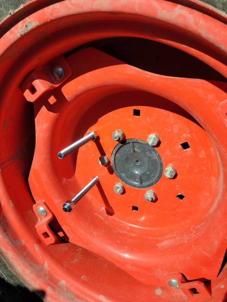

I found that 5/8 carriage bolts fit the holes in my rims just right. Mind you I have R1 from the factory. Next came a washer and single nut tightened as much as possible.
The weight slid on and was followed by 4 regular nuts and 2 nylocks to help fight vibrations loosening the weights.
L8066 is the part number for the weights, found them cheapest on Amazon.
