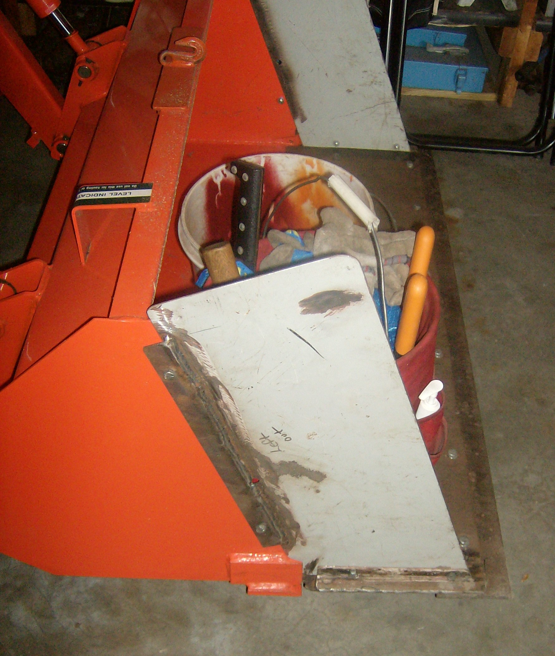

After pricing new high capacity buckets, the bucket extension made by BXpanded, and looking at used buckets that I could modify to fit my tractor, here is what I have come up with. I built my own bucket extension. The extension is simply thee pieces of steel that bolt together and into the bucket. It removes in minutes and stores flat. I am able to heap the bucket very full with woodchips now. Probably three of four times more that just the regular Kubota bucket. Best of all this was completely free, I only have to spend one evening to build it. I just need to stop using it long enough so that I can paint it to match the tractor. For those that do not want to or have the ability to fabricate something like this but still want more capacity, check out the BXpanded website. They have a nice bucket extending that is not quite as large as mine, but installs in moments and is not too expensive.

/ Kubota LA304 Bucket #7
Hey! You can't beat free. I would much rather be looking at someone's simple home-spun solution then what you can buy with a large stack of money. It looks sooooo pretty too, because it is functional.
/ Kubota LA304 Bucket #8
That turned out great. No need to buy something if you've got welding skills.
Give it a couple of months, and I'm sure you'll eventually paint it orange. That's what happens whenever I make something up for my tractor. :D
/ Kubota LA304 Bucket #9
Very Nice!!! The best part is it's built exactly to your spec's!!!

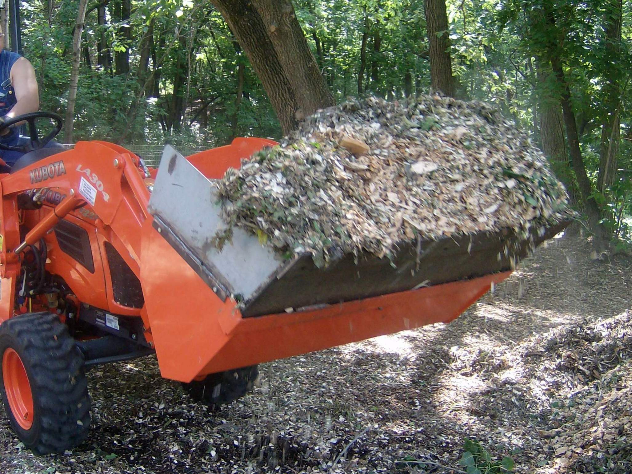

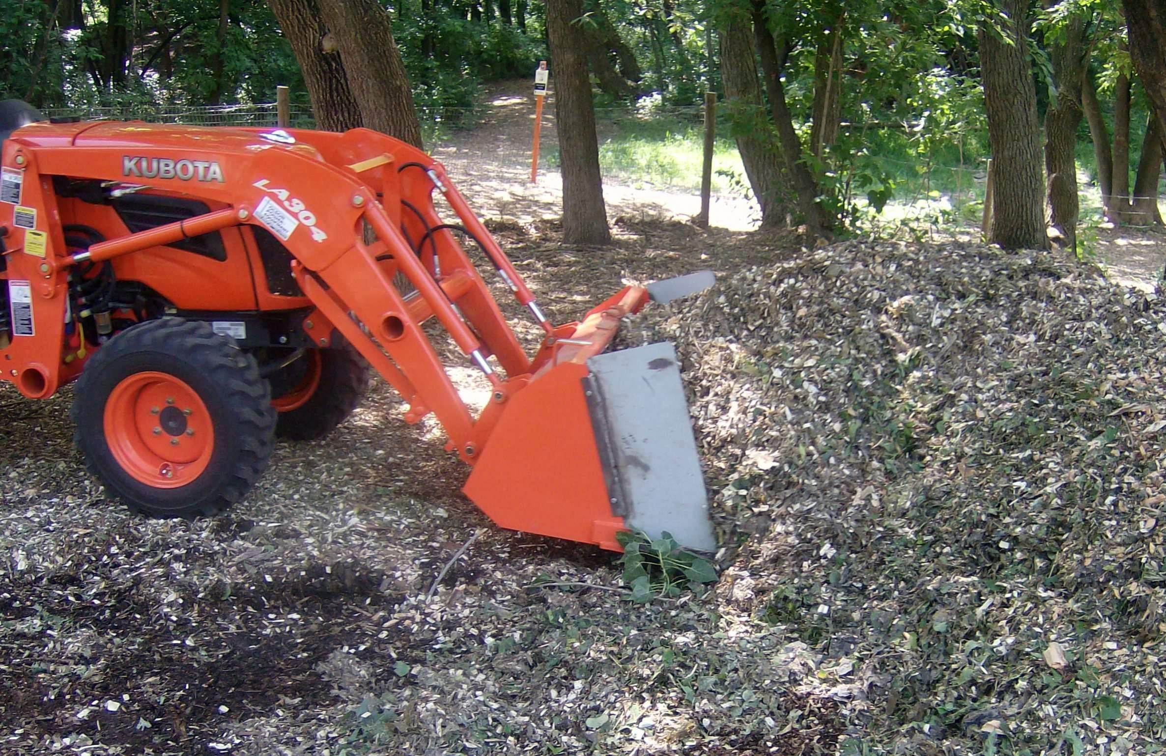

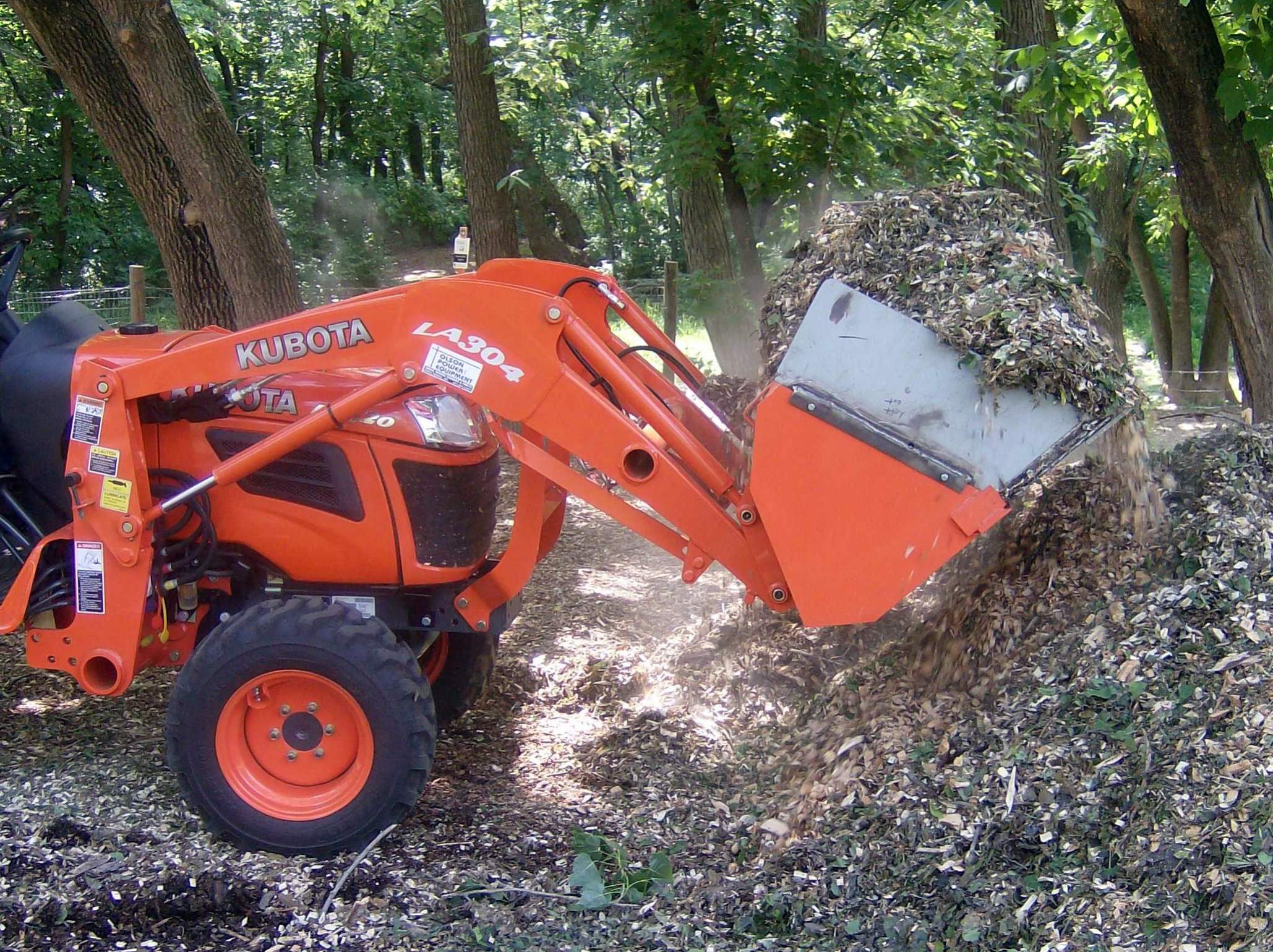

Here are some pictures of the bucket extender in action spreading wood chips at the dog park. It easily doubles if not triples bucket capacity with light materials like wood chips.

/ Kubota LA304 Bucket #11
Wow that really does hold alot! Now you need some orange spray paint!
