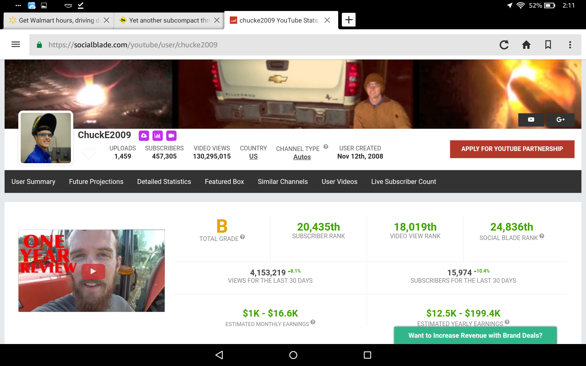

This guy has trouble with everything he buys. He changes something he doesn't think is right and then "butchers" what he thinks is a fix - then criticizes the manufacturer. This guy has trouble thinking things through.
/ Kubota M7060 Cab Tractor ISSUES !!
#9
Mbu,
Chuck has 457,000 subscribers to his channel. Guess your remark is a bit diluted in response. That is a boatload of
Similar "BUTCHERS"
/ Kubota M7060 Cab Tractor ISSUES !! #10
Mbu,
Similar "BUTCHERS"
