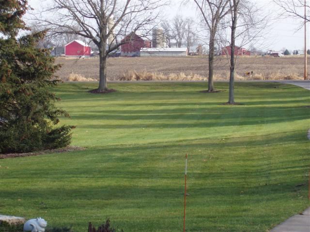

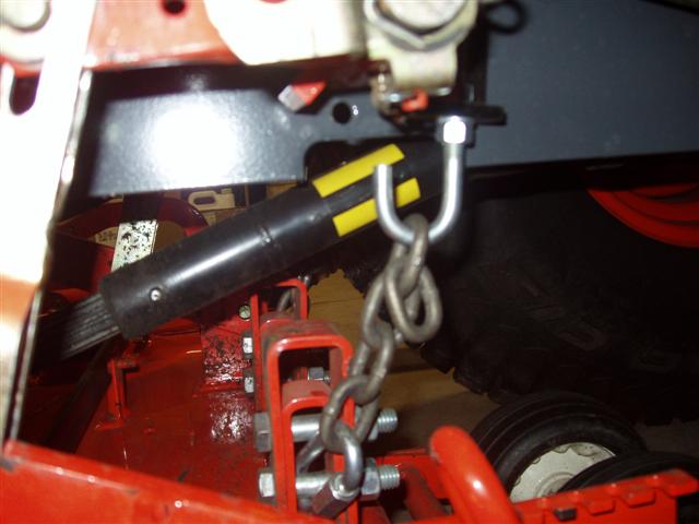

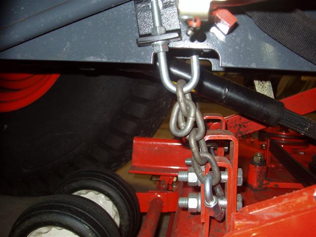

I have a B3030 with a 60" MMM and I did not like the tracks that the two center wheels left in the lawn, either. I made some brackets out of angle iron and bolted them to existing holes in the frame of the tractor. I used j-hooks and chains to carry the rear of the mower. The pictures show how the chains are attached to the mower. The front wheels still carry the front of the mower like normal. It will scalp just a little if the ground is very uneven but I really don't have that problem. To adjust the chains to length I put the tractor on a level concrete slab and lowered the mower until the front wheels just touched. I then adjusted the slack out of the chains. I love the way the mower cuts, now I like the way the cut grass looks, too. I did this in the fall of '05 and used it all of '06. It works well. The last picture is of my front lawn. As you can see there are no center wheel tracks now. Since the pictures were taken, I have completely removed the center wheels and the adjusting mechanism from the mower. It is even easier to remove and install under the tractor now.
