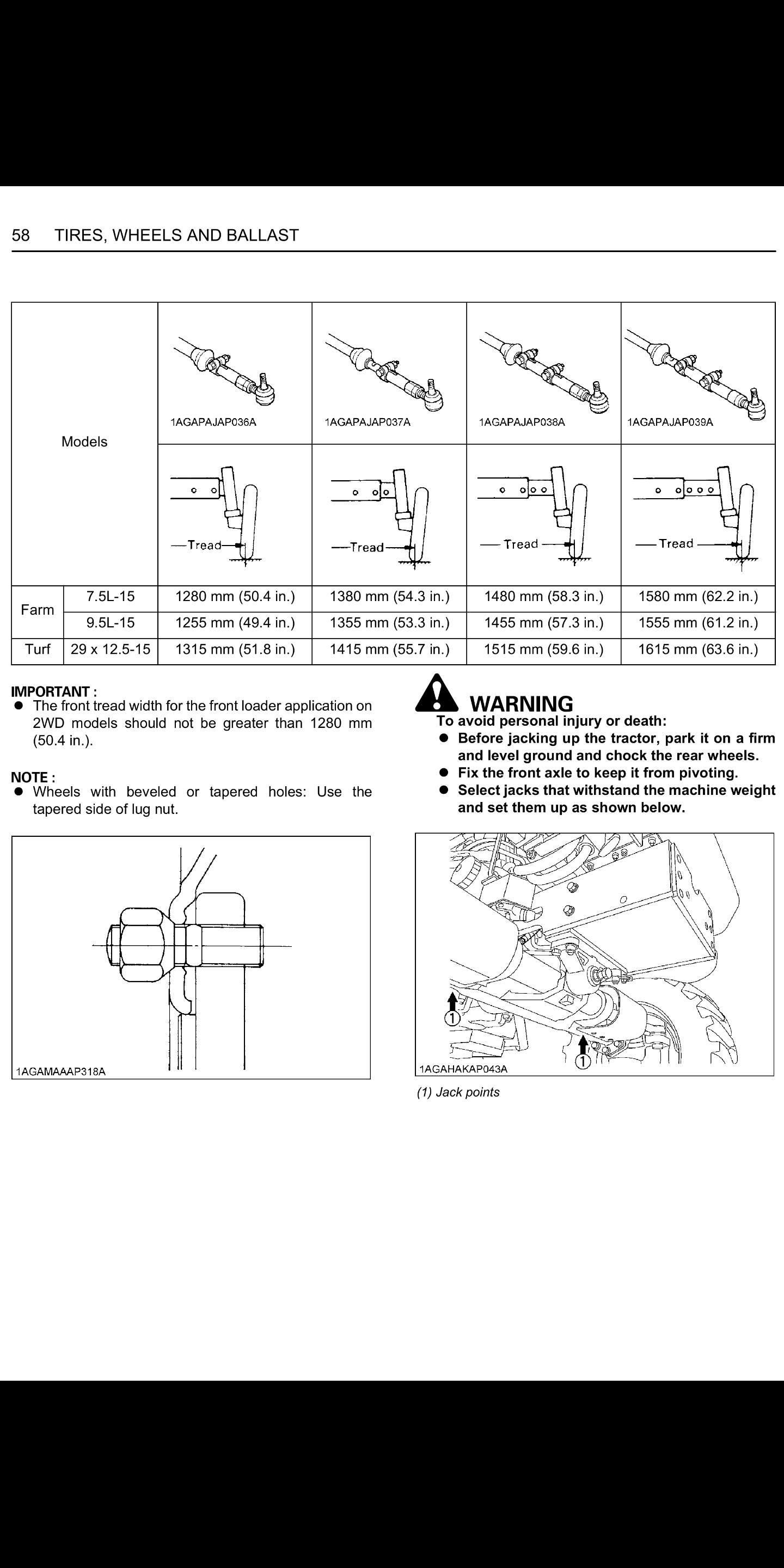

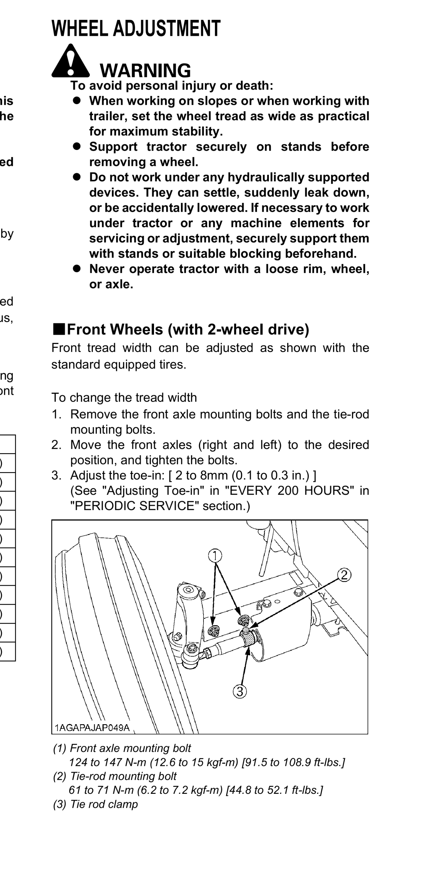

Do the two wheel drive versions of MX tractors front axles permit fairly easy adjustment of front wheel spread?
Like the 2-WD Ford 8N-2N-9N models and Ferguson tractors, or via some other process? Does the front end need to be elevated to change wheel spread?
Thank you for educating me.
   / Kubota MX Series, 2-WD. Does front axle allow adjustment of front wheel spacing? #2
If it's like the previous generation of MXs, yes it allows for the width to be changed easily. I'd have to check my manual, but I recall seeing that they offer a pretty wide range of configurations. Yeah, I think you're gonna have to lift the front to do it though. With the exception of spin out rims on the rear of a few older ag models, I've never seen a way to adjust the width without doing some heavy lifting.
   / Kubota MX Series, 2-WD. Does front axle allow adjustment of front wheel spacing? #3
Alright Jeff, since you're such a stand-up guy I went ahead and downloaded the manual and searched out the info. Here's the adjustment procedure: Screenshot_20180131-125500.png
And the possible configurations:Screenshot_20180131-125702.png

With a hydraulic jack to lift, you're done in 20-30 minutes or less. The MX in 2WD, for the right purpose, is a great tractor.
