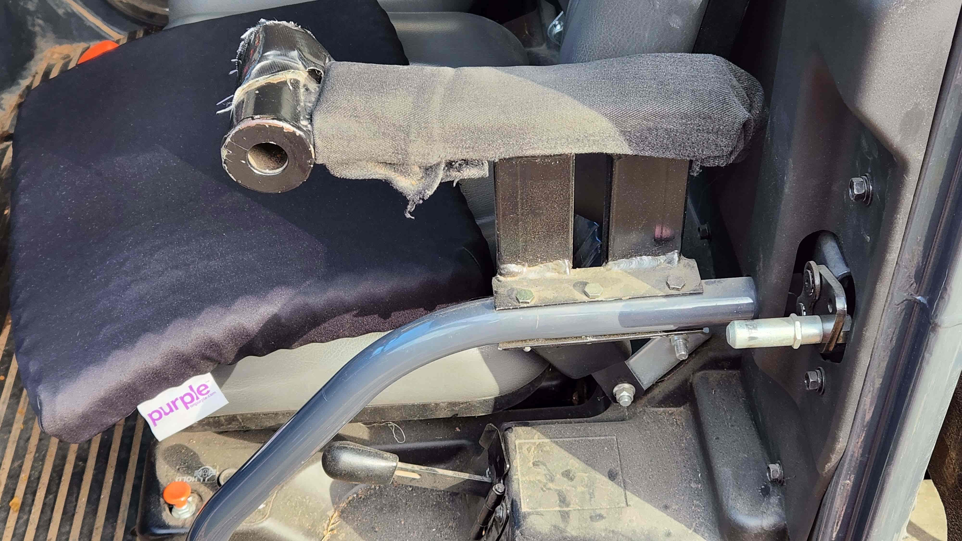

My RTV900 had the plastic roof, glass windshield, plastic bed liner, speedo, under hood storage box, hand throttle, front receiver hitch, and road light kit. I also fabbed up a ROPs grab handle for the driver side like there was for the passenger side. (y)
