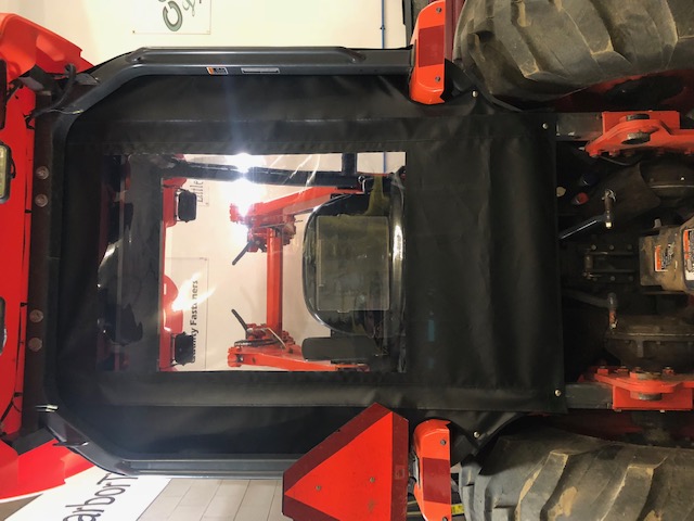

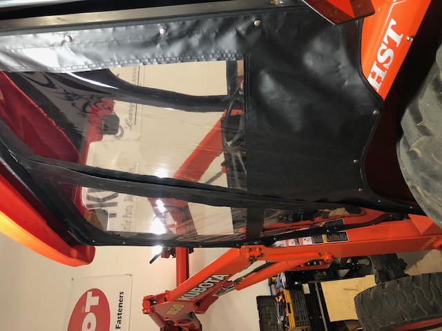

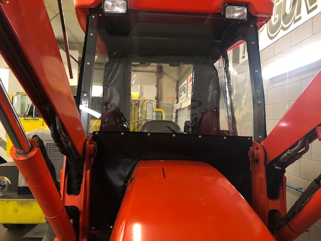

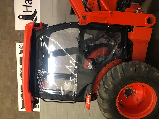

Dropped it off in North Bay Saturday and will pick up Saturday the 20th When i get some pictures I will post.

He just sent me pictures...Looks Good!! Now for heat!
   / Kubota TLB cab project #25
That looks great. Looks better than some of the commercially produced soft cabs.
