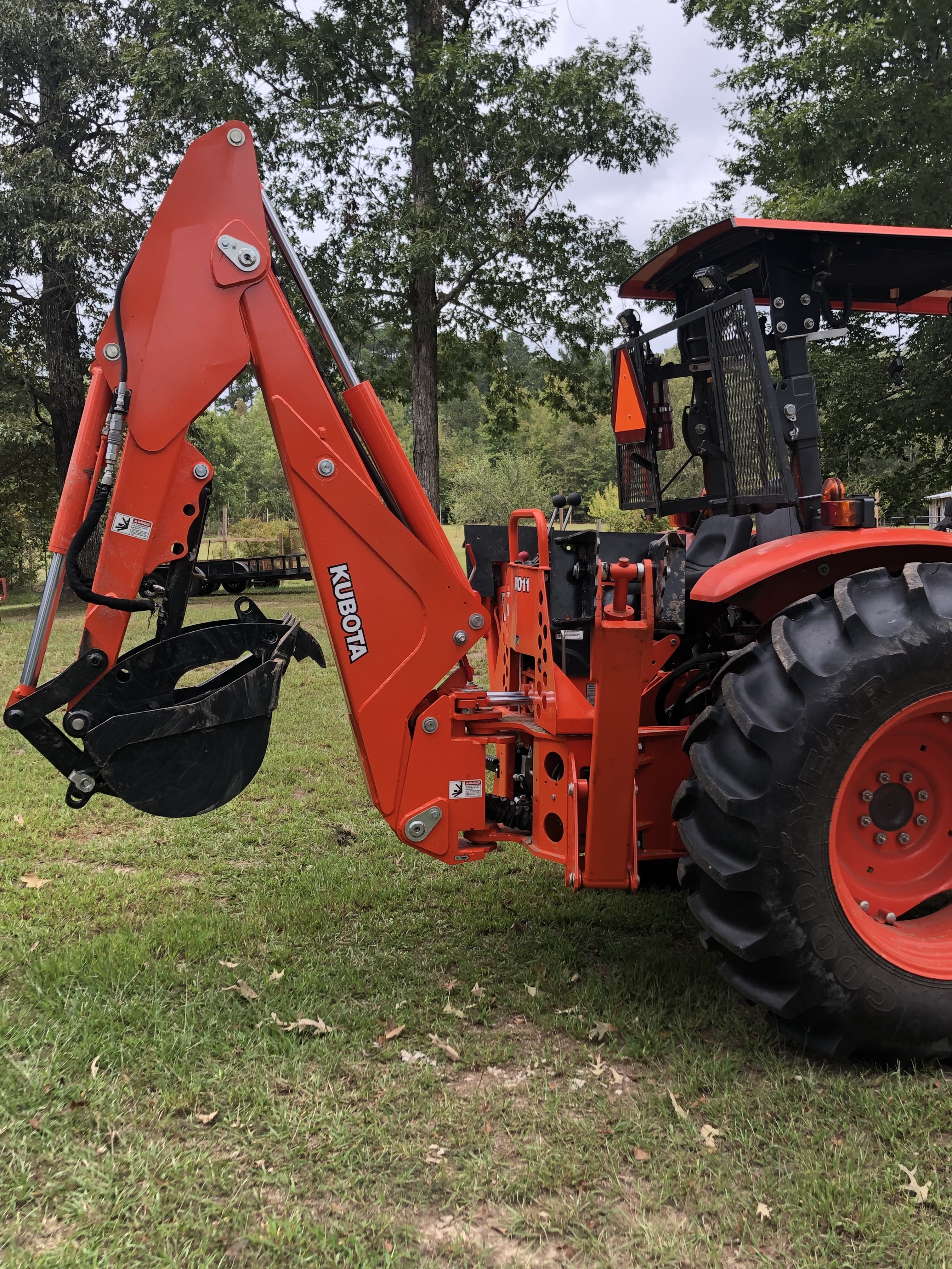

yes there is m4011
   / Kubota utility tractors - available backhoes? #3
That's a nice looking BH Murse - I like the ground clearance and attachment setup looks rugged.
That looks like an open station machine? We're interested in the cab machines.

   / Kubota utility tractors - available backhoes? #8
Those are nice hoes, thats a Bradco 611B rebadged for Kubota. I have the earlier version on my L3240 and it does a very nice job, I'm sure it's even better on a heavier tractor.
Care to substantiate that? Reason I say that is I work at a Kubota dealer part time and all of our BH attachements are coming out of Kubota in Georgia. Never seen any Bradco labelling on any of them, anywhere.
