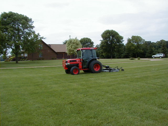

In response to your question, I would have to say definitely YES. I have an L3430 with factory cab and think the cab is the absolute best part of the tractor. It's finally snowing up here in Minnesota and I can't wait to get out and blow and move snow in the comfort of my heated cab.
As far as mowing, my rig provides air conditioned comfort in the summer. The cab is great.

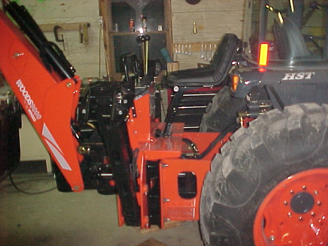

I have a L 5030 cab model with a Woods 9000 BH. You will see the 3 1/2" black spacers used to get to hoe away from the tractor (rear window).
