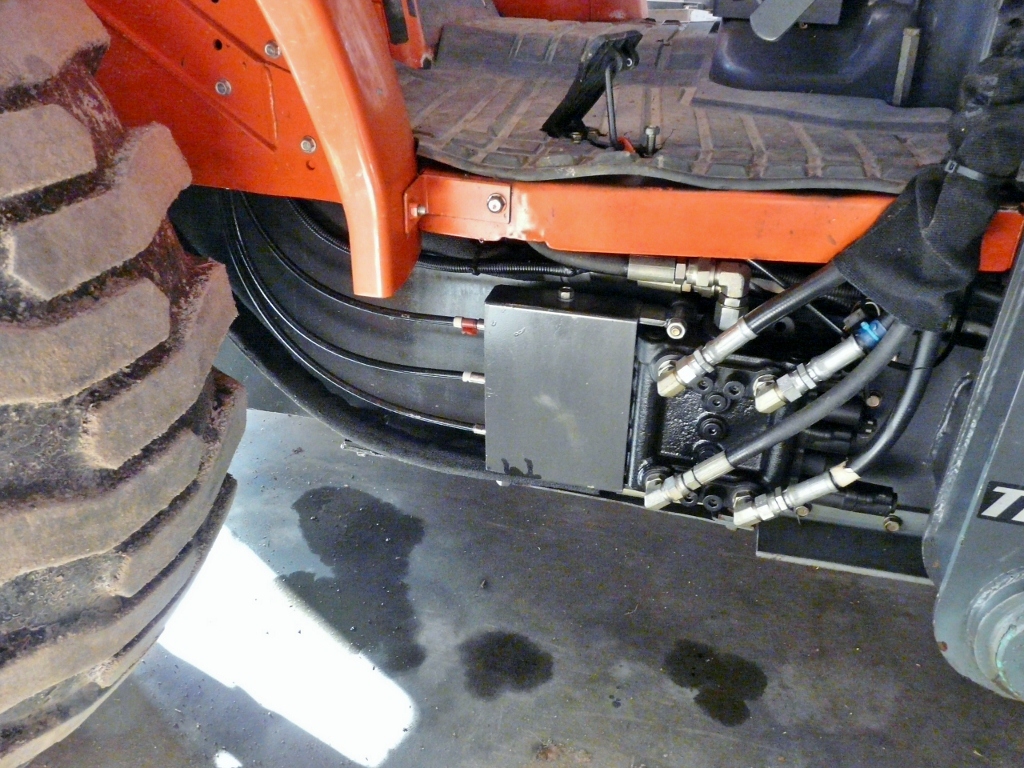

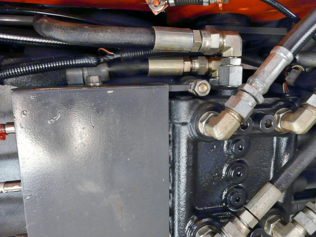

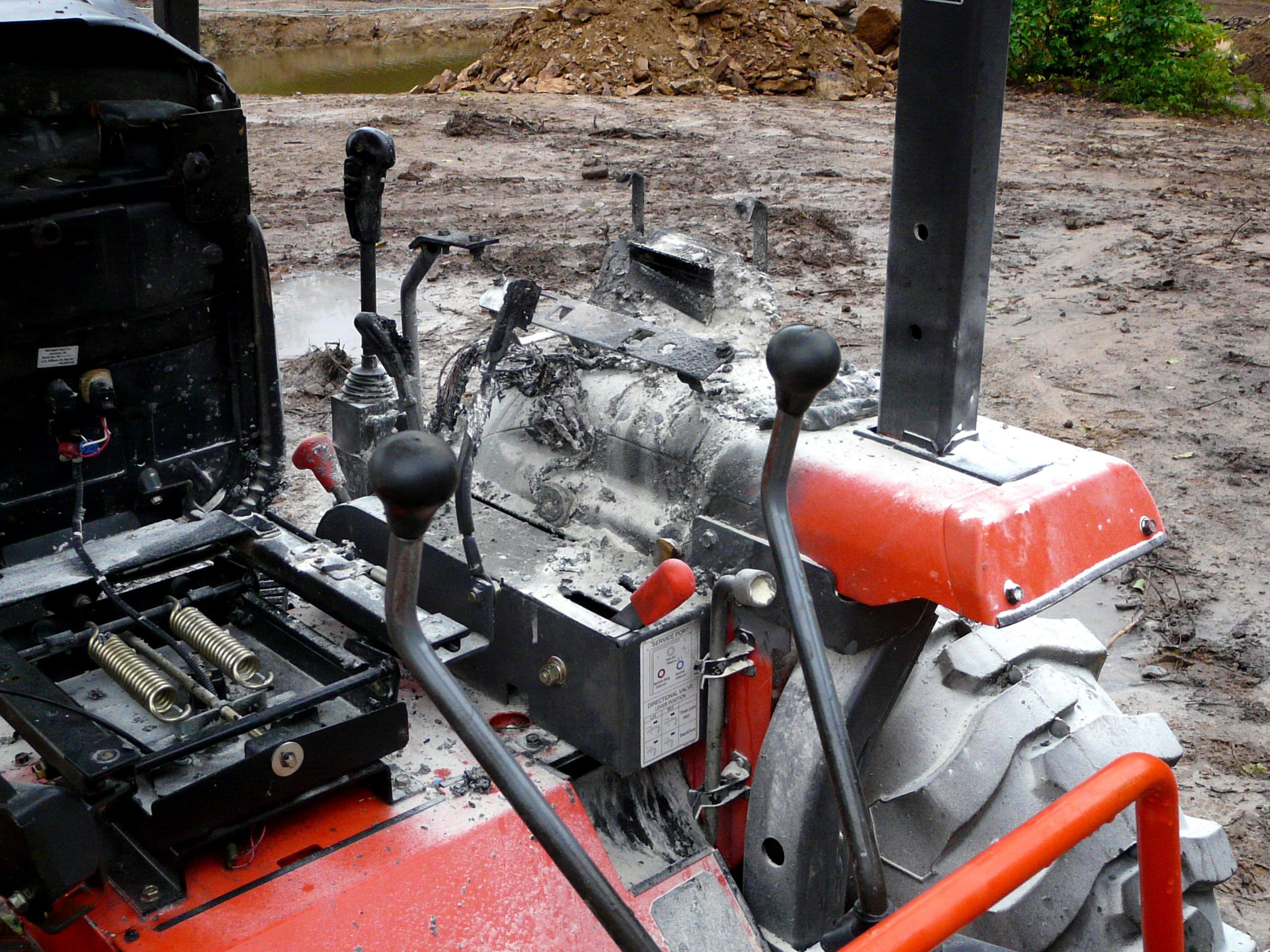

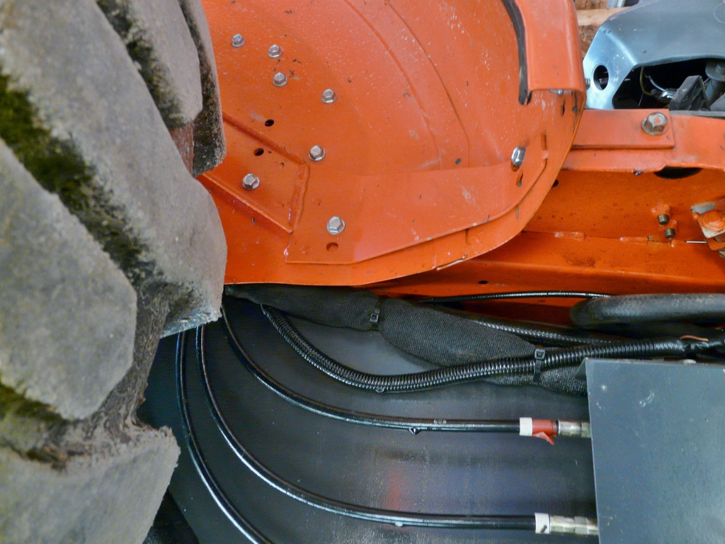

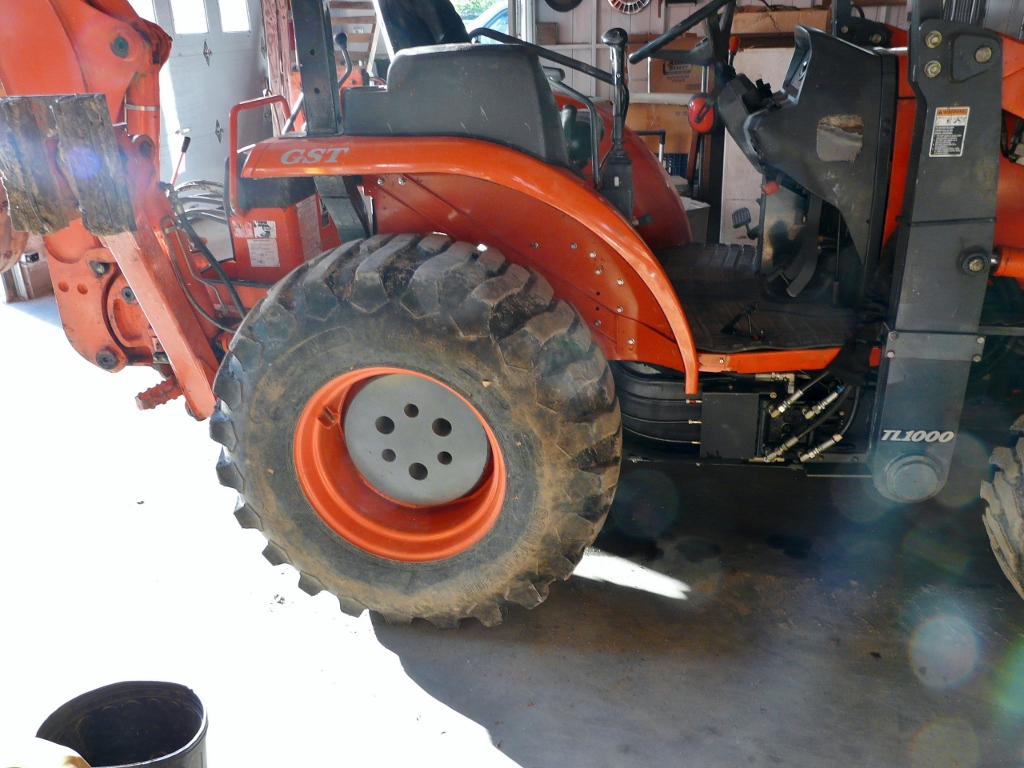

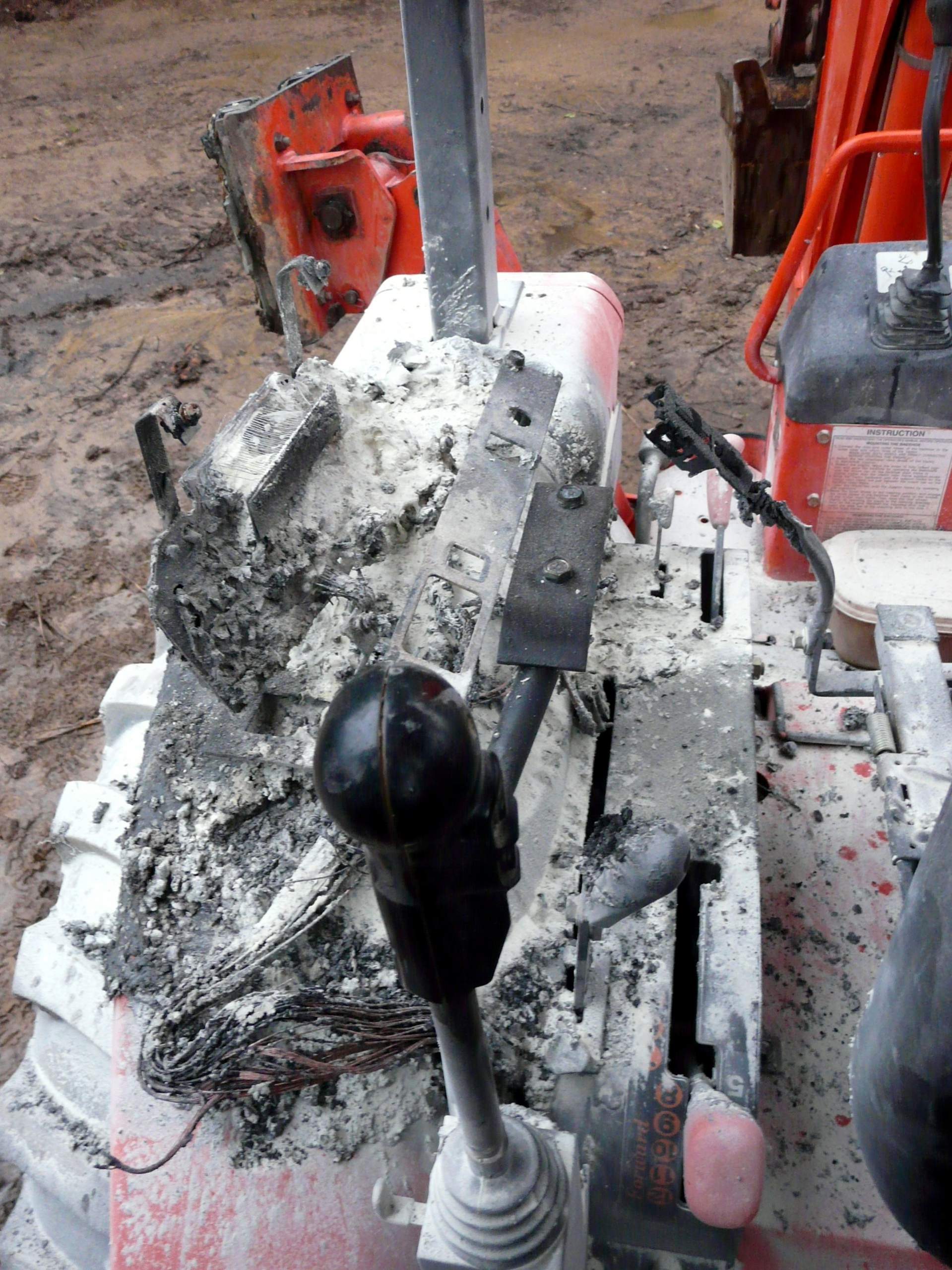

Anyone ever change the Hydraulic hose from the pump block to BT100 Back hoe. My leak id a fairly large and seeems to originate just in fromt of the rear tire from the hose that behind the inner fender but outside the sub frame.
Very hard to see.

I guess I have to do this repair myself.. I called the dealer and they can get to it in "a few weeks, maybe", no sooner. My guess it is the upper hose going yo the rear off the top of the control valve, i.e the hose most recessed.

shouldn't be hard to do, if its a long hose tie a rope on one end so you have a way to pull new one in

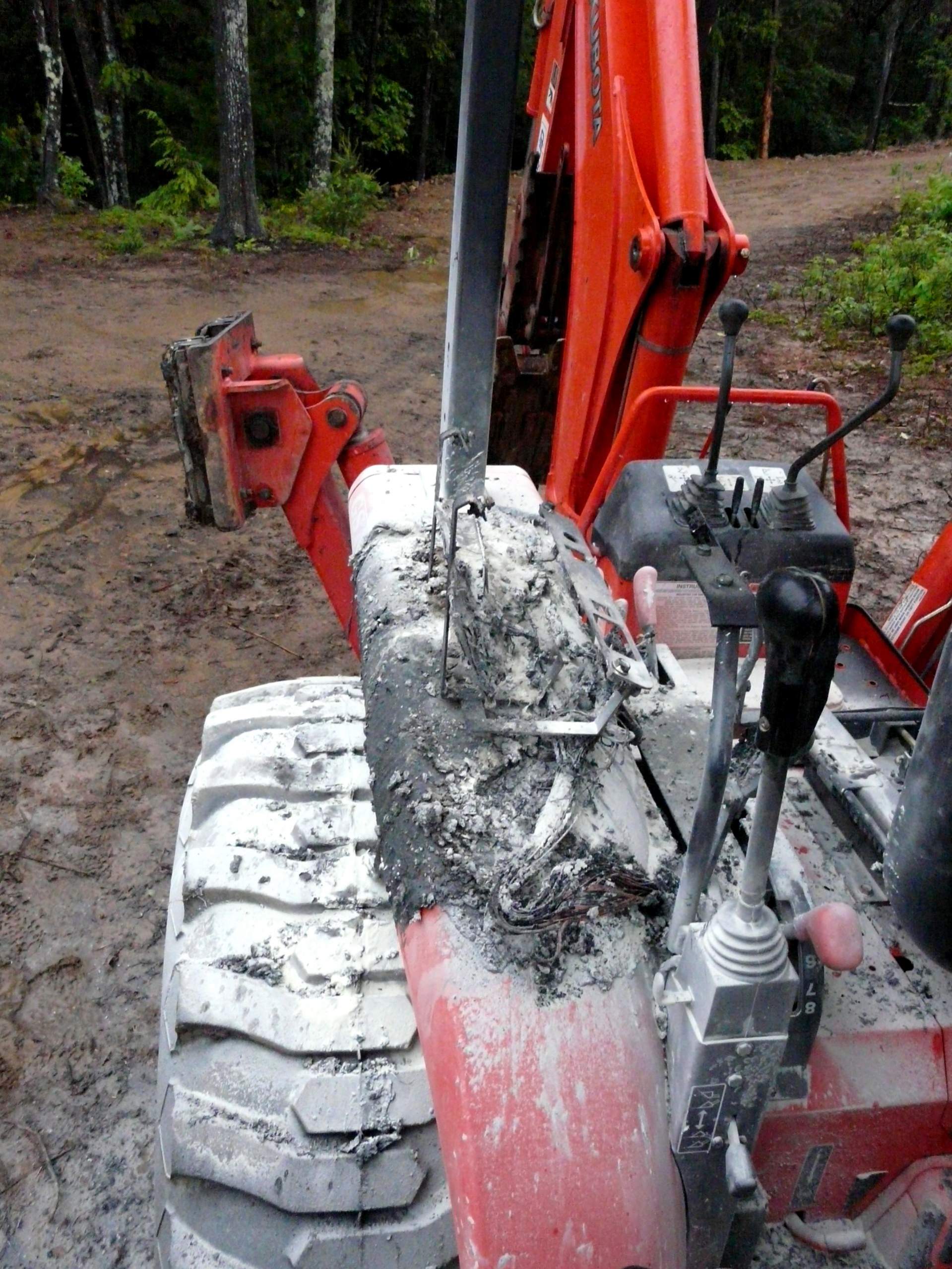

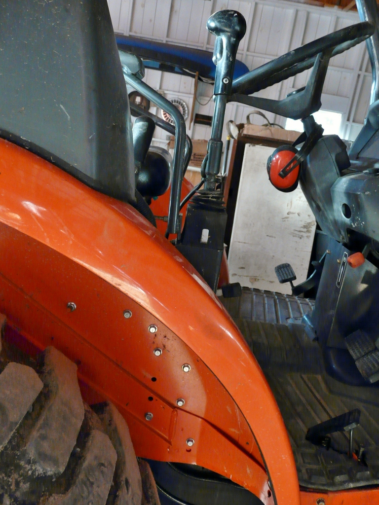

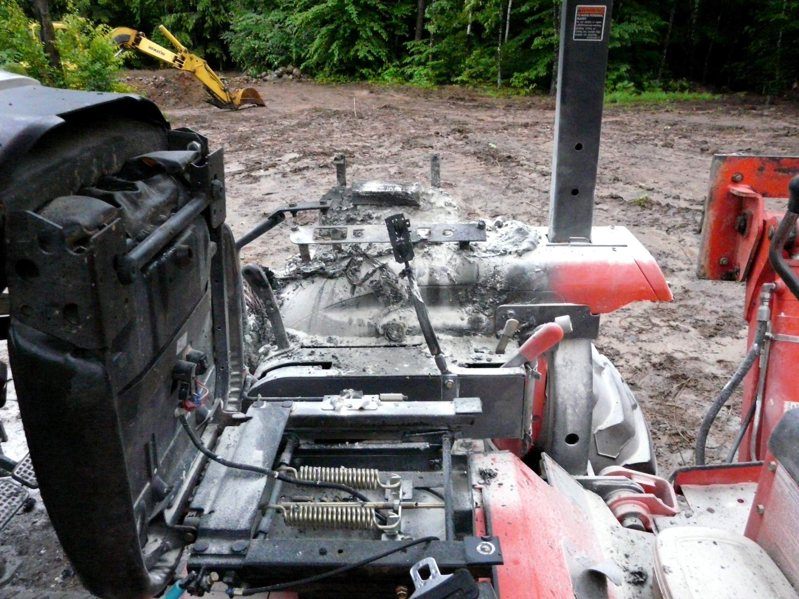

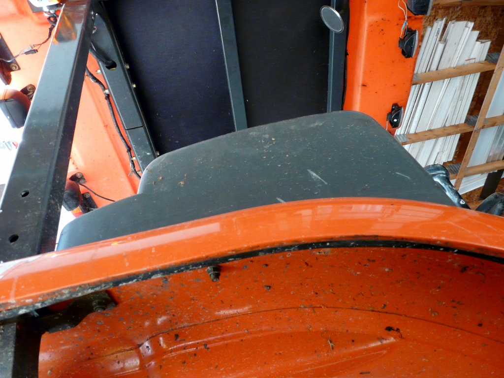

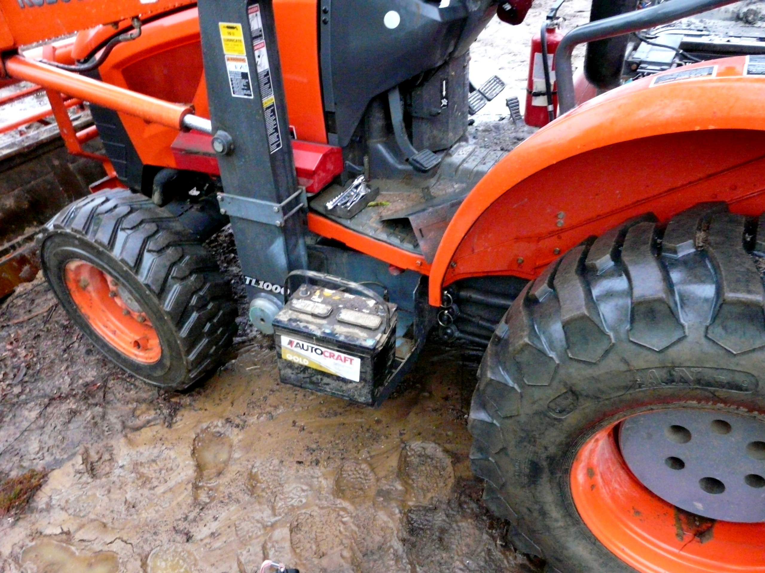

Got the fender off
Result is hose damage from 2012 fire that dealer negelected to replace a medium rare cooked hose. Thats' what you get for a $6,000 repair bill! Wonder if they will warrantee it?? (Sure) Moral of story fix it yourself, so only person to blame is you.
