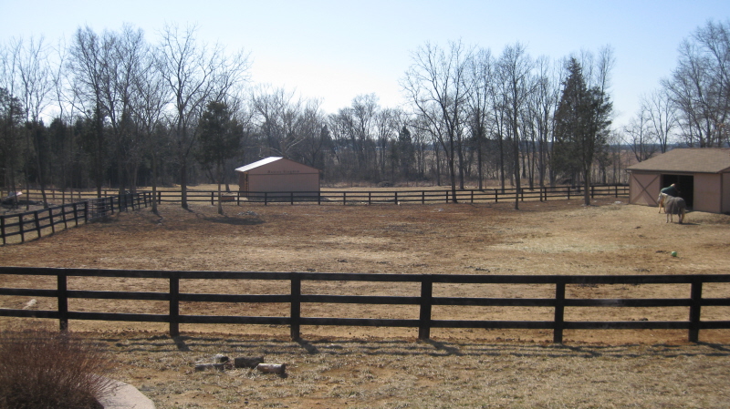

I have a few pictures of how it looks now:

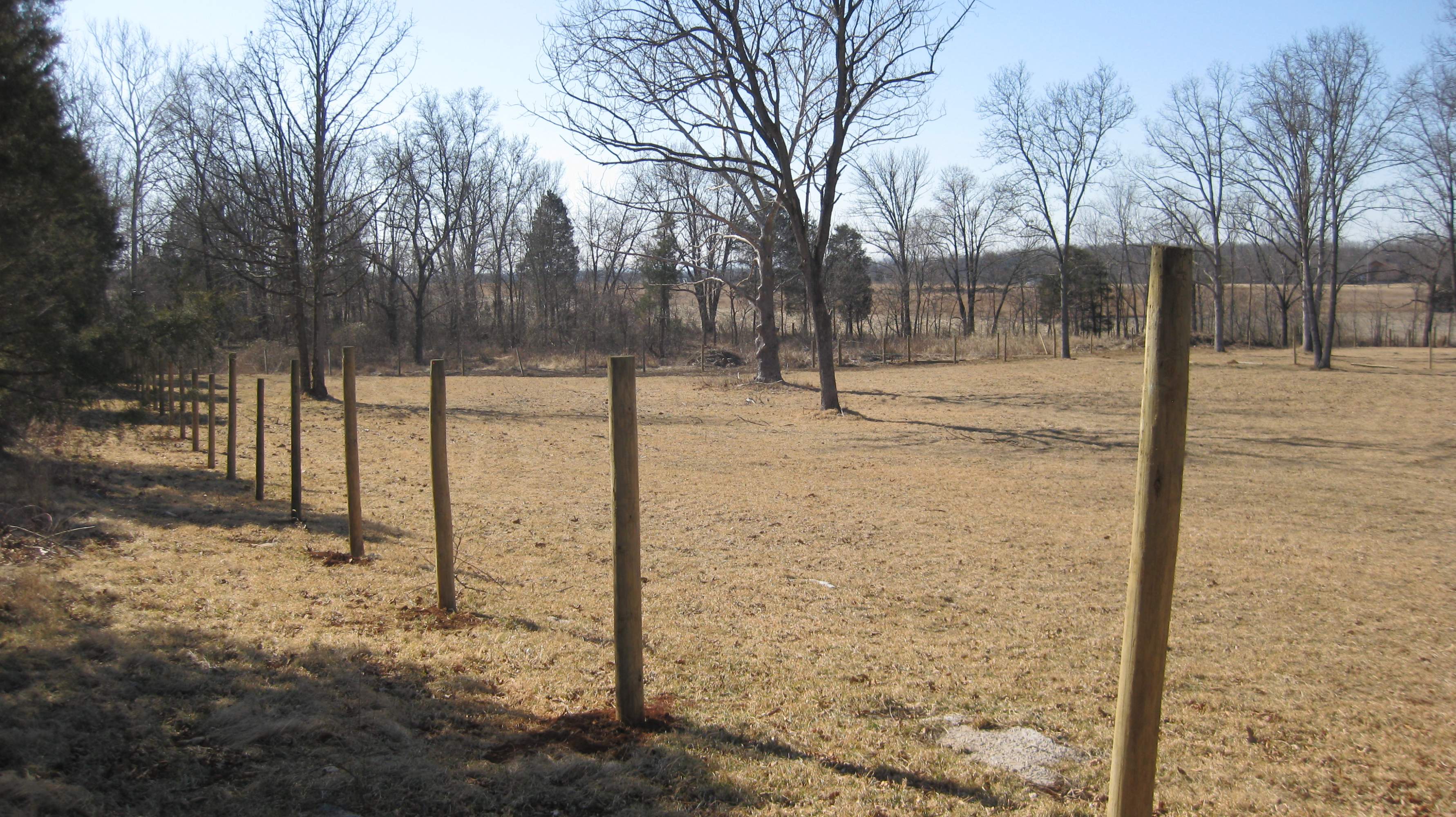

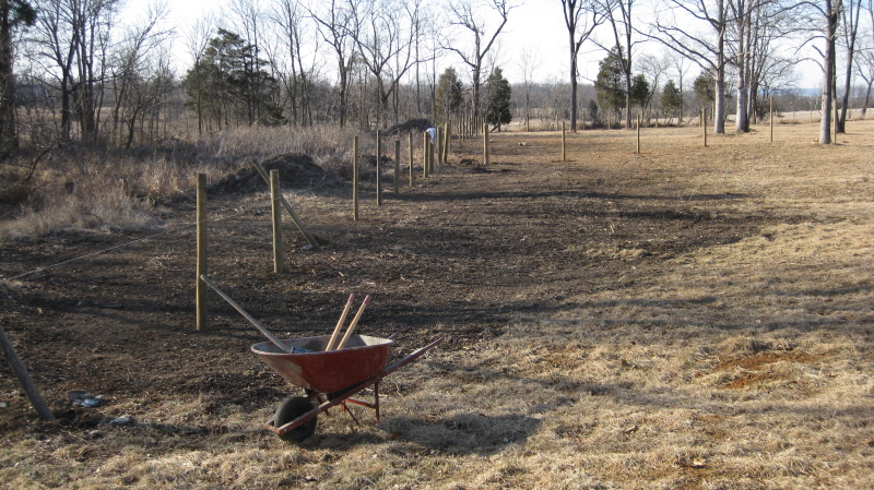

So far I have planted 100 5 inch posts and 25 8 inch posts and used 55 bags of concrete (lots of rock making post holes difficult in spots). I have another 6 posts to secure with concrete, and then I will start to build out the corners (horizontal braces, diagonal (sp) braces set in concrete), and then,finally, I will be able to start to string the fence.
After my bota and I finish this job, I have promised her a complete fluid change (600 hour service).
I will post a few more once I get the corners built and then, hopefully, as I finish this job.

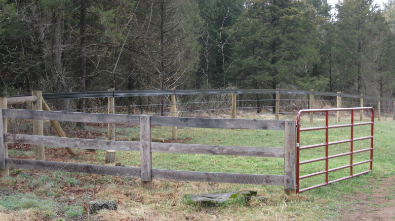

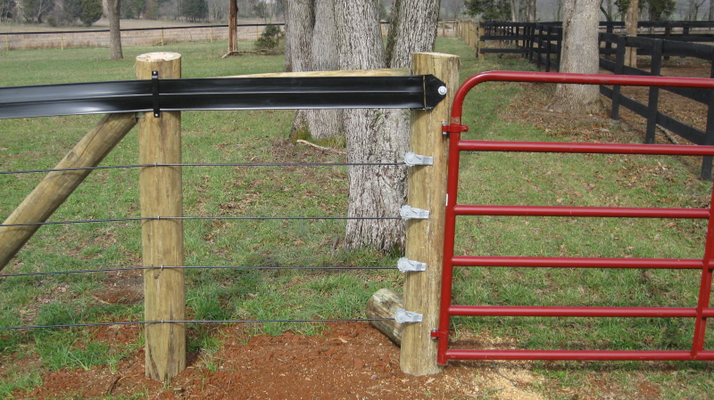

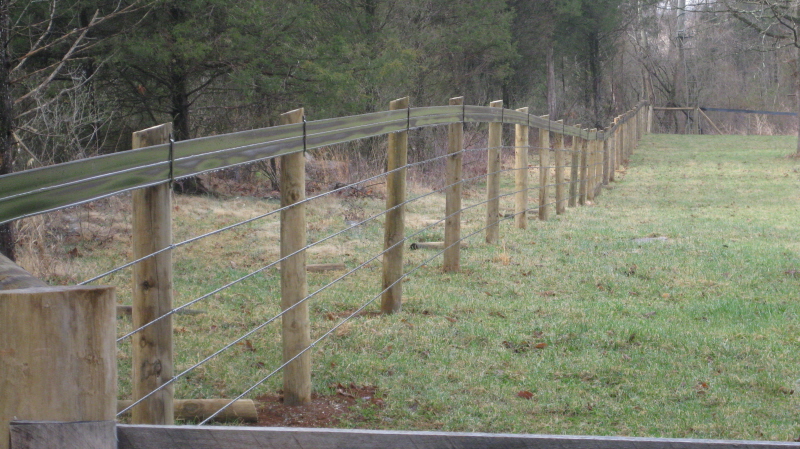

I finished my fence install last weekend, and so my 1 year project to convert 3 acres of brush and trees into a horse pasture is complete.
As the pictures show, I used Ramm fence with a 5.25 inch top rail and 4 coated wires below. The project used 1300 feet of 5.25 inch rail, 5200 feet of coated wire, 121 4-5 inch treated posts, 22 7-8 inch treated posts and 80 80-lb bags of concrete (each corner has 640 lbs of concrete, and about 15 posts are set in concrete because rocks prevented adequate hole depth).
Stringing the fence took about 28 hours, which includes 14 hours of the neighbor's 16-year old son's time at $8/hour (much better option than having the wife help:)
It may not be a perfect installation, but it should be more than adequate for our horses.

   / Land Clearing and Pasture Project #7
Nice looking fence, do you plan on painting your new post with that black beauty paint to match the other wood fence? Sure is a nice looking contrast against that dark green grass. Enjoy!
