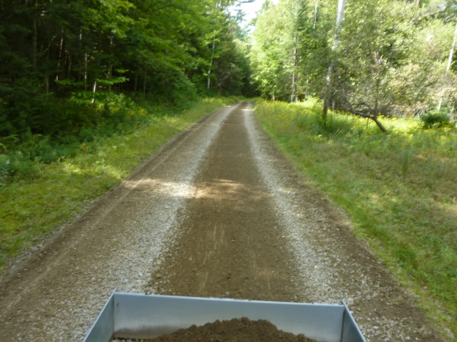

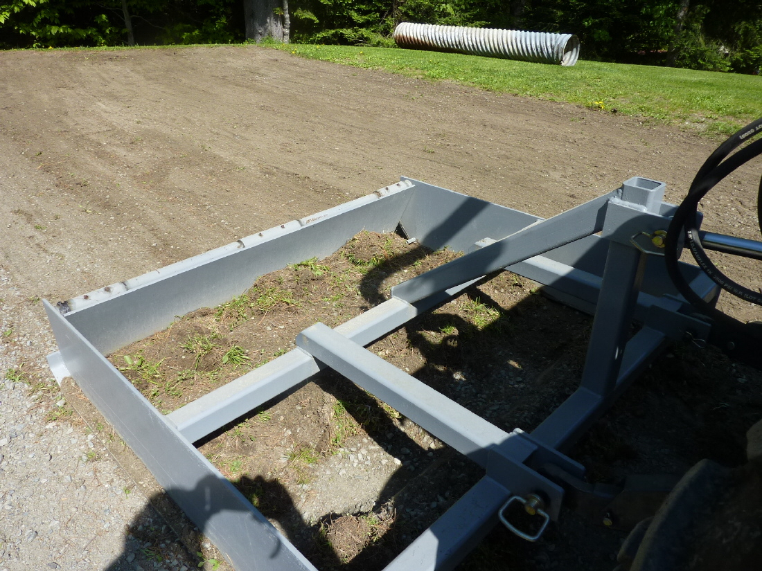

I made mine with a tail gate as an experiment. It hinges on top and there are a set of stop pins on the bottom rear of the side plates. If I hang the tail gate behind the pins it acts as a drag going forward. Does very little.
But it is heavy enough to hold sod and let the dirt pass under it.
So if I am cutting a road edge and the box fills with sod I can lengthen the top link a little to stop cutting new gravel and let the gravel run out then lift the grader to leave a pile of sod. I can then back into the pile to push it off the road. The tail gate acts as a push blade.
If I swing the tail gate up and forward so it hangs in front of the pins it will collect gravel in the box and move it along the road until it drops into a low spot. I control when it cuts with the hydraulic top link - sort of like a box blade but not as aggressive. It works good for evening out fresh bucket spread loose gravel which is humpy. In this picture I am trying to remove a slight crown. I want the road with a flat pitch so it drains left to right. The crown is not easily removed by a land plane alone but you can see the tail gate catches the material in the middle and feathers it out.
The way this one works I would not call a box blade replacement at all but I find it useful while maintaining roads. If I was going to cut a new road I would not get very far with it. That is a job for my box blade.
