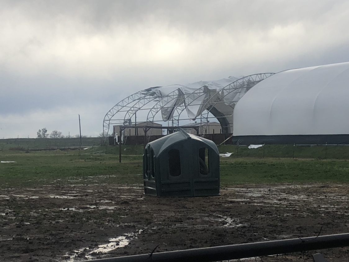

Long story short: 2011: Built a 72x300’ fabric building that is used as an indoor riding arena. My cover is in 3, 100’ sections.
2014: North Texas storm tore the middle cover off. Clearspan made it right.
2019: Storm rips off another cover. This time: they want $20k just to replace 1 cover (not including labor.) Before I bought the building, I was told the cover is approximately 10% of the cost of the building. I paid $110K including shipping, taxes etc. Insurance is covering it, but how many more times is insurance going to cover it?!
The warranty was for 10 years, and has a wind rating if 90mph. Neither weather event reached that. Here is their response:
“Good questions. The warranty unfortunately does not cover any acts of God or weather incidents like wind. The structures are designed to meet minimum 90mph wind but the warranty only covers manufacturers defects.”
Ummm straight line winds less than the rating advertised, isn’t a manufacturing defect? Twice in 8 years! Are my expectations too high here? Am I being unreasonable? Anyone else experience this, and reach an acceptable resolution to this problem?

What broke and allowed the cover to fly up ??
I would be interested in that also,
usually the covers are strong enough if properly secured,
are the tightening straps breaking or is the cover tearing?
Do you have ends on your coverall or is it open on both ends?

How much would it cost to have metal put on the currently broken part? I’d hate to pay over 20k for something that’s proven to last about 5 years.
