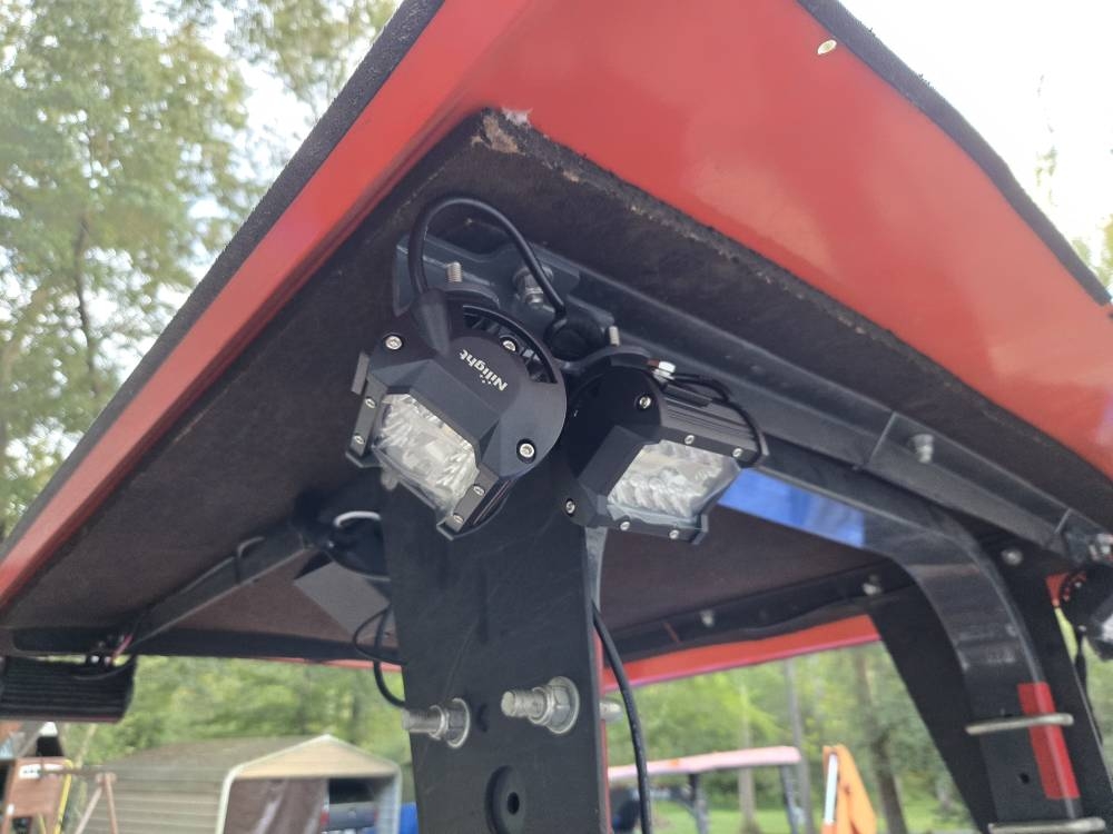

I have the dealer installed cab but not with the added lights so I'm installing them myself. Thanks for the picture. I think I may have ordered similar for the back.
The rear are Nilite's off Amazon, hard to beat for $13 a pair! Fronts are about $16-22 a pair

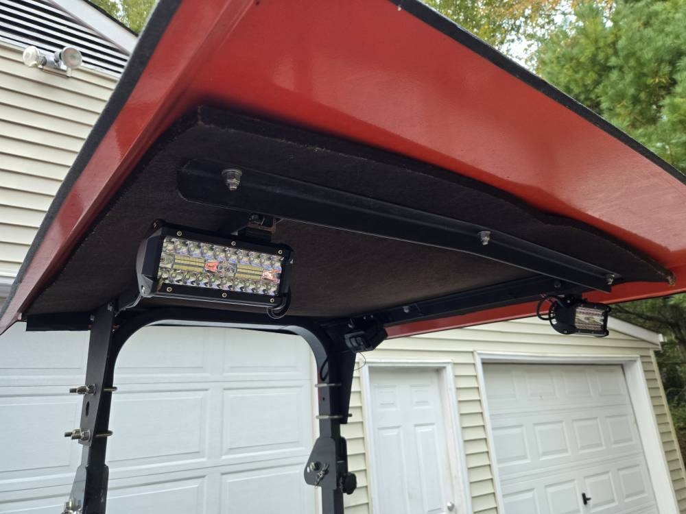

Do you have a canopy? This is what I did on my bx2680 for lighting.
Front:View attachment 4330664
Rear/side:View attachment 4330665 (there is a pair on each side)
Fantastic light coverage! Total load is 8amps measured.
