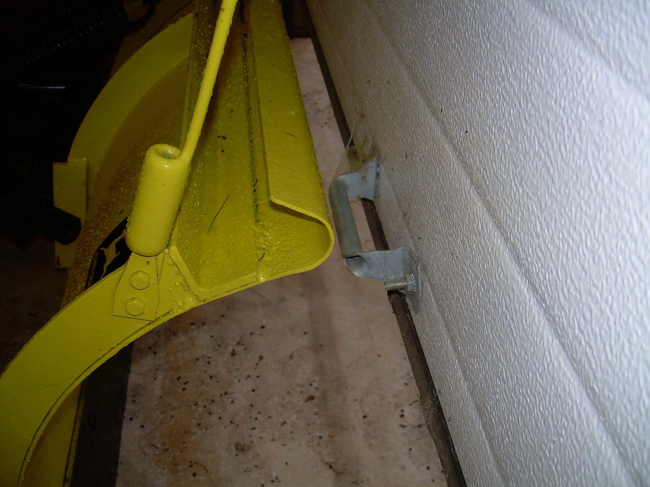

When you say parking length, is it because you are looking to build a place to park it? or to haul it? If it's a barn/building that you are designing, be sure to add four to six feet to the front and back of it so you can get around it. If it's a trailer, you'll be fine hanging off of it a foot or two. Bigger is always better, but there's a price to pay for that, and if you rarely haul it, you might not need to pay extra for a larger trailer.
Eddie
   / Length? #7
Eddie
Word to the wise.
This is how much room I have extra in my tractor shed:( with it backed right up to the back wall.
   / Length?
Thanks everyone. Yes Eddie it is for parking in a building. I saw a pic of a Massey GC 2300 in a 16 foot deep building. It had the fel but nothing on the back, but there looked to be enough room, I just couldn't judge by a picture how much a rear blower would add. I just want a small cheap building to house the tractor and store the mm mower and a tiller. I saw a 16.5x20.5 design that looked about what I want and wasn't sure if it would work. I guess I could always put the door on the other end and have it 20 deep.
