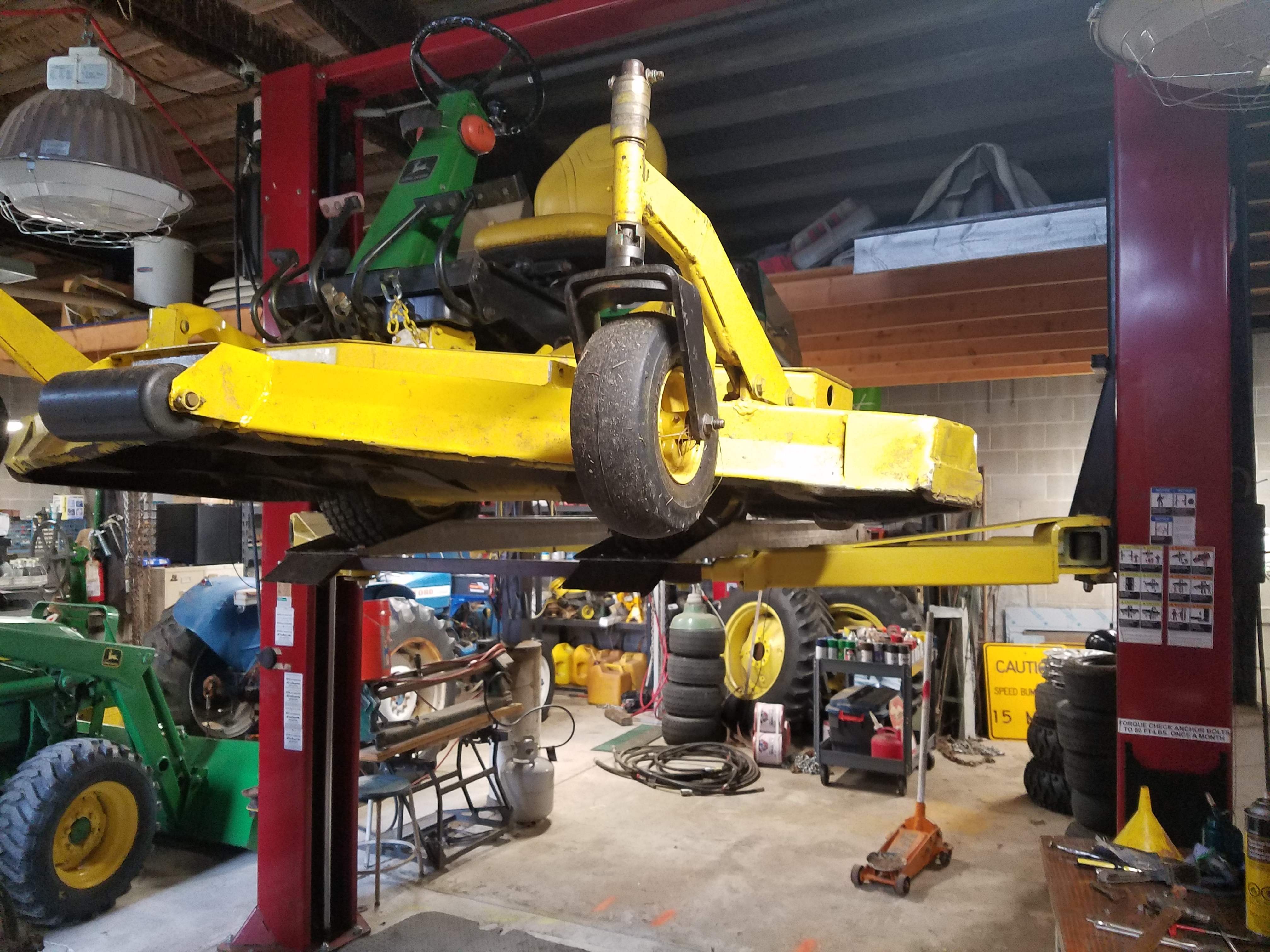

Lift. So many un-anticipated things you can do with a lift other than lifting vehicles. I used the arms to install fluid filled tires onto my tractor which was parked on jack stands, pull a stubborn PTO shaft apart I even store my spare lawnmower on it. Get at least a 10k capacity unit. You do need higher trength flooring to support the loads, but what else is a pit good for ? At least the lift can be raised fully up empty and you have a continuous floor. As for the pit, maybe a hot tub or place to drown chipmunks and squirrels.

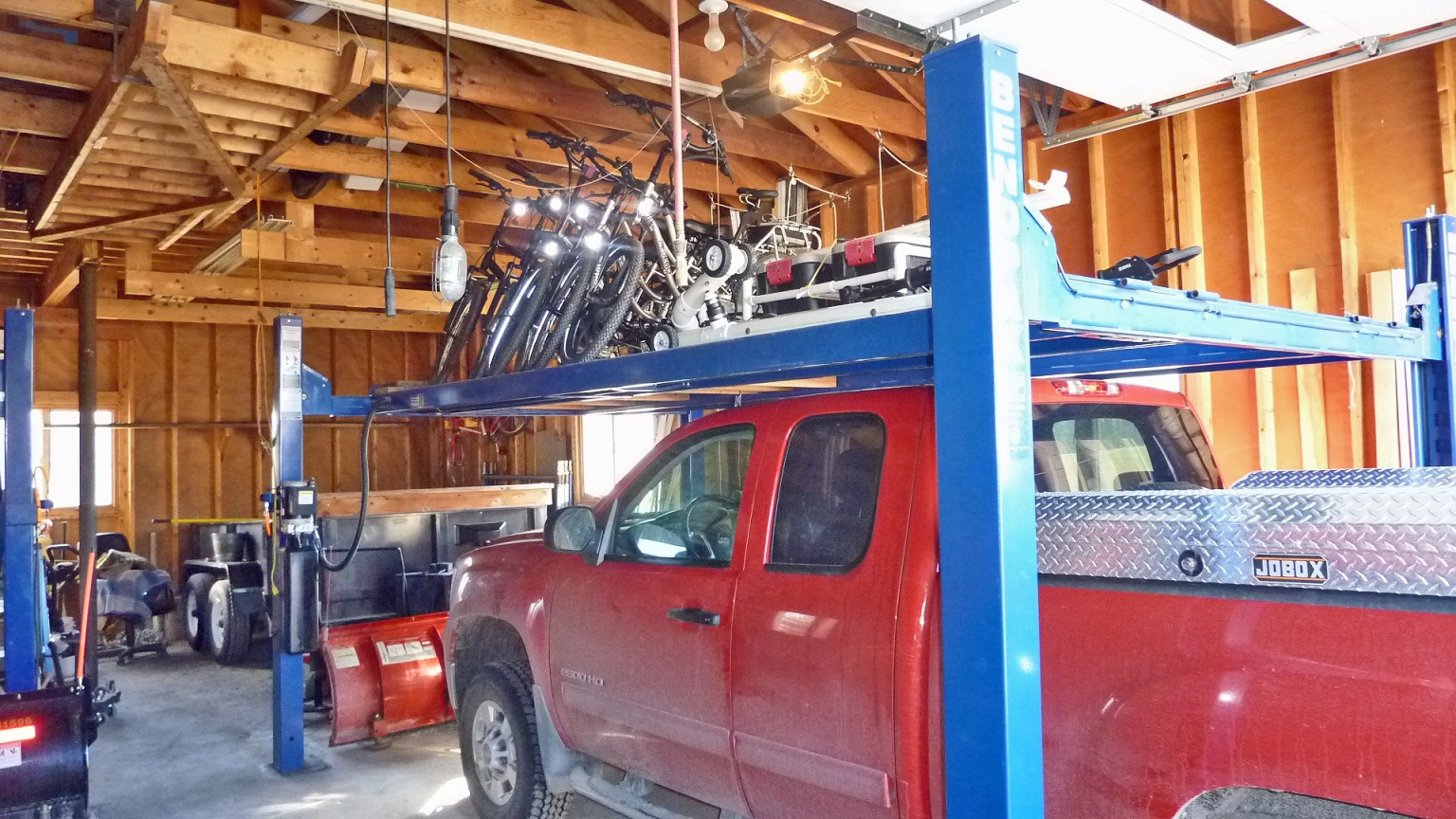

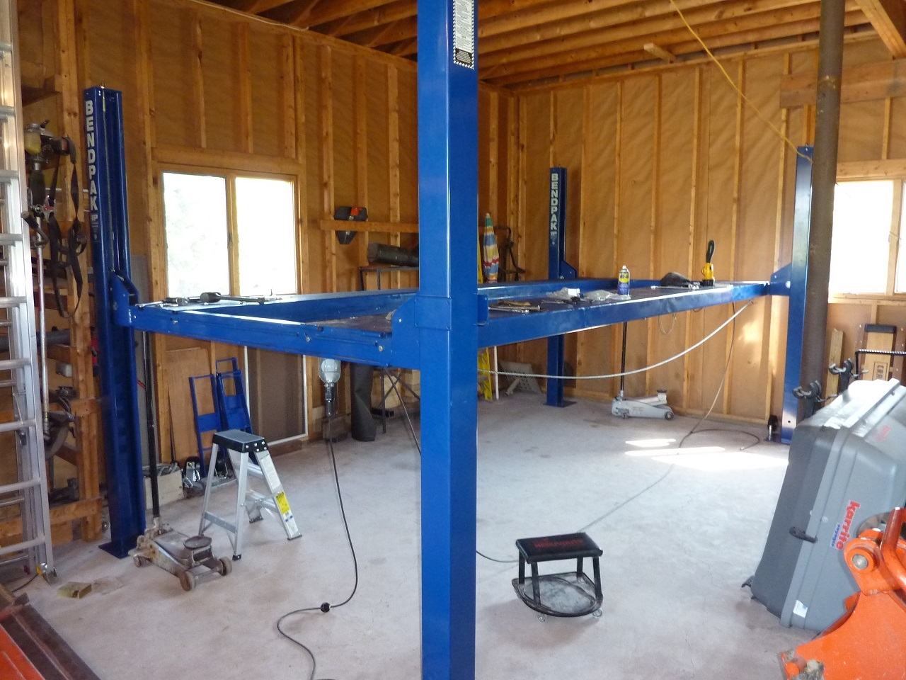

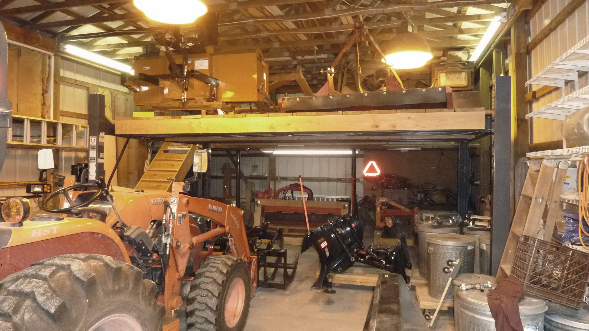

I was not permitted to install one when I built my garage. I chose a 4 post Bendpak lift instead and don't regret the choice.
There are no issues with rear heavy tractors and they are great for storage when not being used.
So much so that I installed one in another building just for that purpose.
