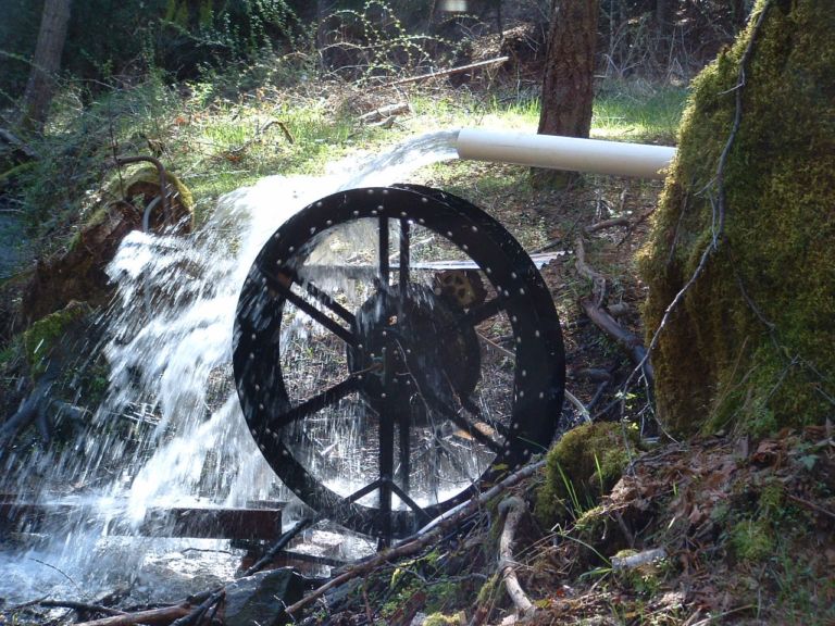

Not to hijack the OP's thread, but I'm at least a couple of years away from actually restoring the dam, but you know I will be sharing pics and discussions on my work as it progresses. The dam was breached some years ago as a result of neglect following some logging and the subsequent skidding of logs over it which stripped away the natural covering that prevented erosion. This allowed the stream to bypass the concrete wall that faced the sand berm that makes up the dam. I am still in the process of clearing all the brush and saplings, which with only a few weeks a year and no mechanical access, is slow going. Interestingly, in researching micro hydro I came across the image below here which if you removed the water wheel and pipe, almost exactly matches in topography the low side of my dam, including the flat area that is adjacent to the stream. By my observations, the water flow in the picture is somewhat less then what I believe my stream consistently produces year round.
