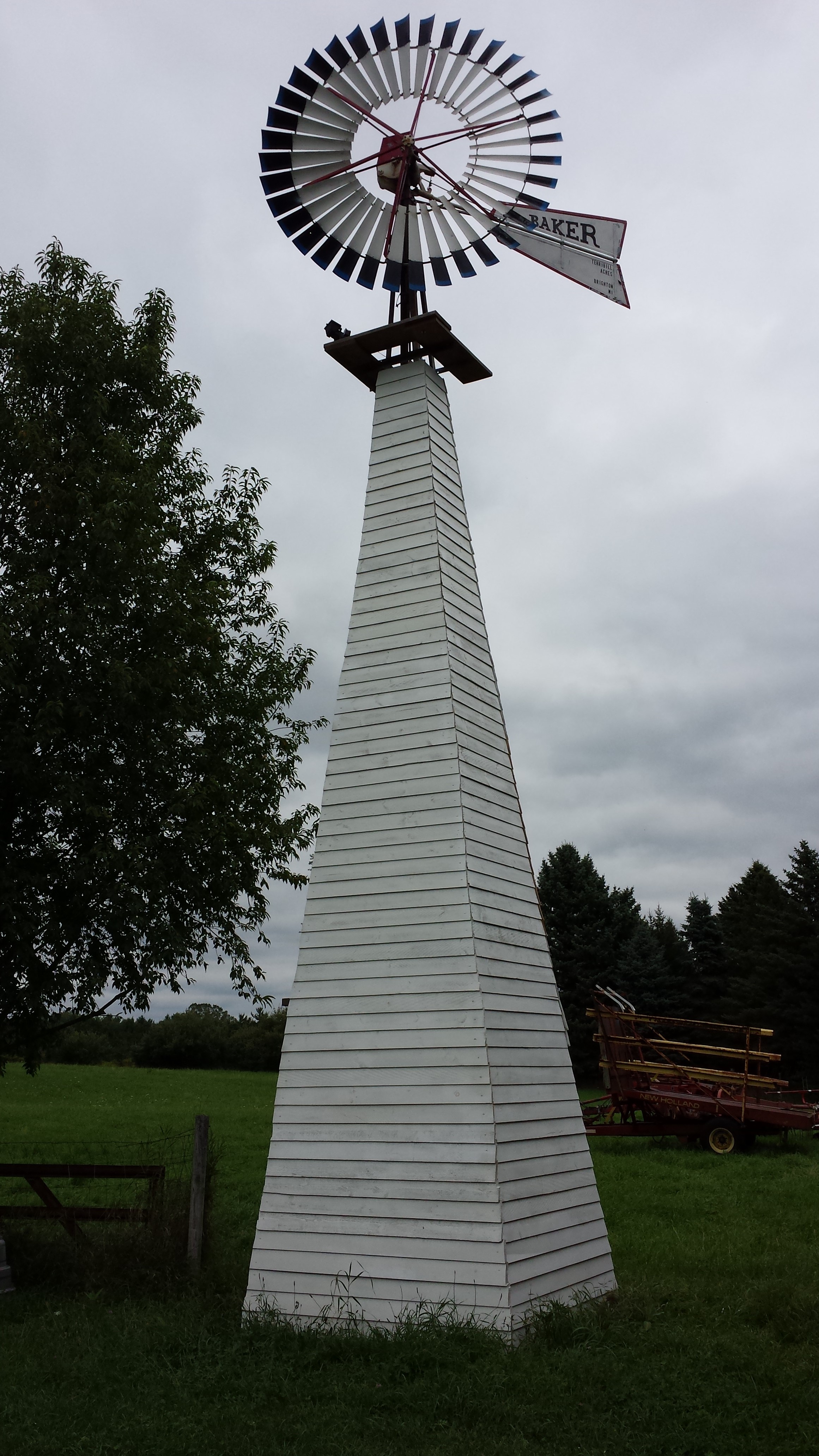

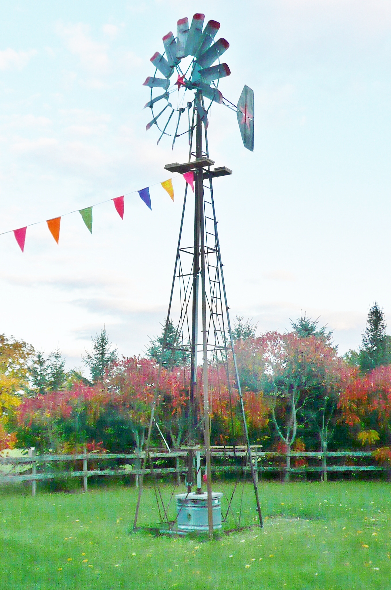

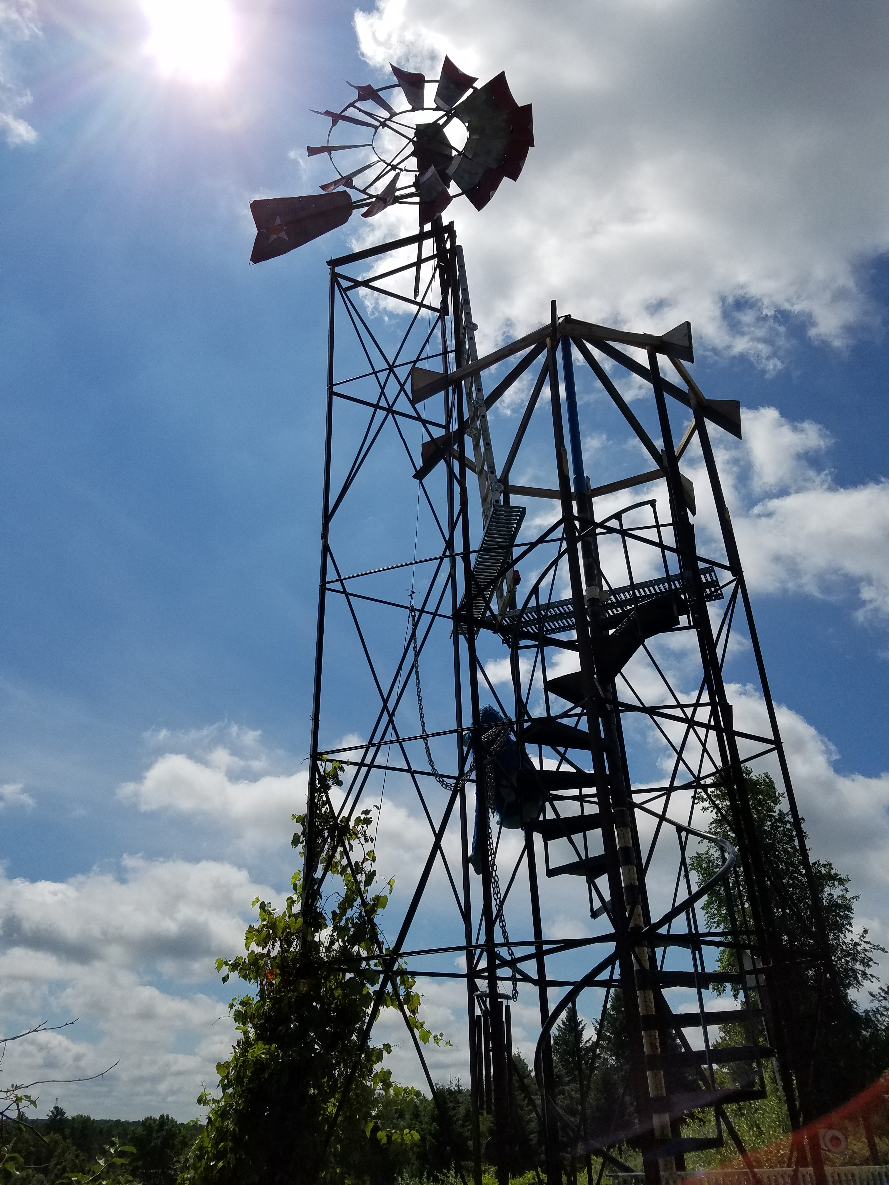

I have a windmill hoarding hobby (old/vintage water pumping style). Since putting up a few (6 around the property), there has been no activity, not even one less than a 5 second count away (about a mile I believe). The towers are apparently slowly bleeding off the charges or accepting the discharges as they build. Heights are 32 - 36 ft for all of them. 20150827_162743.jpg

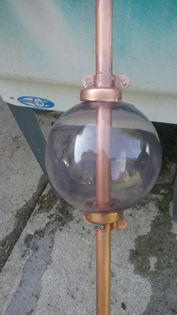

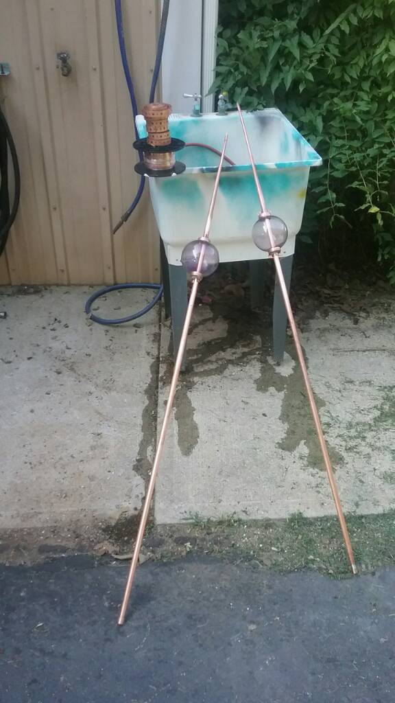

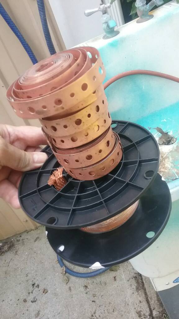

I just made these and will put them up probably tomorrow, one on each chimney. I used 3/4" copper pipe that I cut 18" down each side , then cut and hammered then soldered so they're tapered. I put a 1" x1/4" copper pipe hammered on top to hold together while I soldered. Copper everything, plumber strap to chimneys, braided copper cable.
The 100 year old amethyst balls are off of old lightning rods. I have an 8ft copper driven ground rod near the phone and satellite ground rods.
Hard part is I don't enjoy getting on roofs at my age. I'll probably put my extension ladder in my loader bucket which at least starts me out at 7-8ft.20180617_172600.jpeg20180617_172611.jpeg20180617_172630.jpeg
