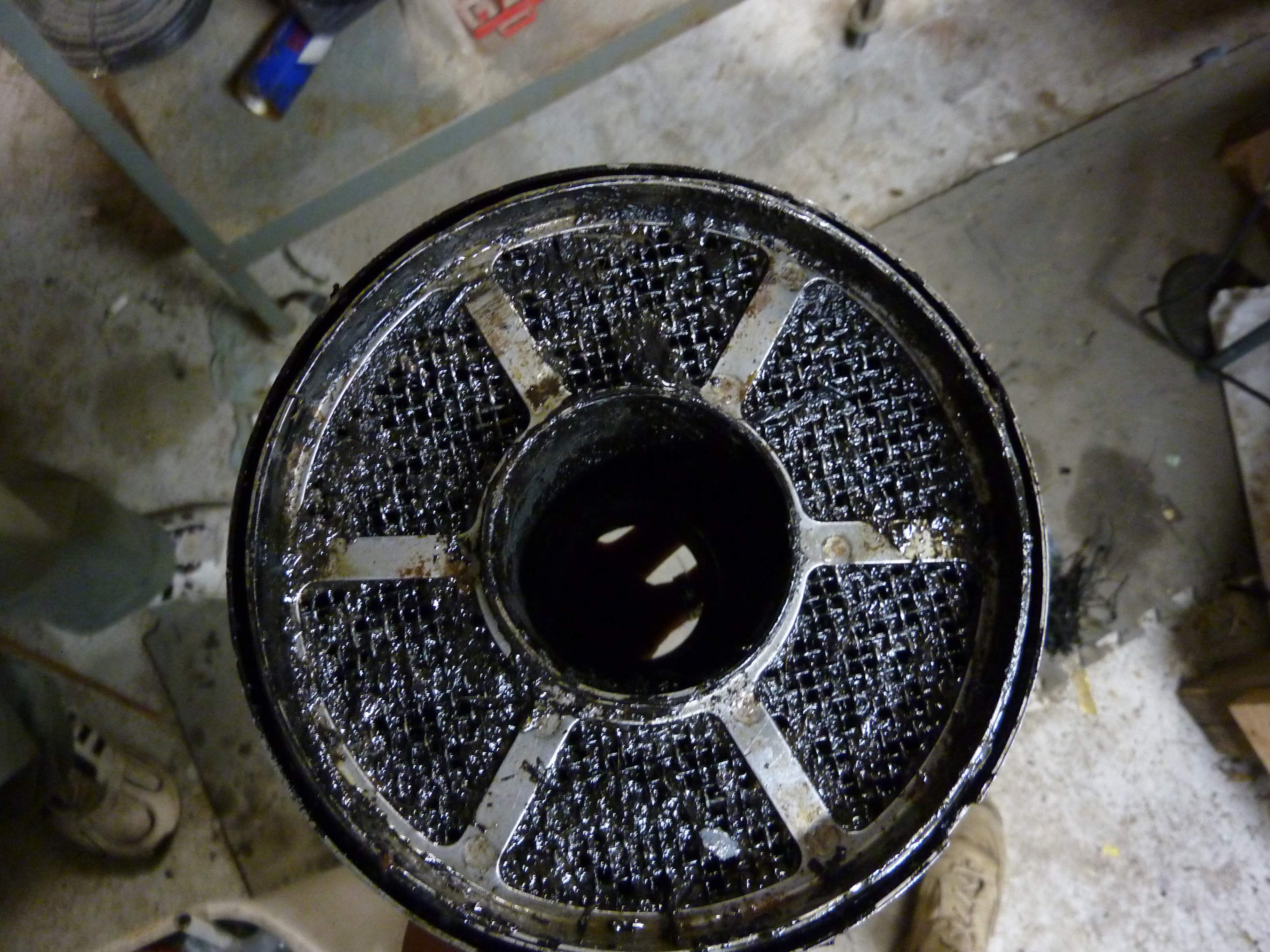

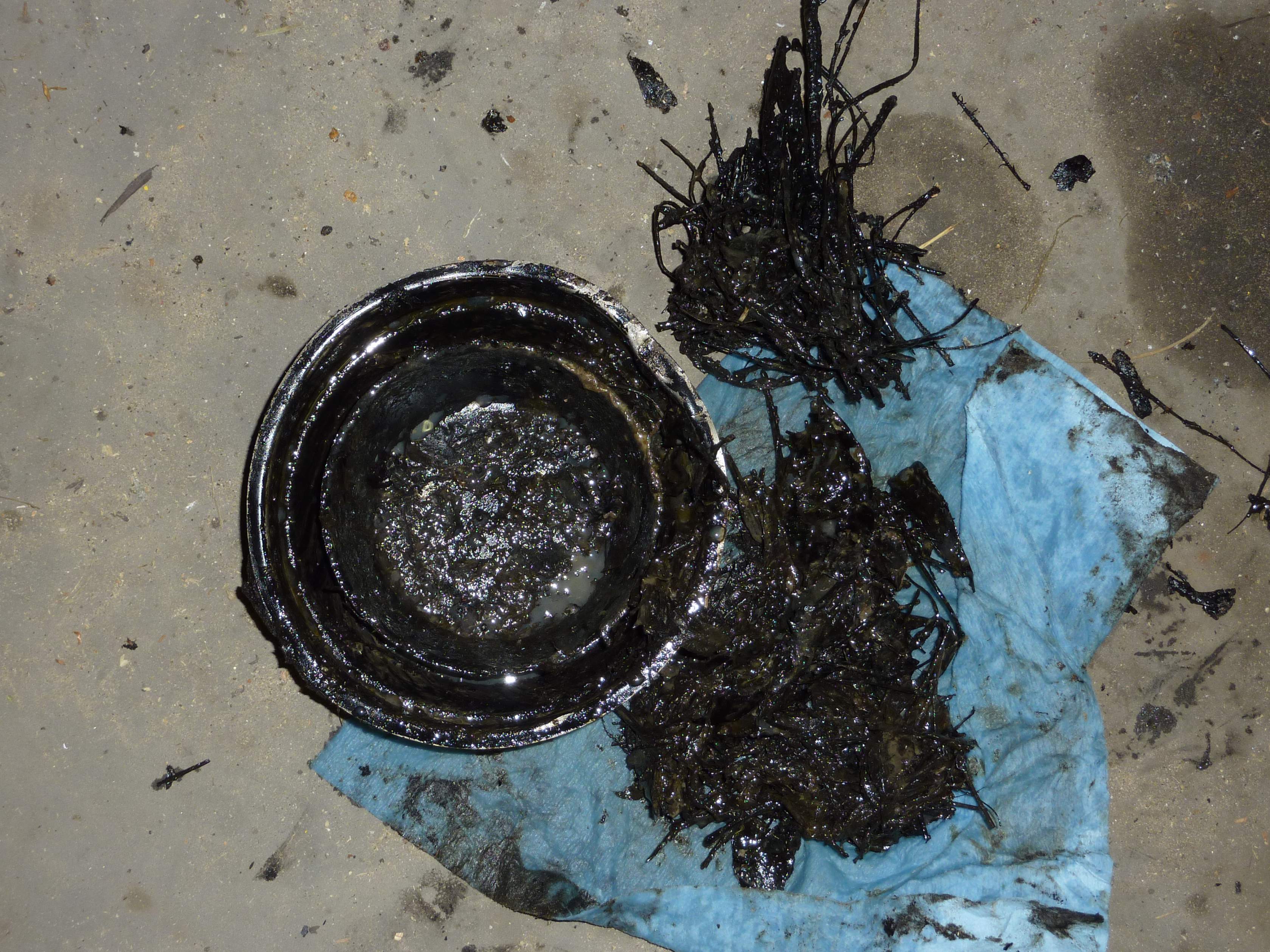

this wut looks ta be a mixtured mess with molasis *** out of my oil bath.
i bet ol blue breaths much bedder now...
in all my day of tinkerin. ive never seen nuthin of the sort.

wow, pretty nasty looking stuff but imagine if you did not have the filter and all of that would end up in combustion chamber. Filter did what it was supposed to do. Oil bath filter is one of the simplest and best design that lasts for ever. I'd just soak it in diesel well and use a wire brush to clean all the way to the metal. Fill the bowl with good clean oil and you're good to go. This tractor of yours did not get any TLC.
