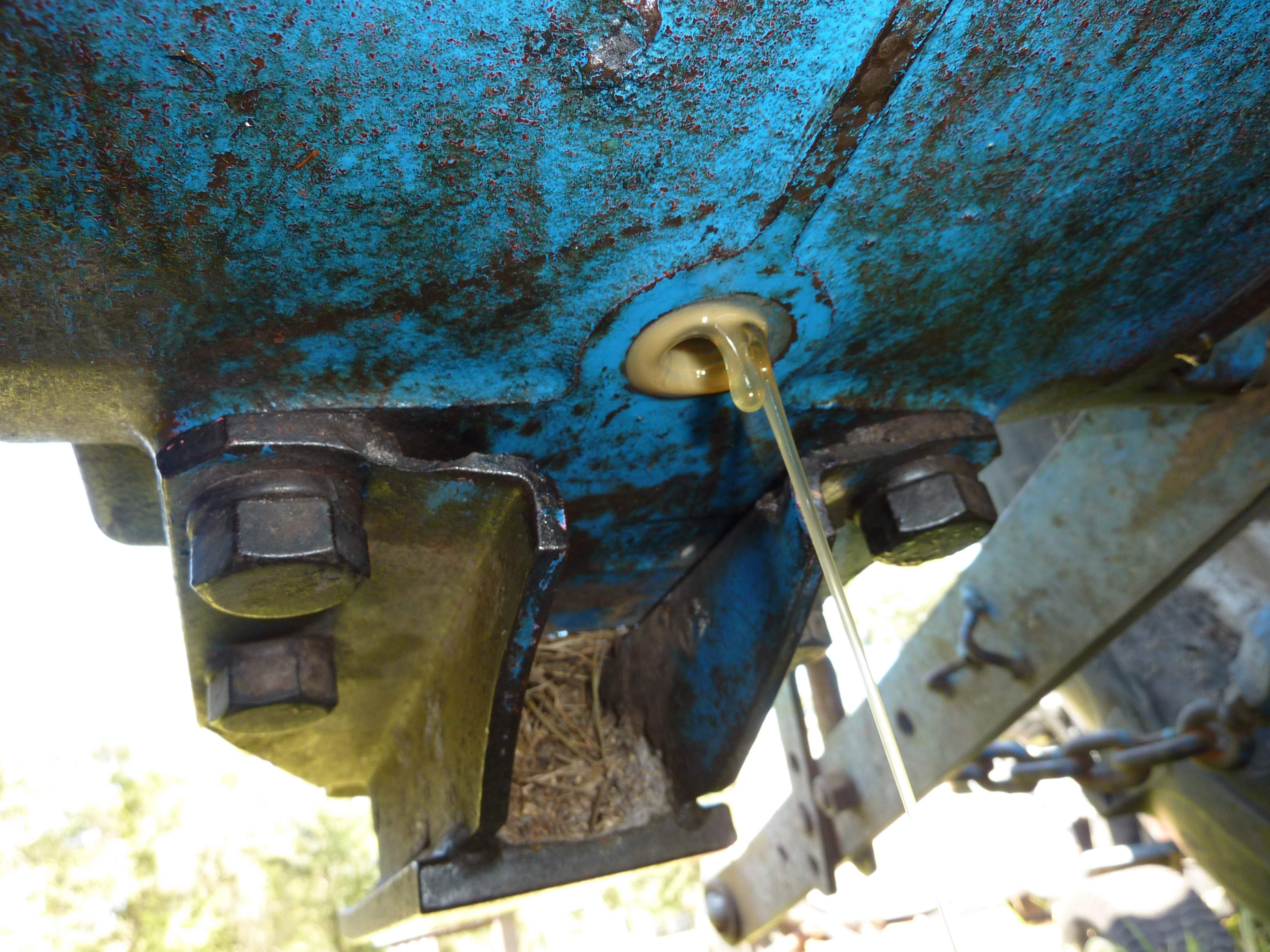

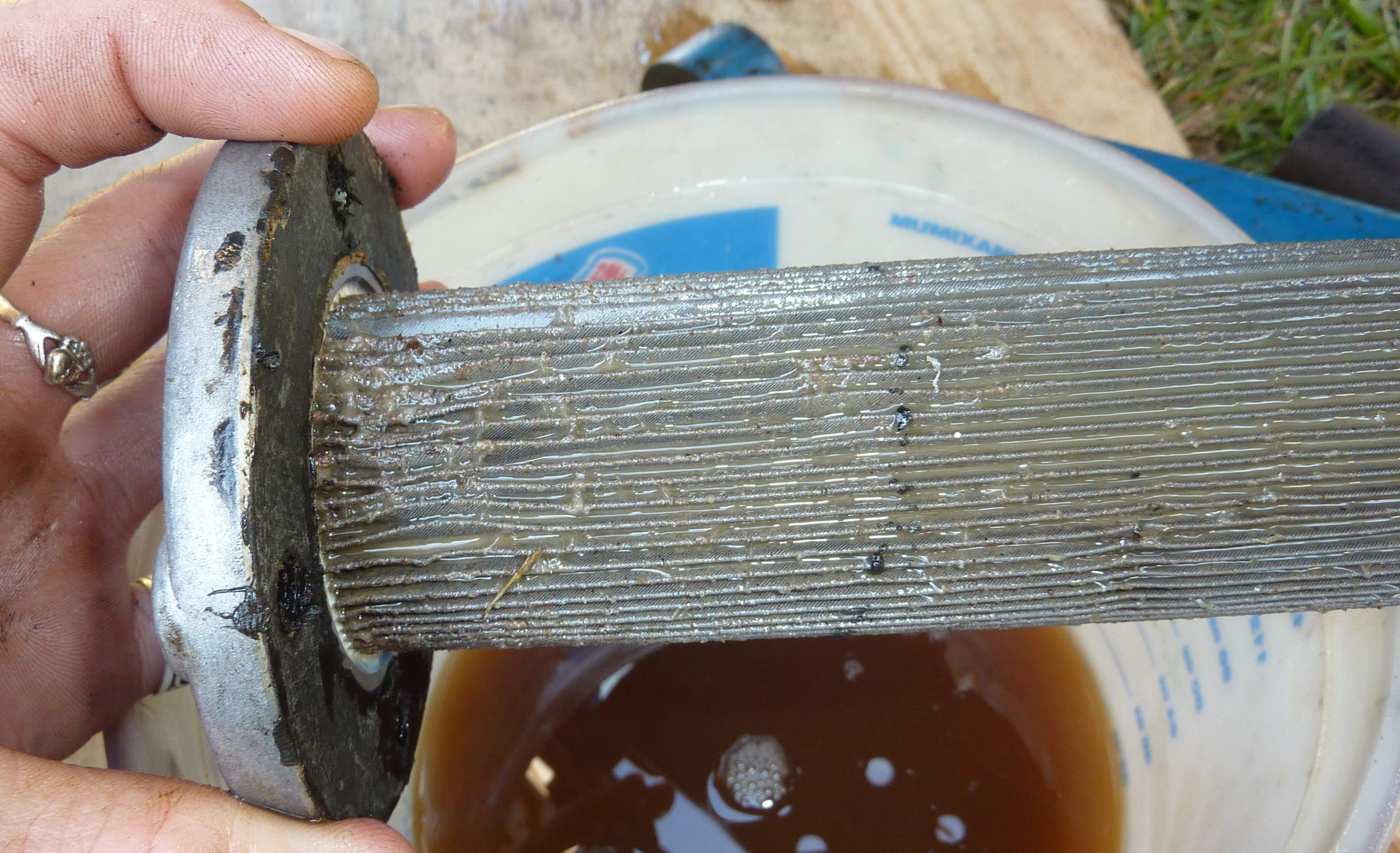

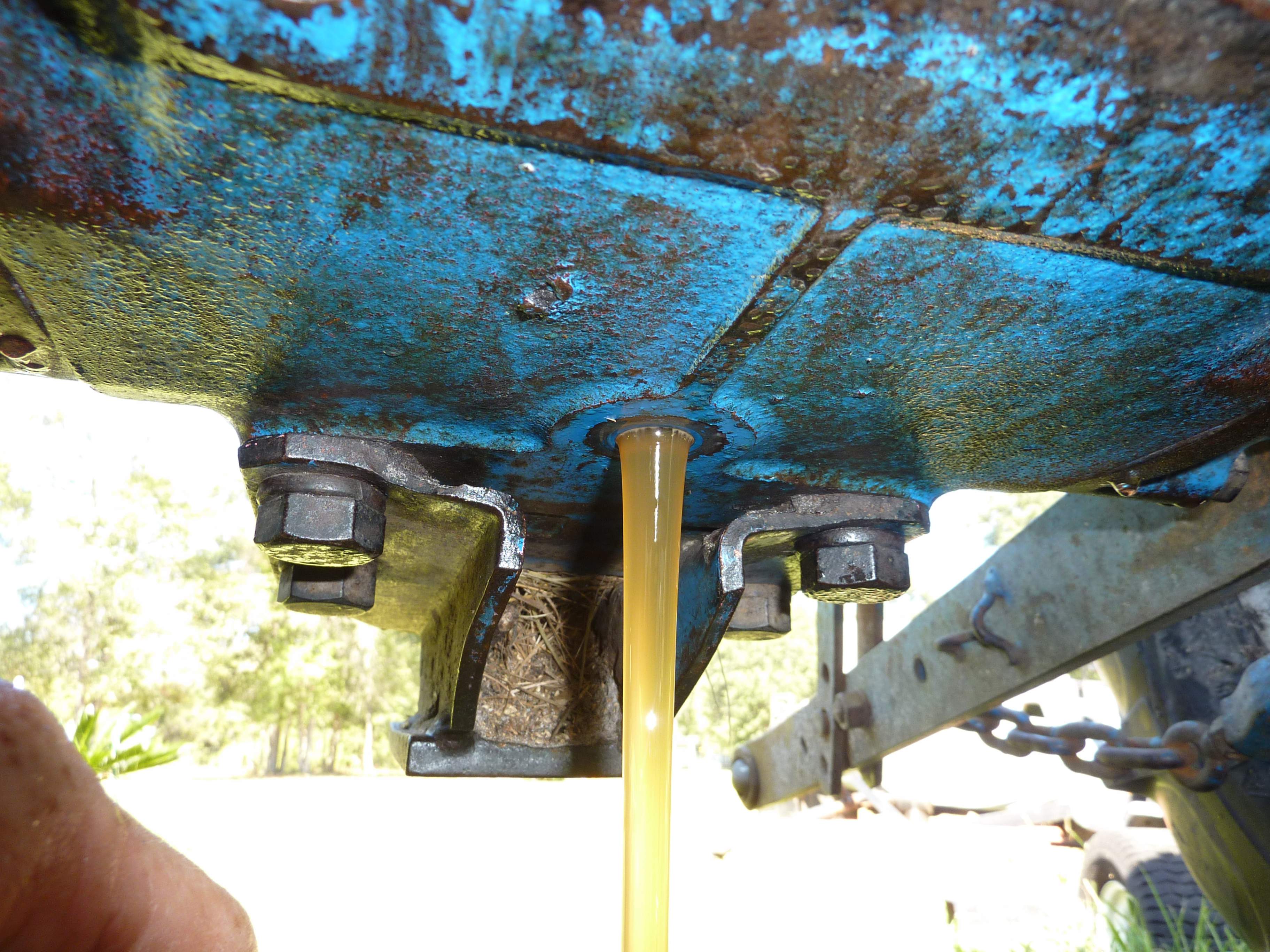

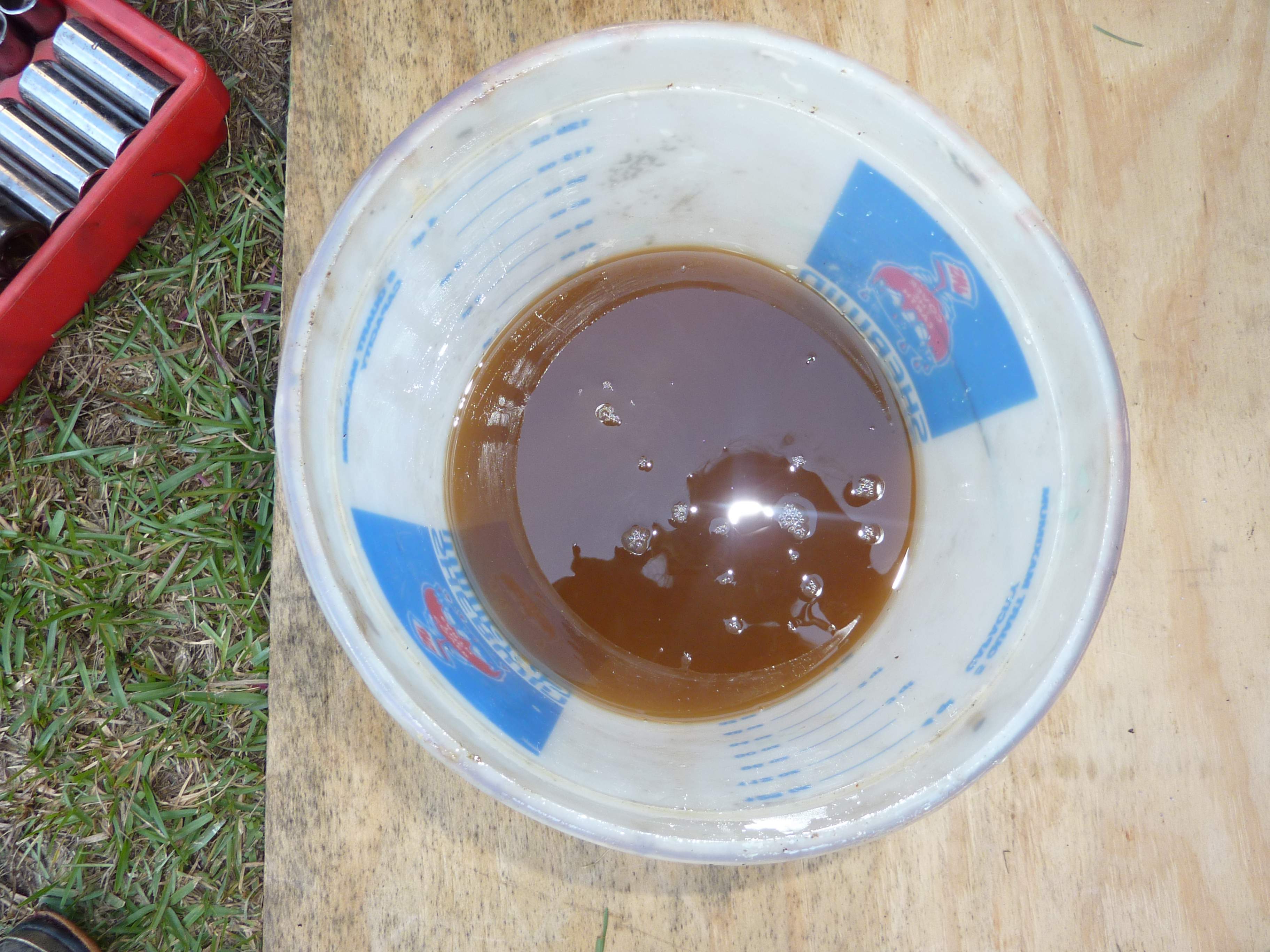

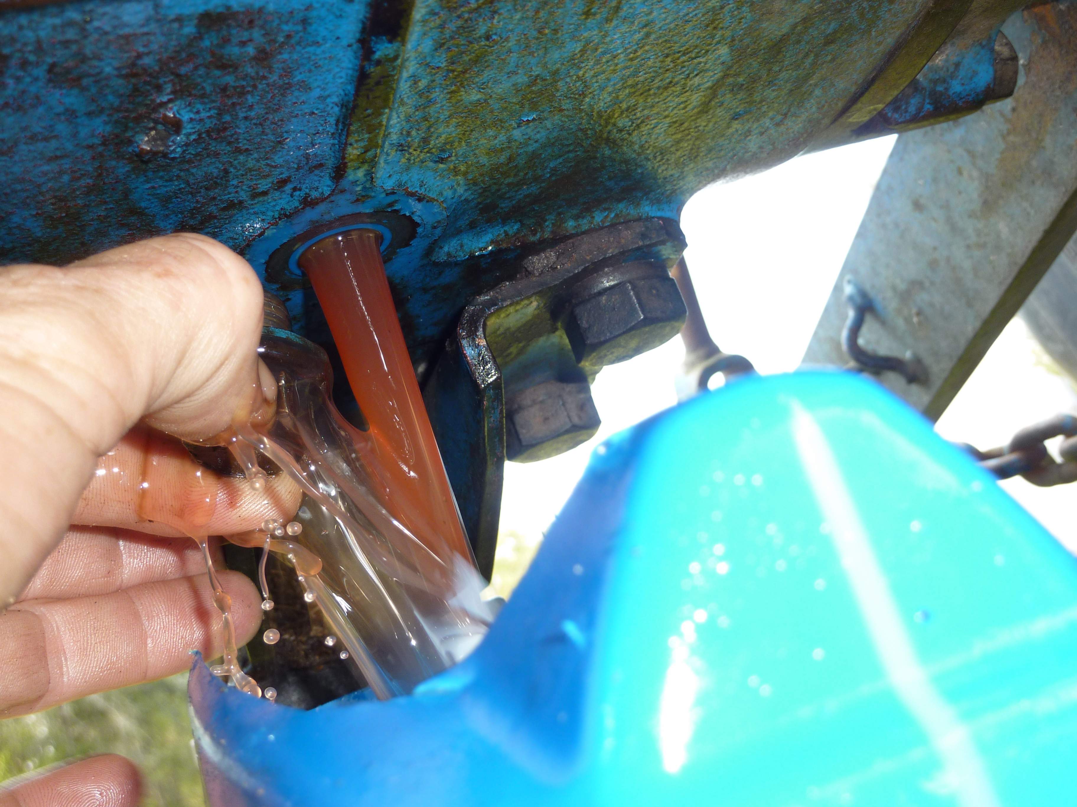

i no i sed i wuz gunna change the fluids n clean the filter yesterday. sept. well. i will never turn down a frend in need. specially an elder... wound up committing myself ta laying a floor. wich of course usually tends ta more.
as fur the fluid n filter. Yes Sir, i took pics as i went. looks like they downloaded opposite of my choosing.
the pic with the full flowing fluid is instantly as i pulled the plug. the pic of the drizzlin is just that. the tail end of it before i dropped the tube n pulled the filter. i like to put a fresh gal size bucket ta catch the tail end of the fluids. so i added a pic of the tail end fluids. last but surely not the least. is the filter. it's not as bad it's 3rd time round. . i'll head on out n clean it with diesel. take pics of inside the case again, then clean it best i can n flush it again. thank you jesus n the men on TBN. My Irish stubborn, bullheaded butt aint bout ta give up. :crossfingers:

   / Lilredfox sending out SOS #175
Looks real good lilred. I put a link that was titled "innards of f-1700 transmission". If you are inclined can certainly gently take the cover off to see the inside and vacuum out all the crud. I just did it on my just to have a look. It did not damage the gasket when I remove the cover so I reused it. Beyond that and the differential there is no where else hyd oil is traveling minus pump, suction and discharge line. Good progress so far.:thumbsup:

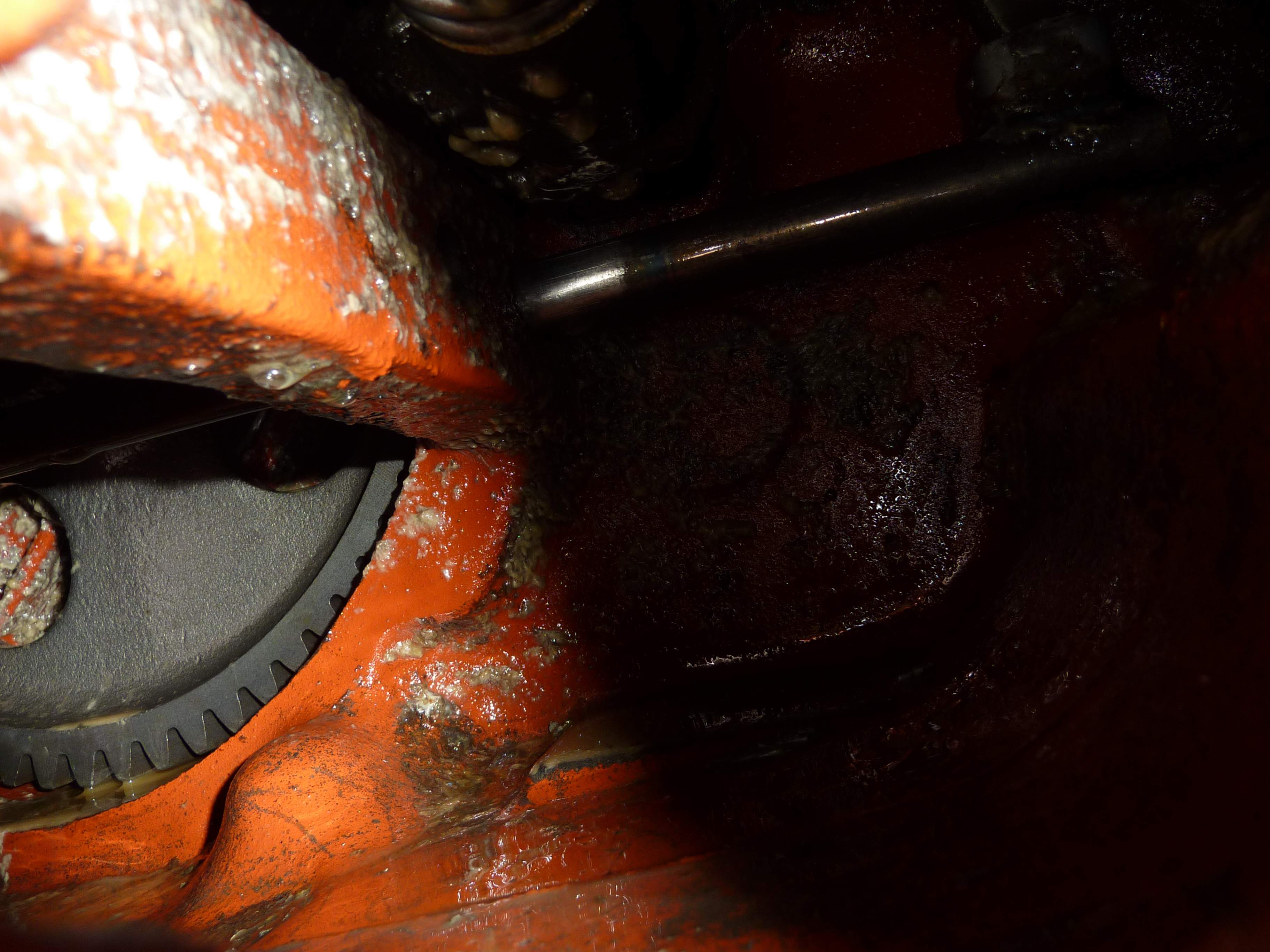

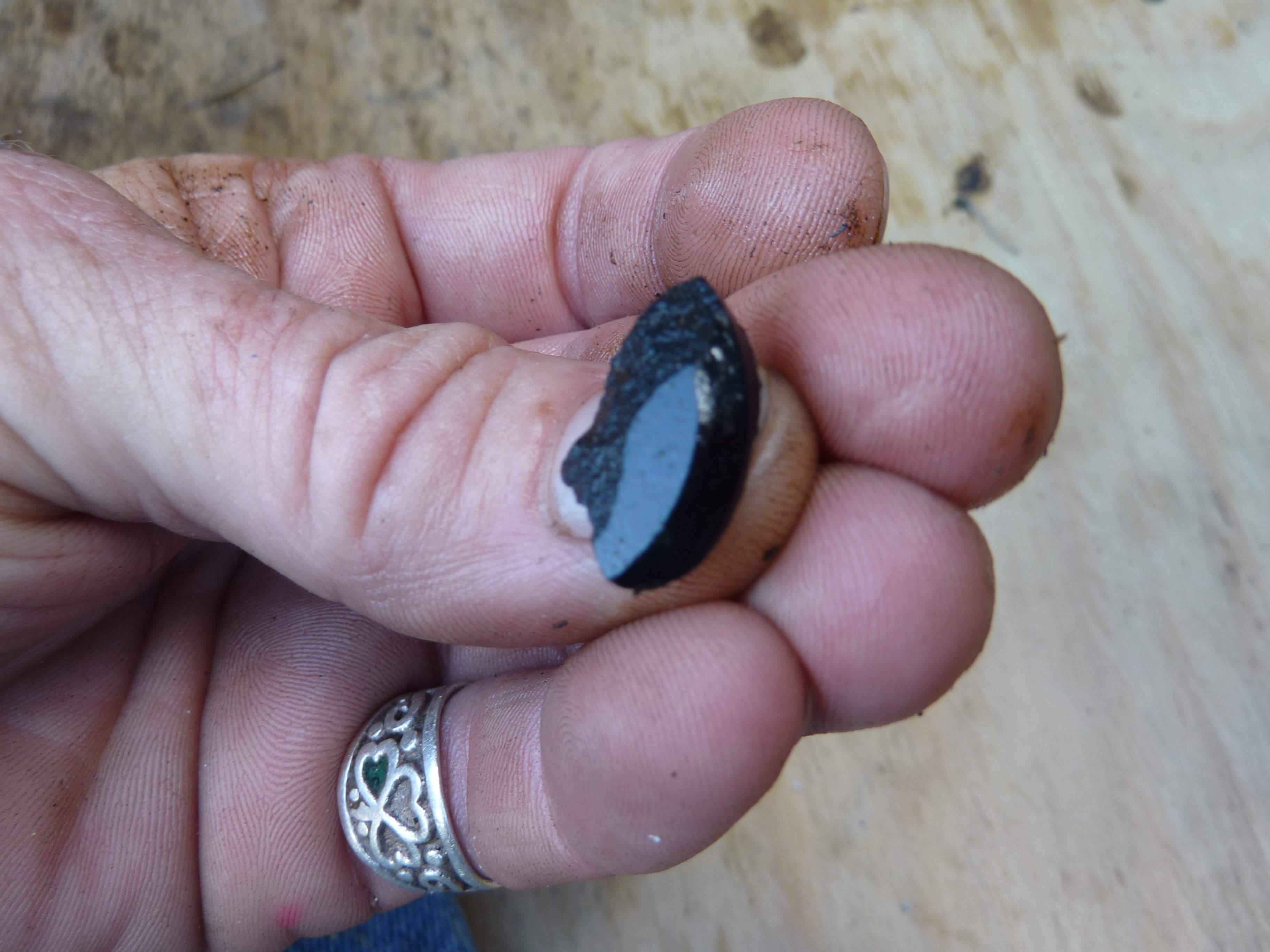

Many trials n tribulations with this tractor. if this flushing dont do it. im seriously thinkin im gunna be takin off the cap n goin in like u sed. i got it back tagether n ran it fur bout 15 minutes. it wuz still liftin. i lost lite n tamarows another day. the full flow in the pic is the burst as i pulled the plug on the first flush with diesel. theres a pic were im holdin a chunk. yep, pulled it out wen i reached in ta feel the bottom of the case thru the filter hole. hopin i wuznt gunna find zactlee wut i found. i.e. chunks... not good. it's cast like. machined. the third n fourth pics show im prolly gunna wind up havin ta pull the cap off ta clean it bedher. at this rate... well, i aint gunna git it all, not just by flushin like this.

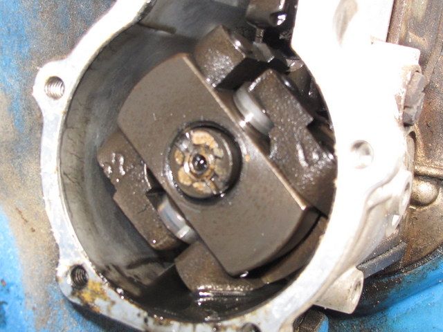

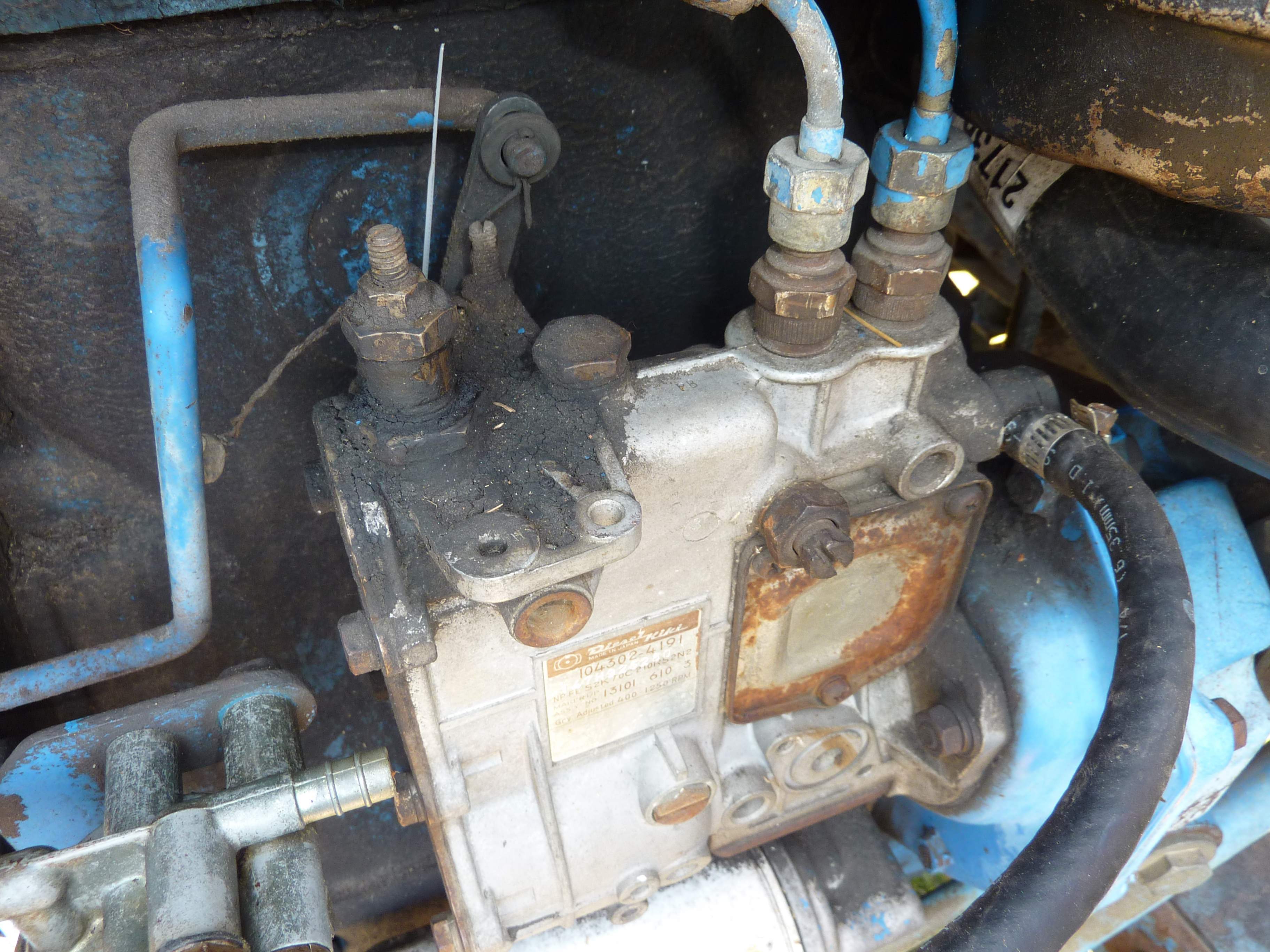

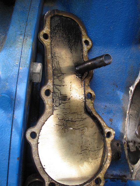

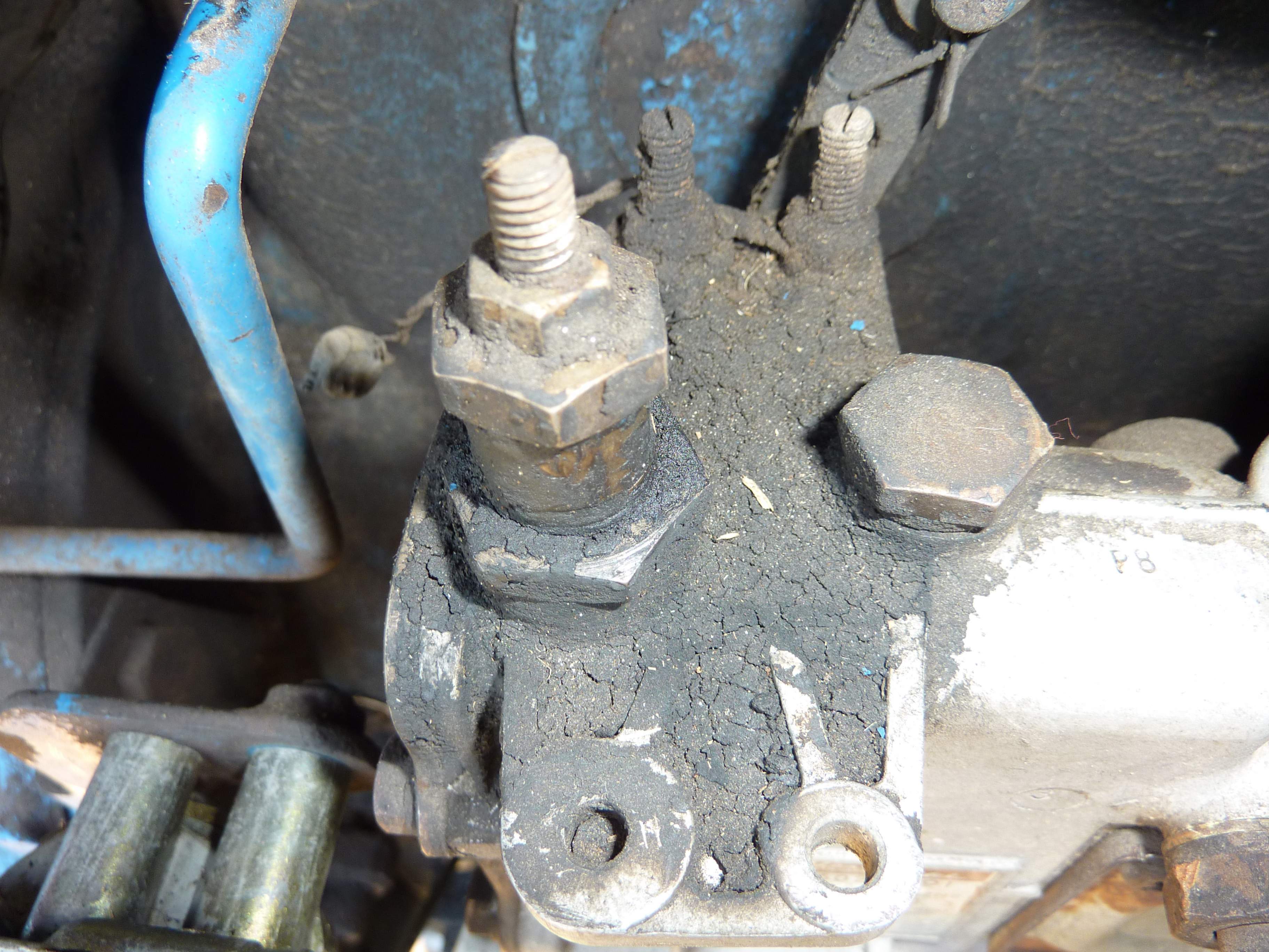

wun thing at a time. i no, i no. i god it alred-d. sept, i wanna ask yea all if u can tell me wut the adjusting screws are n do that sit on the top left of the injector pump. as ur lookin at the side. i also noticed i do not have a drain plug. unless it's on the other side, in wich id have to remove the pump to find that out. i read about bein able to drill wun out fur the drain. i to would be leiry bout contamination gittin in. i also read were i have the option to:
Yes, suck it out....dont go there guys. not less ur feelin compelled. n well... guess i got it cummin.
Im still tryin to understand wut the link sed about bleeding the air out of the fuel filter n wutnot.

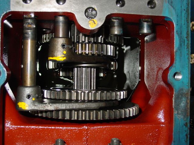

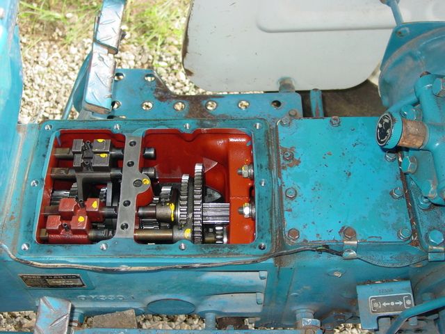

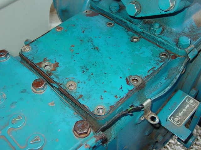

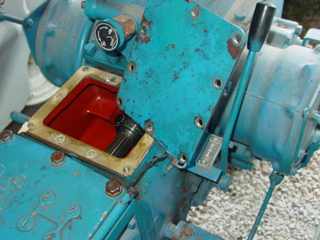

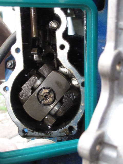

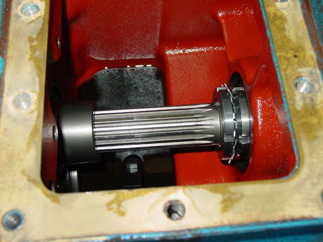

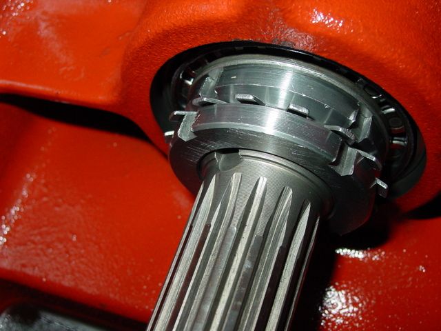

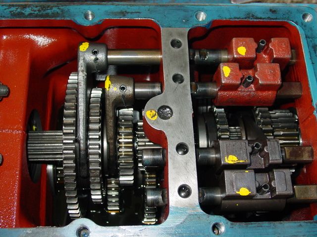

Okay here we go with the link and additionally I'm posting some pics here as well. I don't like at all what I saw. that broken case piece appears to be a broken piece of gear tooth. I really think you need to take the cover off the transmission and section between diffy and transmission. It has two shaft , the top one goes to bevel gear in the diffy for locomotion. In the bottom there is another shaft that run the pto with a paddle splasher to lubricate the gear and shaft assembly. make sure not to lose the detent balls (four) that keeps the shifter in place and not jumping. I don't you can pick up all the crud just by draining alone. That muck need to be sucked up with a shop vac. be gentole taking the cover off, the gasket is rubber on transmission and paper on adjacent area. I was able to reuse both gasket without damaging it. That the way inside my transmission looked like. I just opened it up for a looksy. My rig was always garaged or shed.
JC,
http://www.tractorbynet.com/forums/...ord-1700-transmission-innards.html?highlight=
Okay, I see you got the one that does not have a drain plug. contamination is a valid point. What you can do is to partially open the back plate and drain from there. in order to do a btter job , you need to take the hex nit on top that is your fill port. it does have an air port to keep the injector atmospheric. The stud with the hex nut is how they adjusted the nozzle flow for the injector. don't dork with that as it might get you deeper in trouble . That's why they secures their adjustment with wire and piece of stamped lead. when you push a bit of air from top with the back plate slightly open it will push all th eoil out. You need about 2 oz clean engine oil in there.
