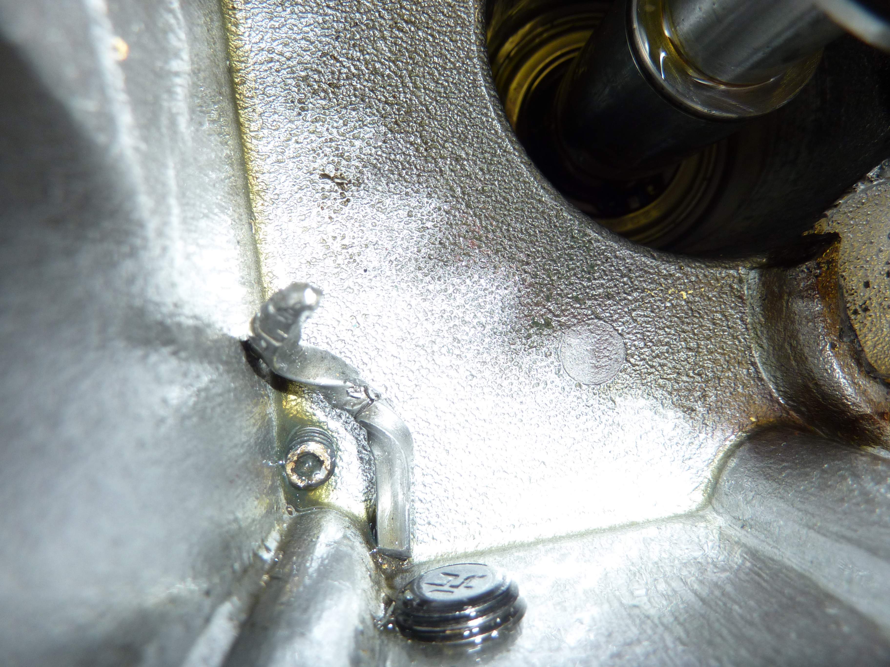

Many trials n tribulations with this tractor. if this flushing dont do it. im seriously thinkin im gunna be takin off the cap n goin in like u sed. i got it back tagether n ran it fur bout 15 minutes. it wuz still liftin. i lost lite n tamarows another day. the full flow in the pic is the burst as i pulled the plug on the first flush with diesel. theres a pic were im holdin a chunk. yep, pulled it out wen i reached in ta feel the bottom of the case thru the filter hole. hopin i wuznt gunna find zactlee wut i found. i.e. chunks... not good. it's cast like. machined. the third n fourth pics show im prolly gunna wind up havin ta pull the cap off ta clean it bedher. at this rate... well, i aint gunna git it all, not just by flushin like this.

That looks like a peice of a shift fork.

I don't like the looks of the tooth piece (I think it's a tooth). If the 1700 has the diff lock like the 1710, it might be worth looking to see if someone stepped on the lever when things were spinning too fast. On the 1710, the lever is on the right side, so I figure that's where it locks up the rear.

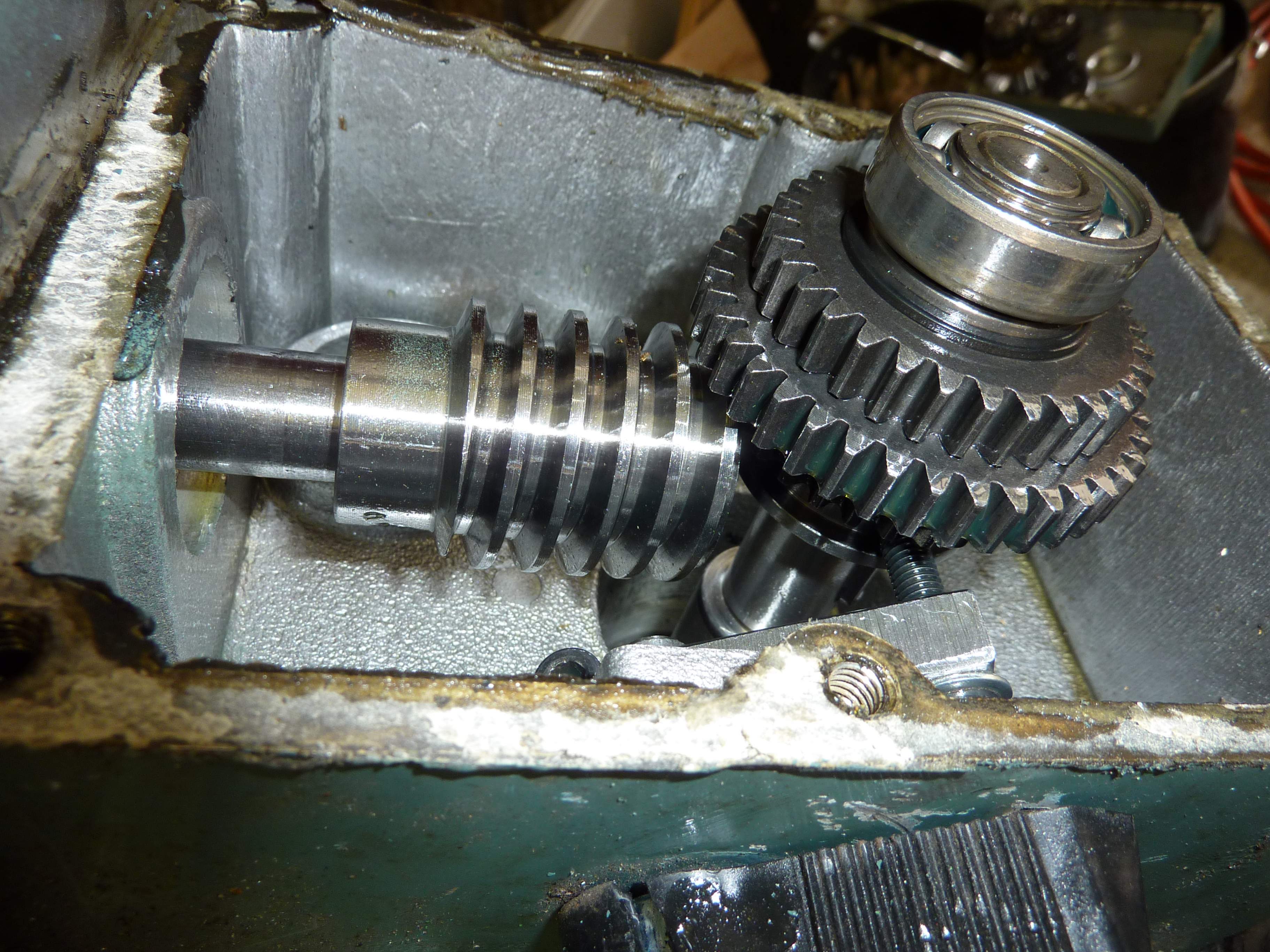

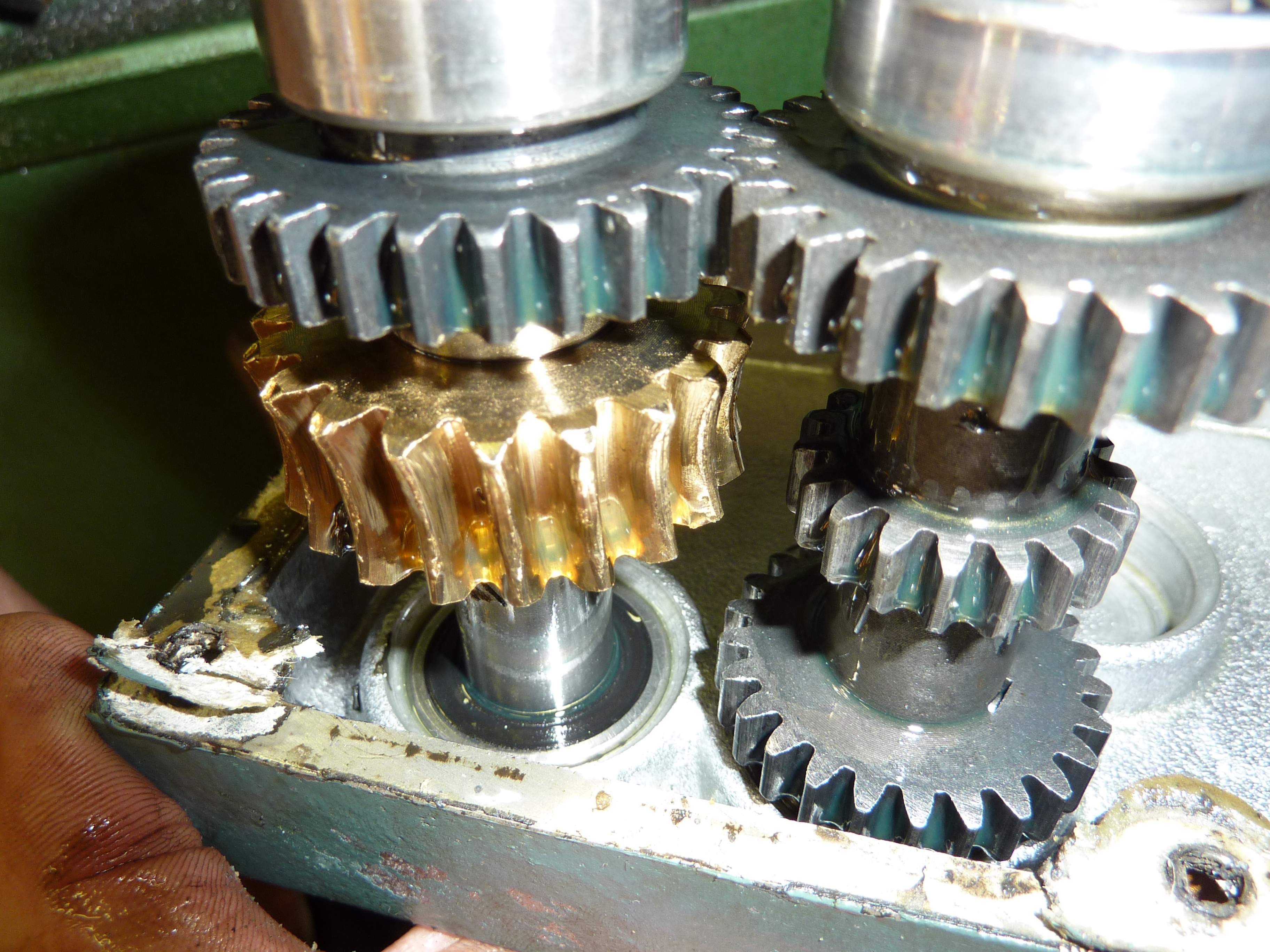

#183
i thot i wuz dun doin gearboxes fur.... well. longer than it's been. thats fur dagum sure. lining sum gears up can be a bit of a challange id rather bypass. Last gearbox i busted open wuz my enco bandsaw. it wuz slippin. wuznt any of the normal things. nope, couldnt be that easy. specially wen i had a bunch of blank railroad spike i hadda git cut fur the demo i's doin. i wound up splittin the gearbox only to find the set screw had wiggled its way out, sending the key on it's way... persay. didnt look like it damaged the gears tho. hadda walk away n give it a rest wen i wuz linin them gears up. toppa the lid had gears n the gears inside the unit itself. wudda journey that wuz. finally, got ta run it n it slipped again. found that the pure imitation harder that titanium plastic had decided it wuznt gunna be responsible fur lockin the speed control into postion no more. had self combusted internally. Yep. broke clean. i've welded plastic but this dont melt. it just crispifies n collapses.
thanks fur lettin me share a flash frum the past

Um. Um. by golly, u may be onto somthin. as im readin wut u rote. i wuznt sure wut lever u sed might have been stepped on to hard. n i have a foot/heal, lever on my right side back end of the footplate. n i wuz told that lever is fur controling how ur tractor turns. sept my lever aint never been in the up position send i got it back. i do have a 1700
