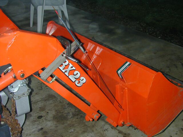

I thought this might be of interest to someone ... who know's who. I've been using it for several weeks now and haven't figgered out how to mangle it or tear it off yet. Kindof another no-brainer, like the thumb (previousy posted today). Materials are a lonesome piece of 1/8" welding (filler) rod, a scrap of bed-frame-angleiron and a piece of 3/8" OD steel tubing ... oh, and a little red pvc electrical tape. Obviously the C-clamp was intended to be temporary to test the design ... now I'm kinda stuck on seeing it there ...
I'm pretty happy with the fact that I didn't spend $20-$60 bux on similarly capable device that was all painted purty but didn't even have a C-clamp sticking out so everyone could see it. As everyone has said ... a bucket level gauge is imeasuarably helpful.
Cheers!

I have always wondered what made Kubota think that a good bucket level indicator wasn't necessary on their machines anyway. Do they offer a half way decent one as an option or just that gadget that fastened to the bucket on your machine? /forums/images/graemlins/confused.gif

Well you did good and made one for yourself anyway so you won't be trying to figure out how to work the one that came with it. Good for you.

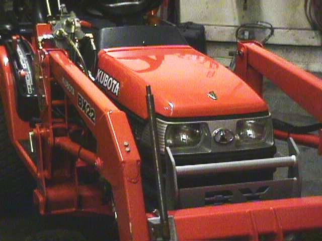

Kubota doesn't offer one, but the one that I have works great. Unfortunately, I don't have as fancy a holding device as his, however, it won't get knocked off very easily either when I come close to a tree.... /forums/images/graemlins/grin.gif /forums/images/graemlins/grin.gif /forums/images/graemlins/grin.gif /forums/images/graemlins/grin.gif

I think you've hit upon the only thing I didn't test, Junkman ... I got hung up on a tree, I gaulled up a tree, I yanked out a couple of has-been trees, but, you're right, I didn't get "close" to a tree and, now, I fully expect my 50c bucket level dude to fall right off if I should, for some goofy reason, get close to a tree /forums/images/graemlins/grin.gif /forums/images/graemlins/grin.gif /forums/images/graemlins/grin.gif /forums/images/graemlins/grin.gif

I guess I am in the minority, but I have never wished for or wanted, or needed, anthing other than the little indicator that is on the bucket like in Homebrew2's photo.
It could be because there is almost nothing level where I live and I angle the bucket to move the dirt the way I want to. By looking at the indicator on the bucket I am able to easily determine the angle of the bucket bottom, whatever the angle might be.
The only shortcoming with that little level indicator on the bucket is that there needs to be one on each side, as sometimes it is not visable when watching the left side of the bucket, due to the hood being in the way.
I may rectify that by adding a second indicator on the left side of my bucket... /forums/images/graemlins/smile.gif

Henro how do you all use the stock level indicator? Do you sight down it like a gun site or what? I don't see an actual spirit level on it. Still can't understand how it's used.

<font color="blue">Henro how do you all use the stock level indicator? </font>
Mike,
The top horizontal flat piece is parallel to the bucket bottom. So one simply adjusts bucket angle to put the top surface of that little indicator at whatever position he wants the bucket bottom to be.
I suppose it would not be as precise as the end of a rod matching up with the end of a tube would be, but for my needs so far, it has worked just fine.
And, aside from not giving a perfect indication of what true level is, I think it probably is better a different way, because it gives the same accuracy at whatever angle the bucket is at.
Now don't ask me why this might be important! I'm not sure if it is. Just something I like, for some reason...
