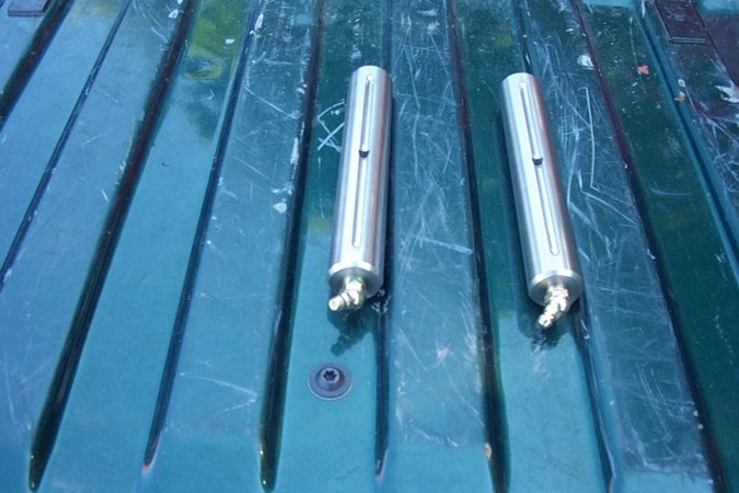

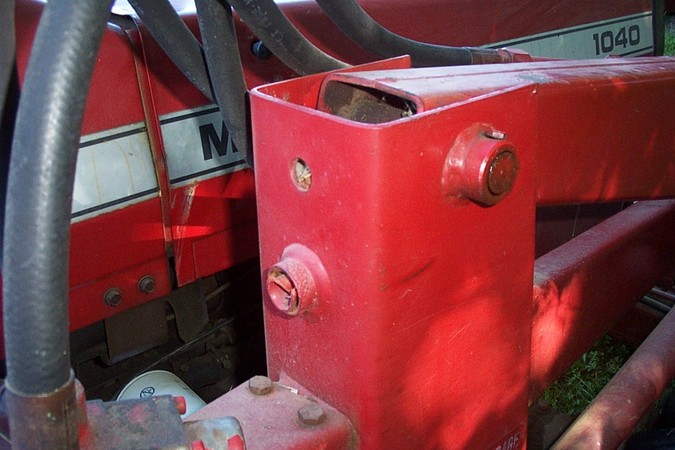

I thought I would post what I ended up doing to replace two of my loader pins. The pins were not getting any grease because one of the grease fittings had broke off on one side and on the other the threads were stripped out. Rather than going through welding and redrilling and tapping for new zerks I fabricated new 1" stainless pins. I drilled the pins from the end to the center and tapped the ends for the zerks. I drilled a connector hole in the middle of the pins and milled a grease groove along the length stopping before the ends. Im attaching pictures, to help explain what Im trying to say ! ;) Hopefully someone else with an older tractor that has this problem could possibly use this idea !

Nice looking pins, Scott. Good job. They should last for your grandkids.

Wow - those are nice. I sure could use a couple of them - my loader bucket pins were obviously never greased by a previous owner - they lare literally square and the bucket clunks around when curling. I sure wish I had a milling machine in my garage :).
Where'd ya get the stainless rod?

Why stainless? It's usually hardened rod like 4140 steel that has been heat treated. I would have thought that stainless is too soft.

The old pins were not hardened ! I used 303 stainless to make the new ones, its pretty tough material, for the amount that I use the tractor they should last forever !

Im a modelmaker by trade, and able to get that type of material at work ! ;) :)
