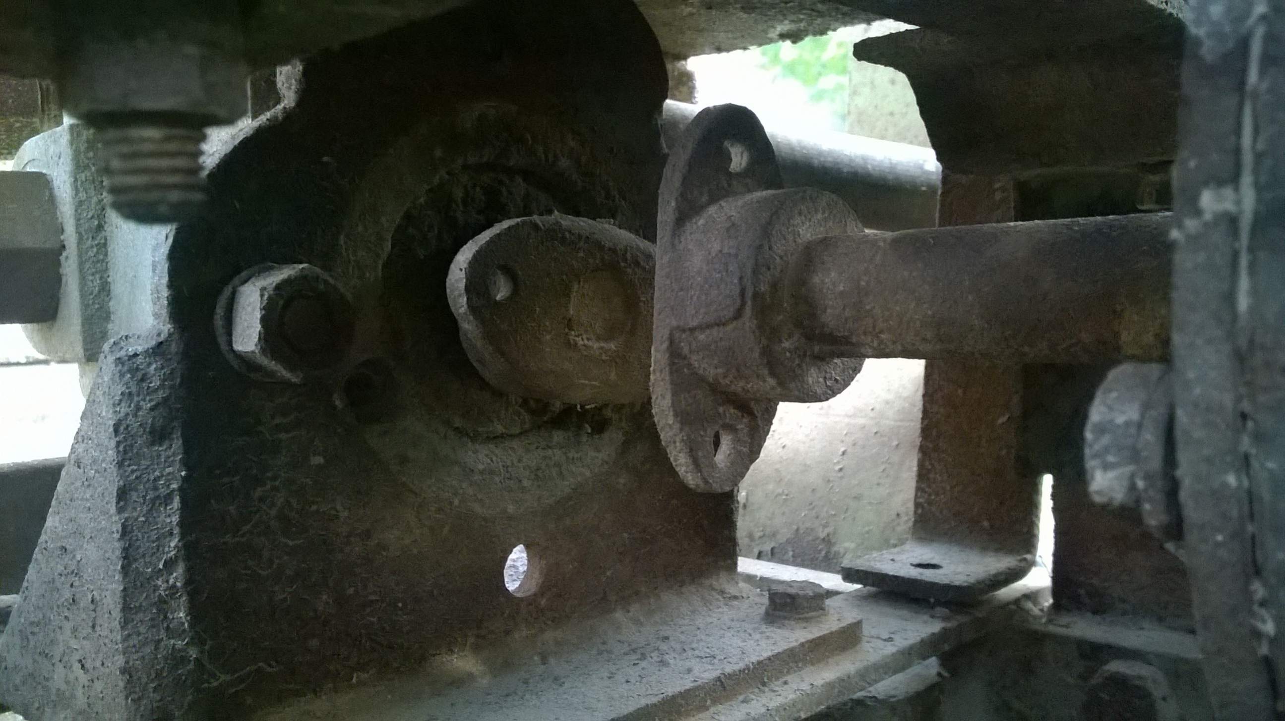

Not sure what to make of this. I brought this up in the Yanmar forum back in the summer. This model does support a front PTO but that's not what I've got. There's no clutch or anything just a shaft sticking forward from the engine that can be coupled to the pump. I kinda doubt there's another one in the world setup like this. It looks like a custom job to me. I didn't move the pump so I think it's installed right where it's supposed to be. :thumbsup:
I am guessing that shaft is connected to the crankshaft. This was a common add on many years ago when adding a loader to a Ag tractor.
I wonder if the pump is a 540 RPM PTO pump. Is the pump shaft smooth or splined.
You mentioned shear bolts, so probably smooth.
Does the tank bubble over when the engine idles?

Here's a photo of the front pump and the shaft that sticks forward from the engine and engages it. I use a rubber bushing and some shear bolts to couple the engine to the pump. This shaft turns at the engine rpm not the rear PTO speed (540).
It will eventually. After about 3 minutes of running today it had not yet bubbled over, but the top of the level went up about an inch in that time. Leaving only another inch before it would have overflowed.

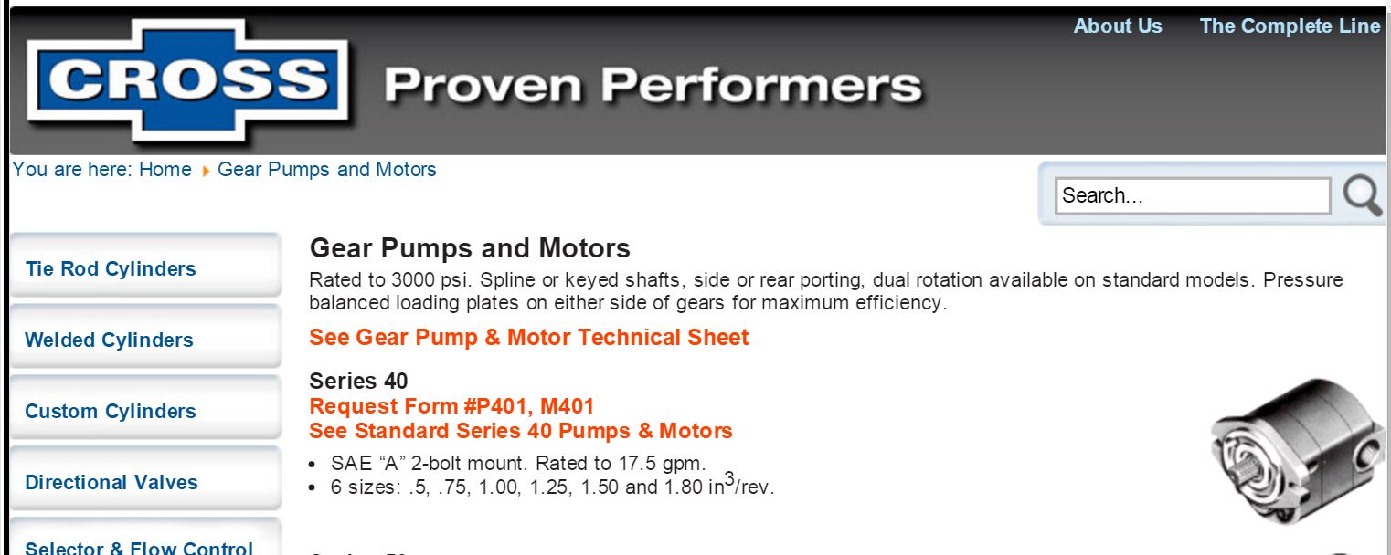

Looks like it is a series 40: Gear Pumps and Motors - Cross Mfg.
Six sizes:
<img src="http://www.tractorbynet.com/forums/attachment.php?attachmentid=454267"/>
That pump says it is rated up to 17.5 GPM depending on cu in per rev.. Joystick valve is rated at 10 GPM. May not be what you want.
