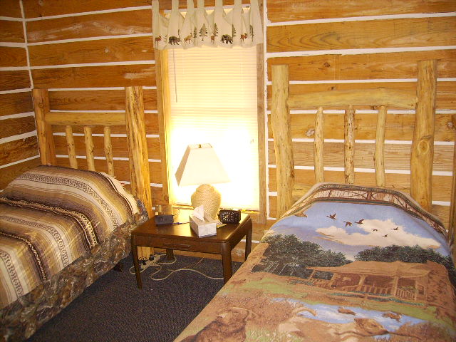

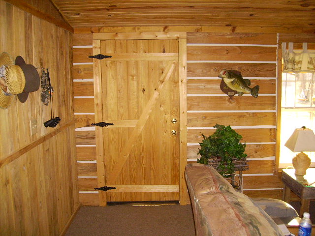

I built my log cabin close to 5 years ago now. It is one story, 1000 sq ft, made of square pine logs and came as a kit from Southland Log Homes.
Log Cabins and Log Homes for Every Life Style | Southland Log Homes
Southland was great to work with. The logs are pine and are treated with Tim-Bor for termite protection. Cedar or cypress might be better but are often nearly twice as expensive. The Soutland logs are guaranteed to life against insect damage.
I had the foundation laid and the metal roof installed but I did everything else myself with the help of friends and family. I had significant experience at building prior to this.
I'm glad I did it. It turned out fine. It was a great learning and bonding experience for the whole family which was priceless. But it was hard and it took a long time. The foundation, floor, walls, roof etc were done very well and are super solid. However, my inexperience on trim, modling, soffits, etc shows. But this is a weekend cabin, not a permanent home, so the minor uglies and flaws, etc give it character.
Feel free to PM me or ask any questions you have here in this thread, I'm no expert but I know what worked and what didn't and I can give some pretty good pointers and tips. I can post some pics to if anyone is interested.
