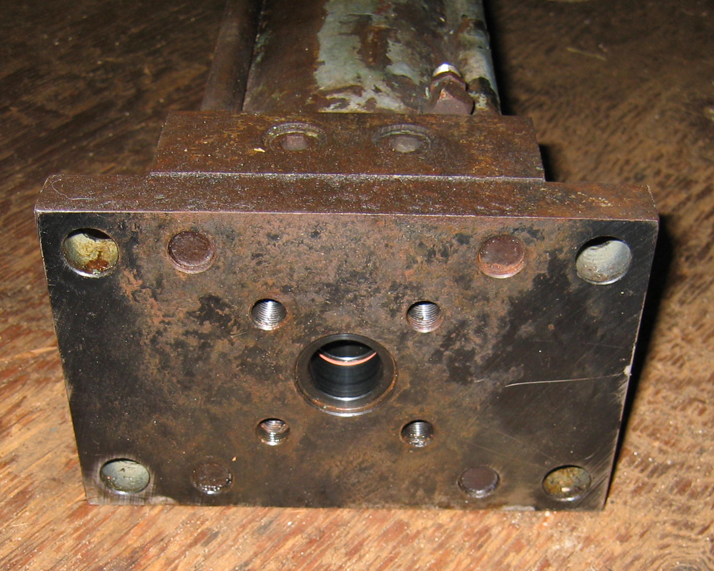

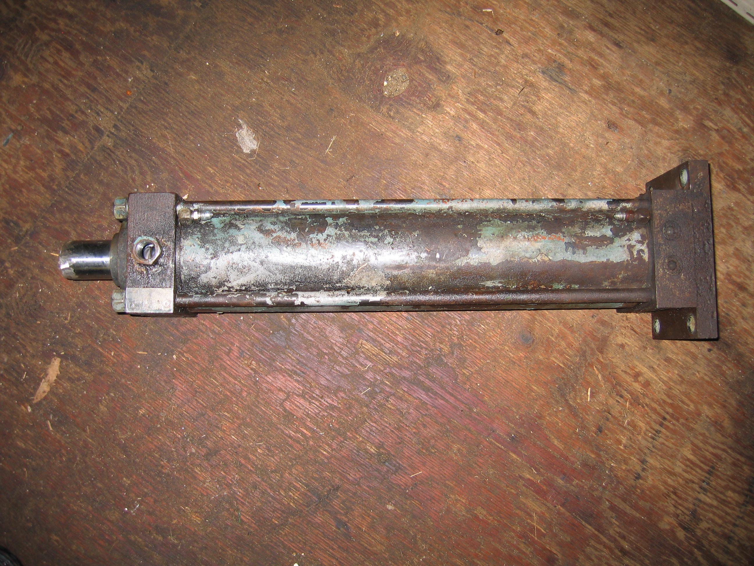

Here are some pics of that cylinder. Have not cleaned it up (obviously!).
The first is a giant chunk of steel with quite a few oil circuits in it. The large center hole is the entry for the end of the cylinder. At the upper left of that are two 1/4" ports. Each was connected directly to the 1/4" ports on the cylinder body shown in the next picture. The last picture shows the end of that cylinder that mated with that giant chunk of steel. Will clean it up early part of next week. Hopefully some info will show from that.

That is an industrial style cylinder. I haven't been around too many of them so I don't recognize it but two major brands are Eaton and Parker (both of which have bought out many other brands in the past years).
BTW that is the first time I have seen the cylinder ports go into the barrel and not the end plates. I wonder if this was a one-off special or a "field" modification?
ISZ
   / Log splitter hydraulics issues...
I have no idea, IceStationZebra. The guy who built it passed away last year and any info along with him. I suspect that end plate the bolts thread into was an add on to mount it to that 'GCoS'. There are side ports in the original base that are plugged. Maybe the original end plate was bored out for this setup....
