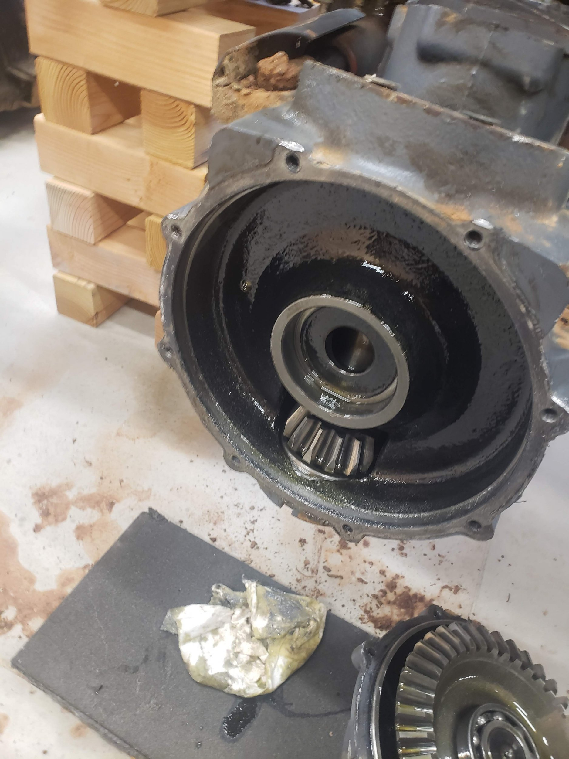

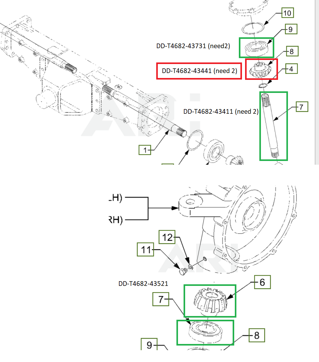

This is probably a long shot but I just purchased a 2003 DK45 (in cub cadet 8454ss form) from a shameless individual who had removed 3 of the bevel gears and vertical shafts from the front end after what I assume was some kind of breakage.
Anyway that's water under the bridge and I'd like to get my 4wd system working.
I can't find this 16 tooth bevel gear and I need two of them: DD-T4682-43441
I *think* I bought all the other parts on ccparts.com. We'll see if they pull through and actually have the parts.

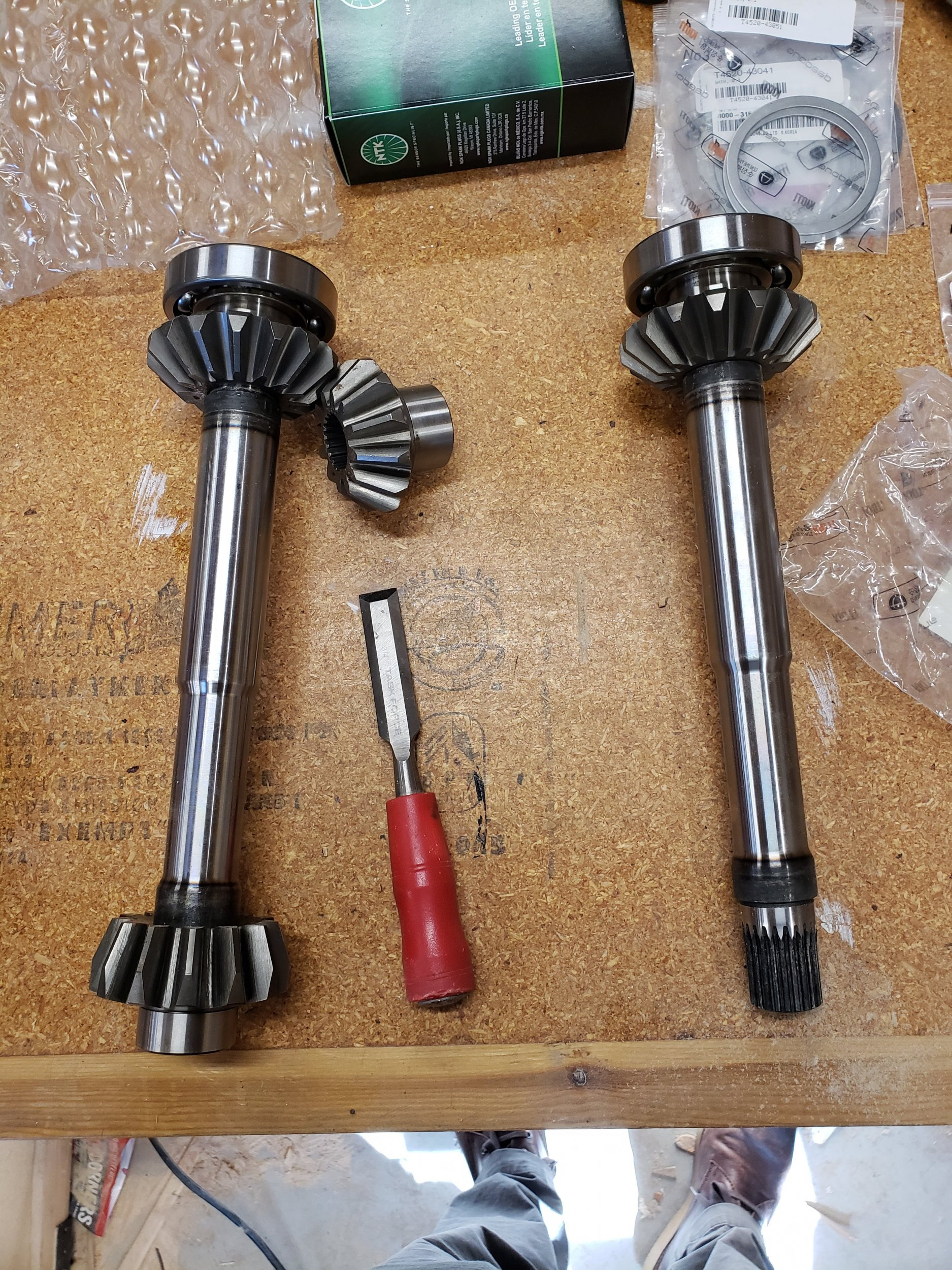

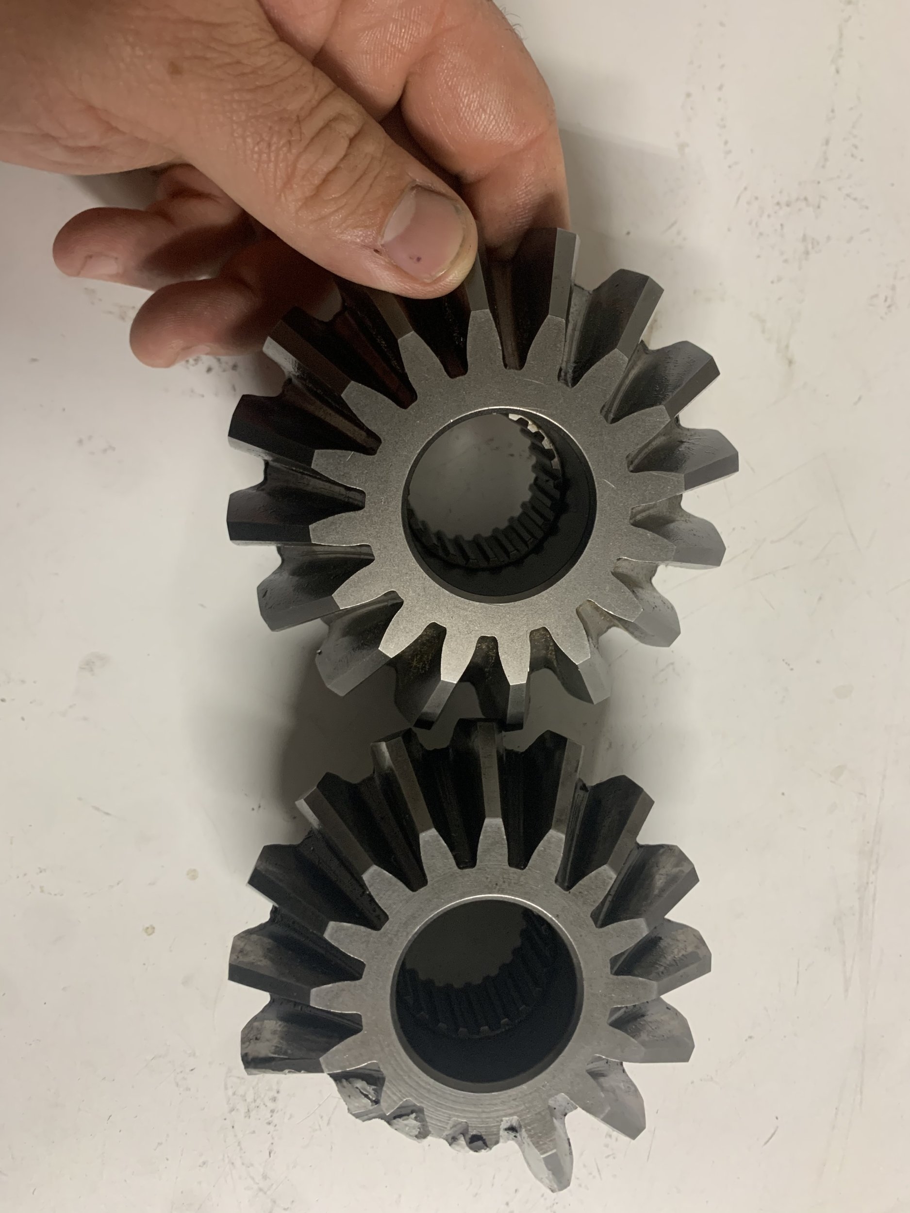

If anyone is curious here are my shiny new gears. Pretty beefy by my eyes, 3/4" chisel for reference. The loader is tweaked on this thing and I assume the broken front axle is related. Must have been a serious event.
Now just to get this thing shimmed and back together. Then I can get to fixing the things that I knew were not quite right and grafting this free to me backhoe to the back ;)

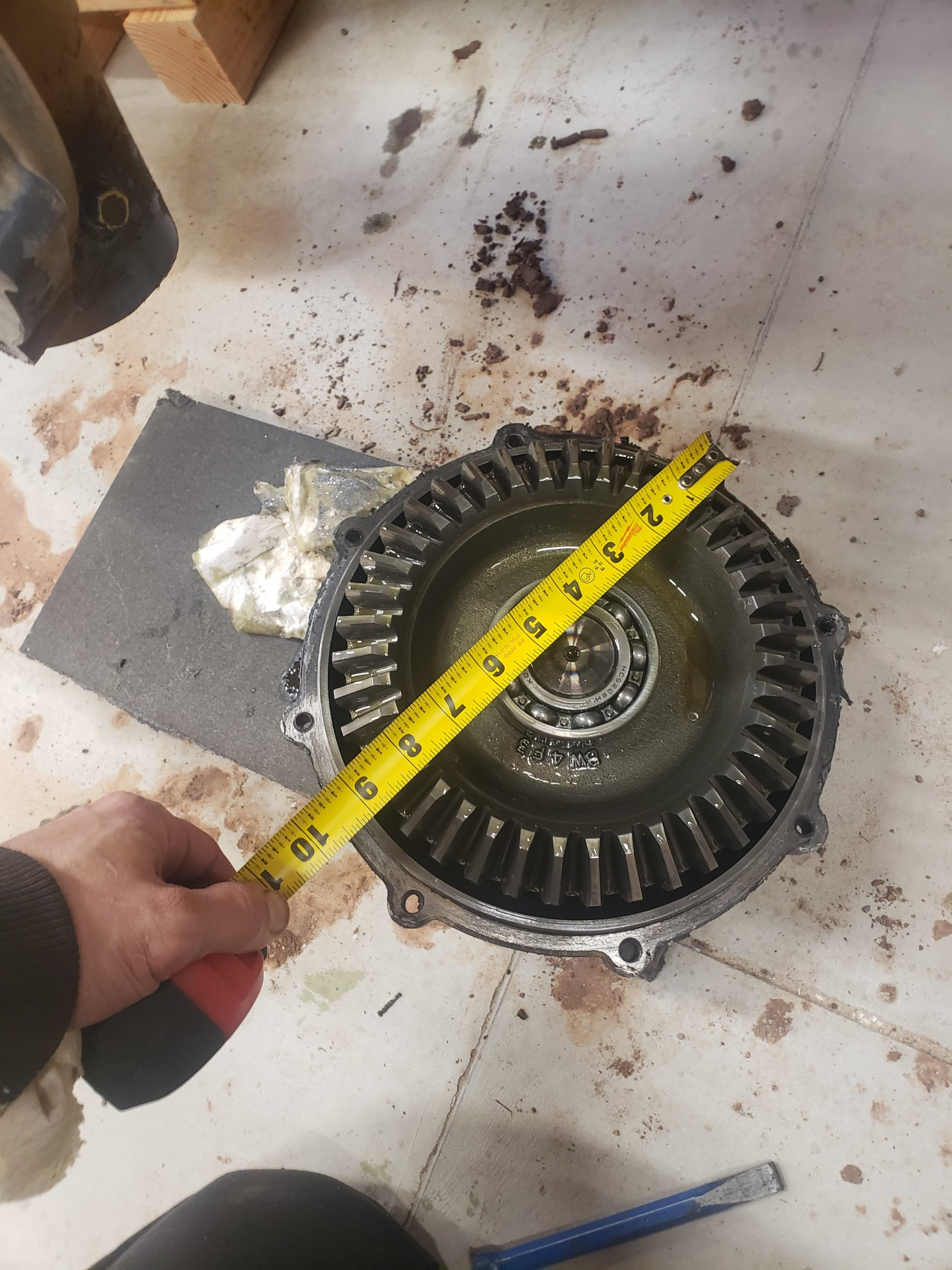

9" bevel gear in the hubs! I need to get my head out of car/truck sizes and into tractor mode.

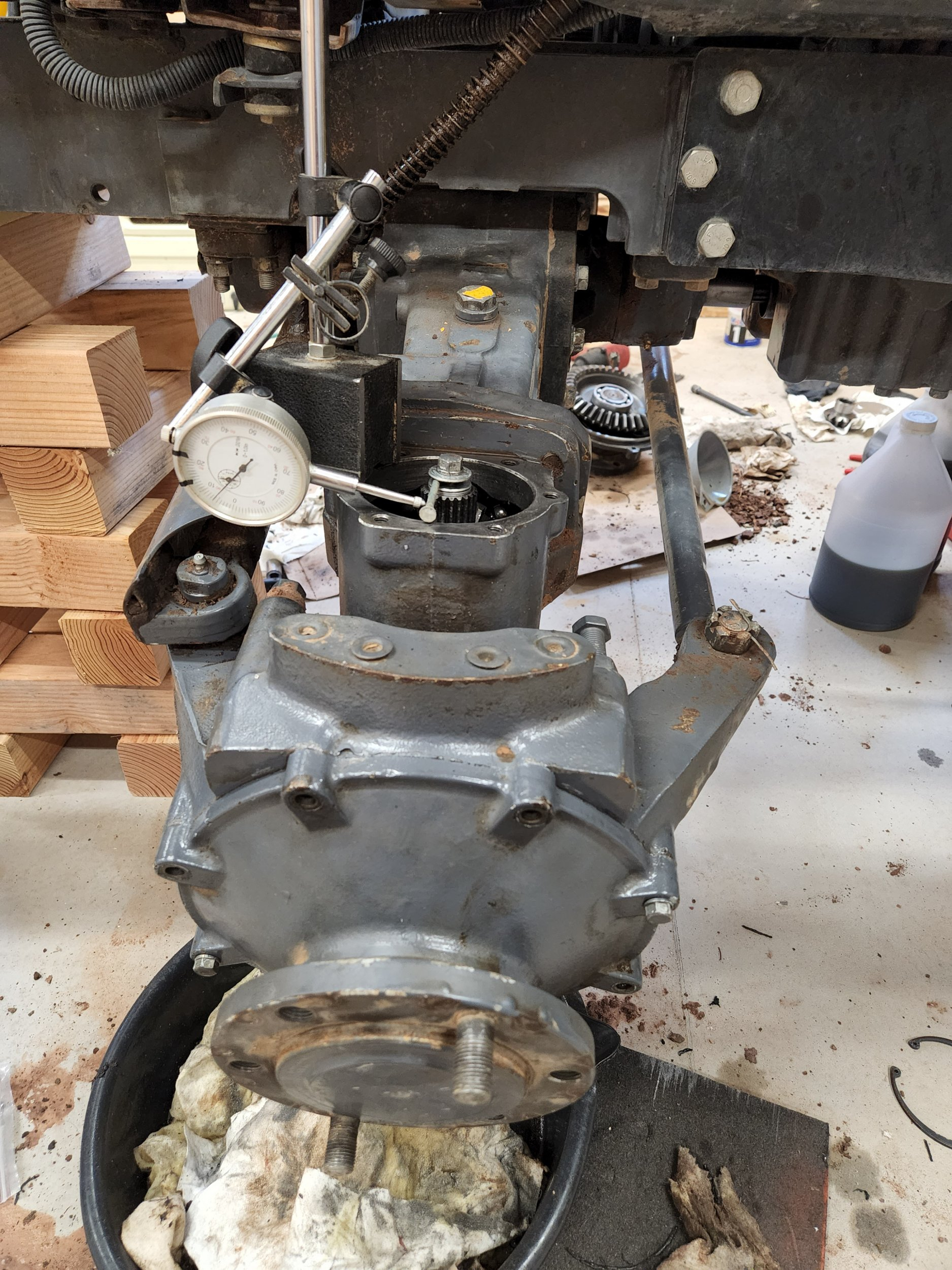

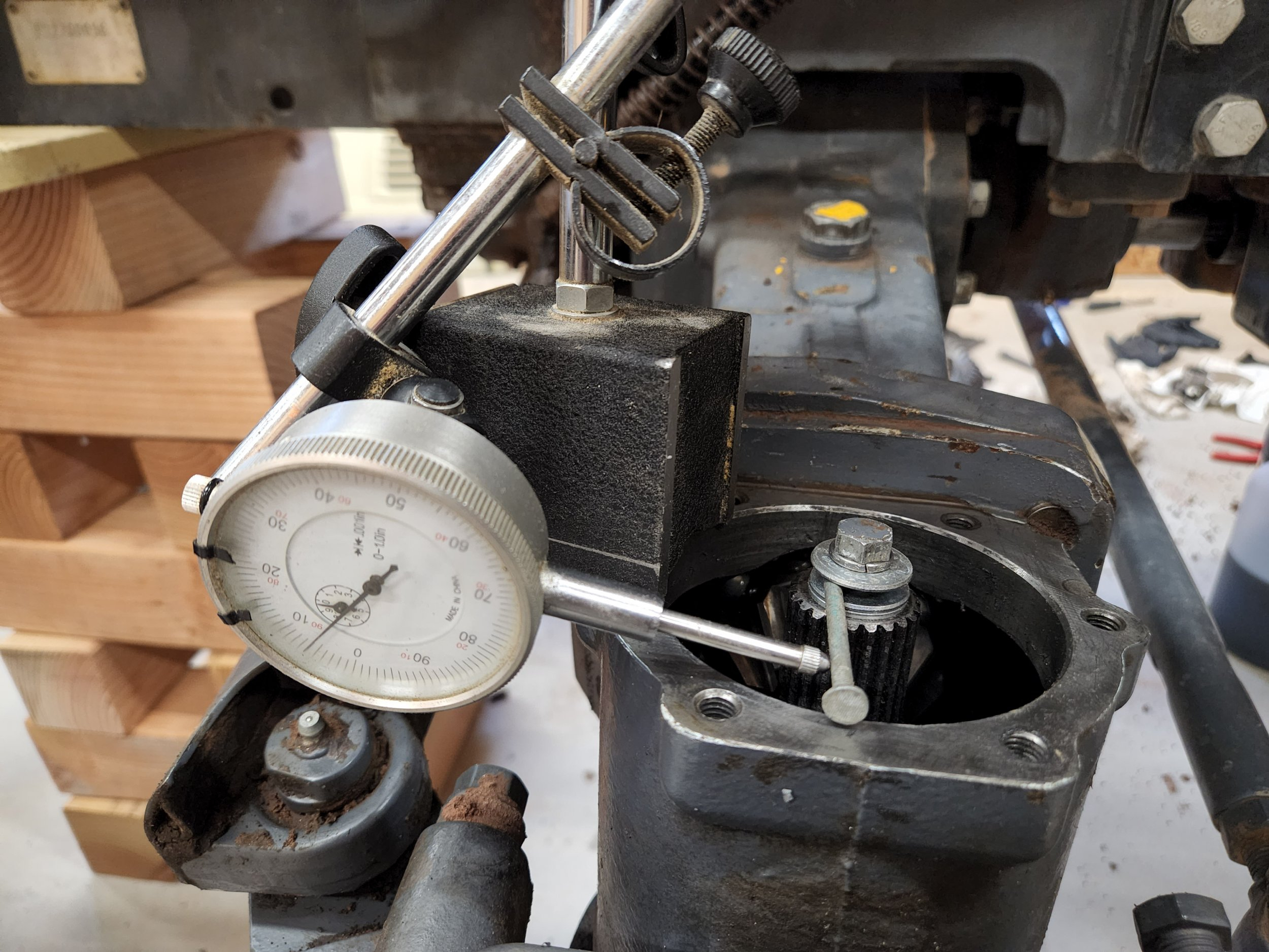

There wasn't much online about setting these bevel gears up so I figured I'd post my crude methods. I know the widths are not the same between the gear I'm measuring from and the gear doing the actual movement. The width ratios can be worked out; use your best judgement.

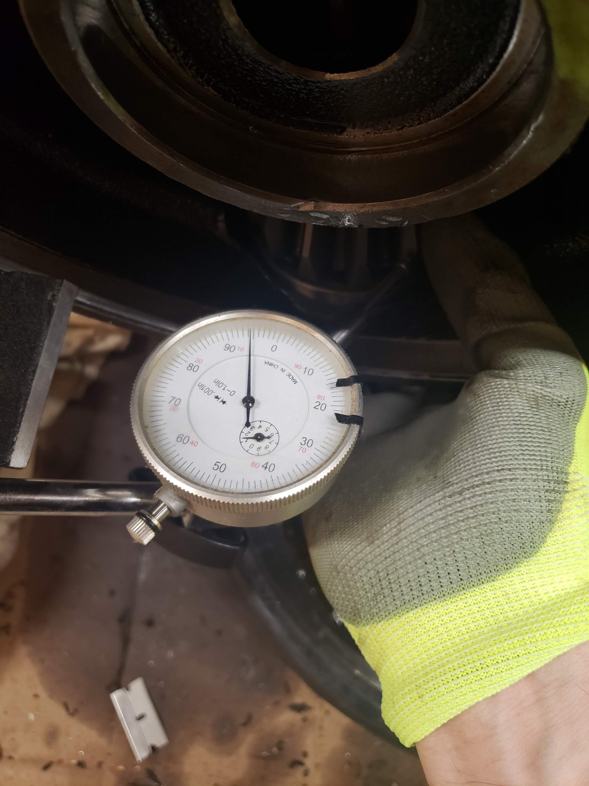

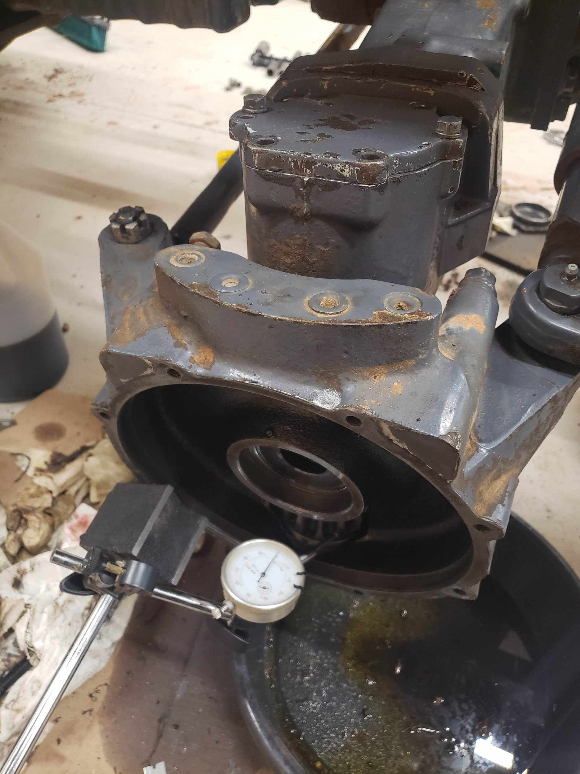

For the top bevel gear, I measure the backlash from the bevel gear that interfaces with the wheel gear. On this tractor the top bevel gear can be seated against its shim by pushing the shaft from the bottom of the axle. I tried to get a picture... This ended up with ~9 thou of backlash with an 0.8mm shim on the left and 8 thou with a 1.0mm shim on the right.
For the bevel gear to wheel gear I used caveman techniques... If I were doing this at a period in life where I didn't have 3 young kids, I would turn a shaft to thread into the drive shaft and make/bore/hone a bearing plate to hold the drive shaft for measurement.
Instead I used a nail and some judgement :D. It actually went better than it looks, finished with ~10 thou with 1.2mm shim/1.6mm shim L/R.
