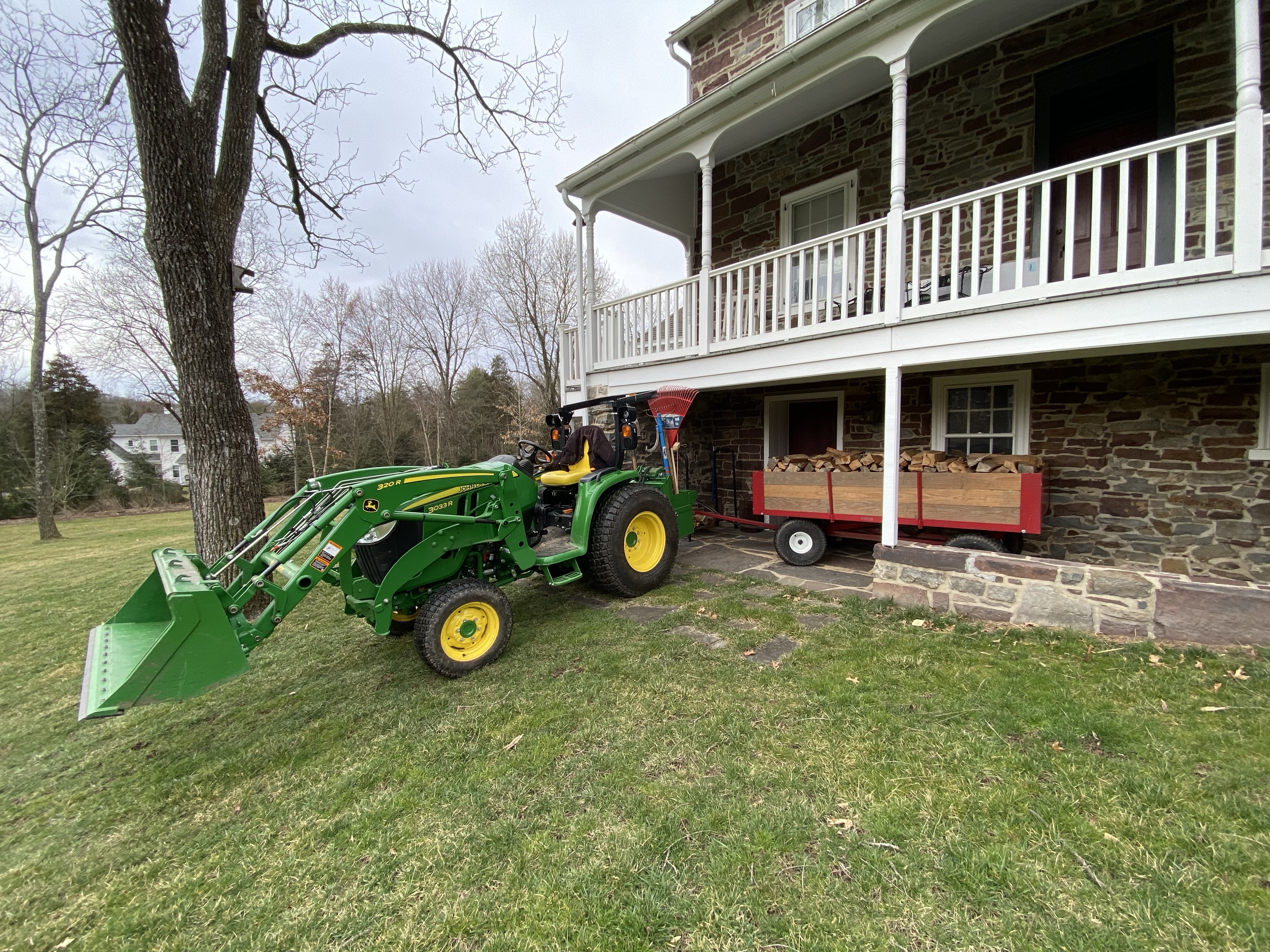

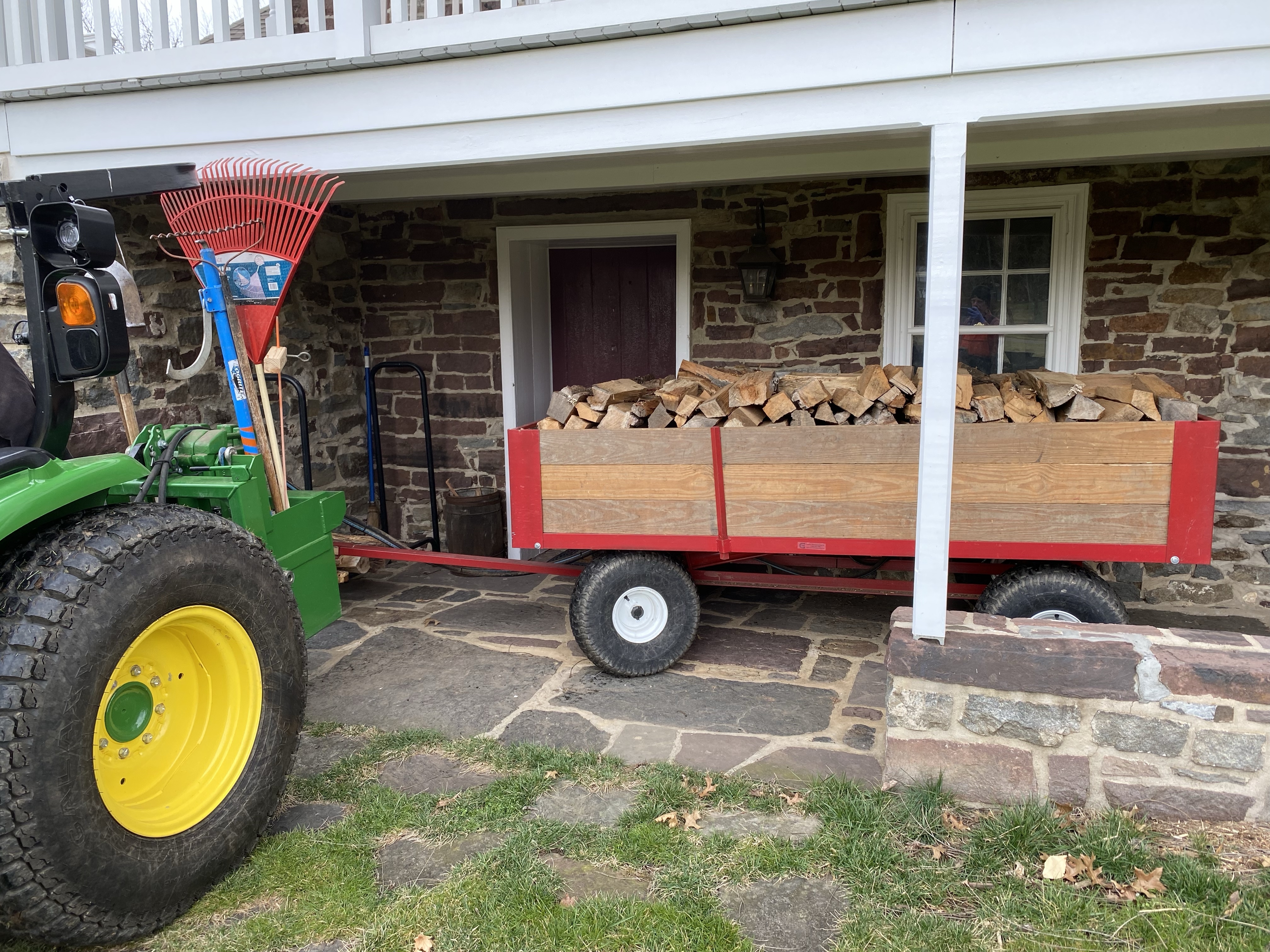

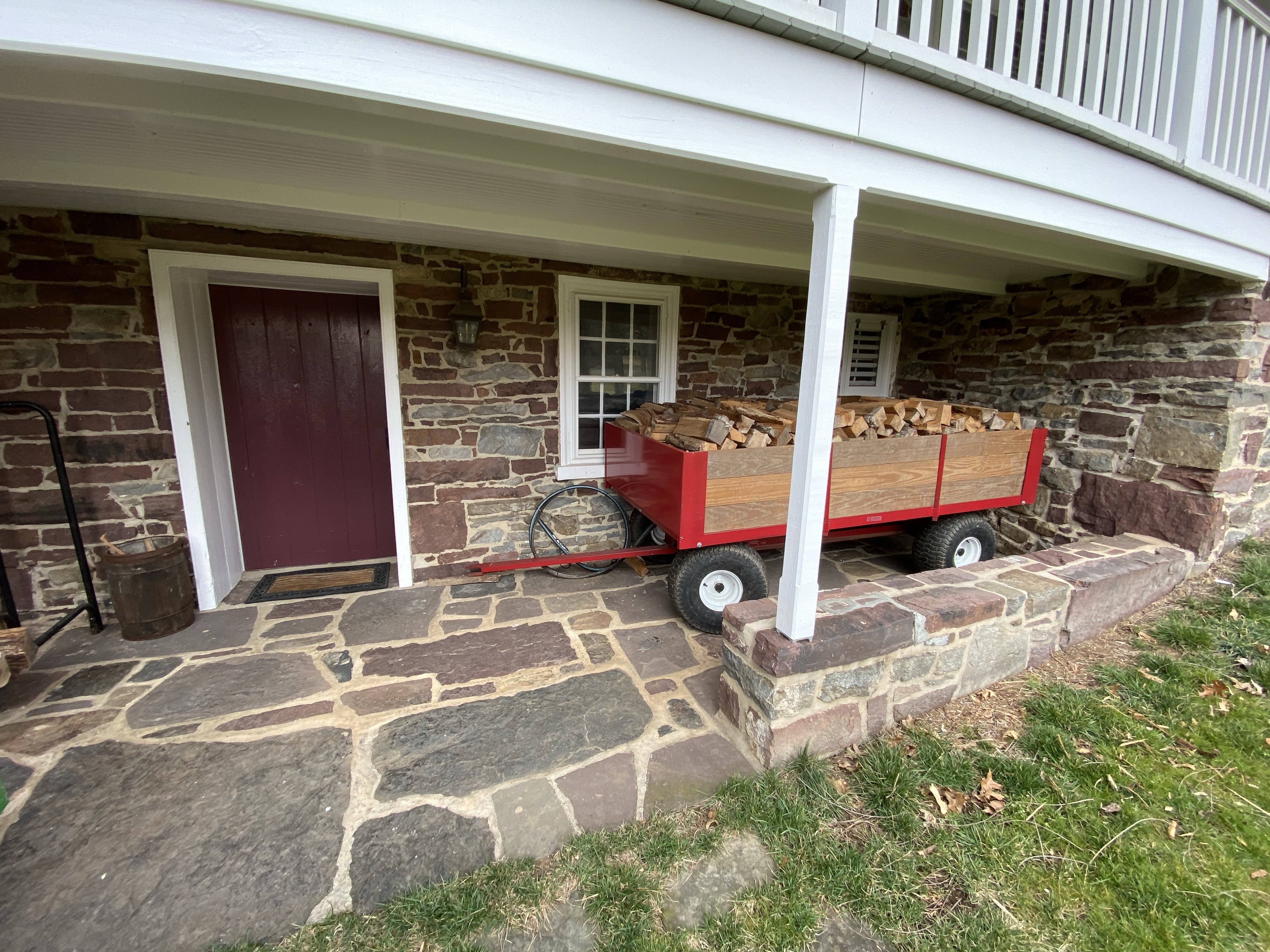

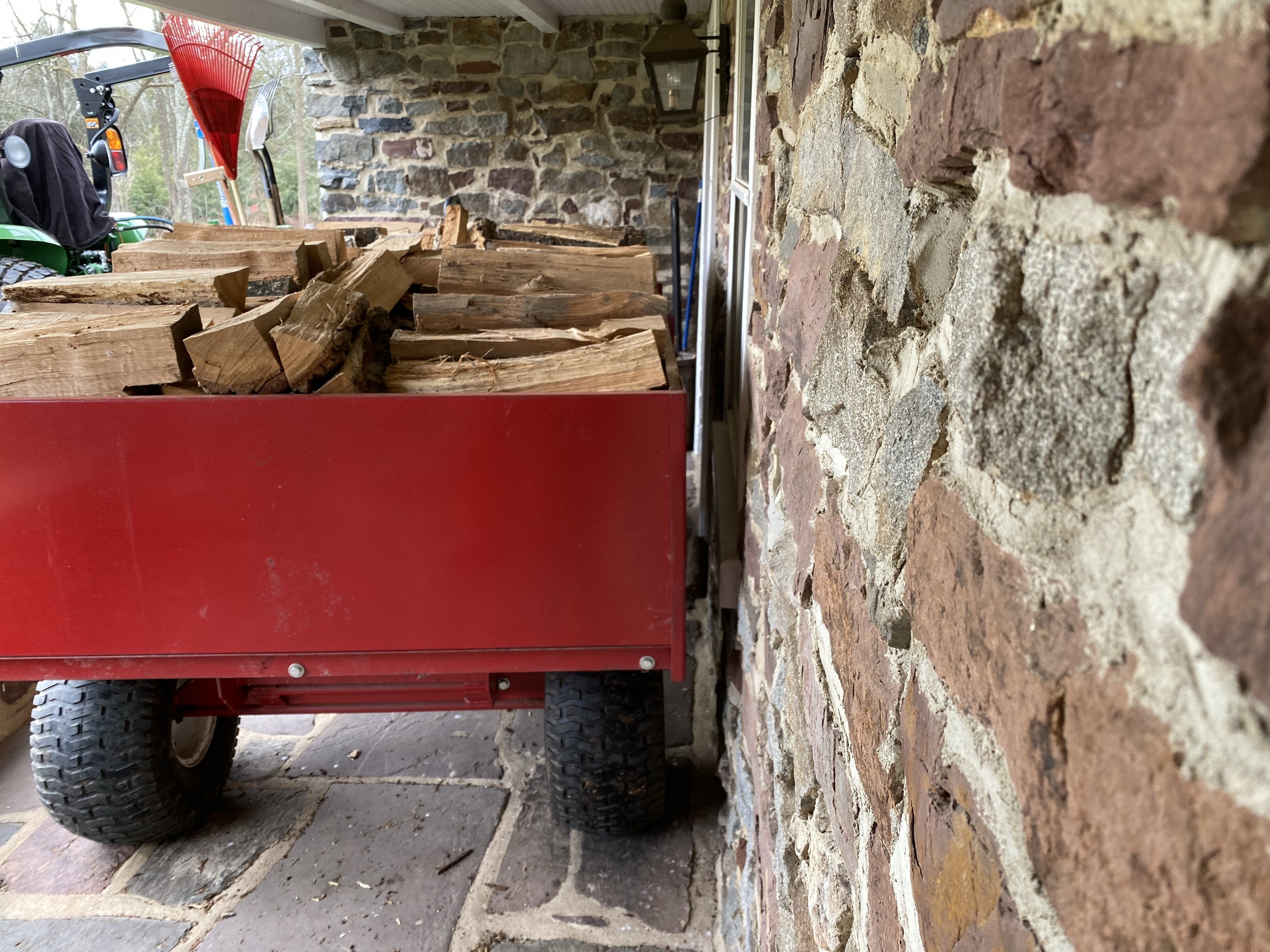

A log splitter or small utility trailer behind your CUT is a great aide in learning how to back a trailer, as the tractor offers better visibility. That's how I learned as a kid, anyway, and I can back a 20' trailer thru a slalom course at speed.
When you get good enough at regular trailers, then you can mix it up with a steerable wagon, which reverses everything, again! Jacknifing this one onto my patio every second weekend is like threading a needle.

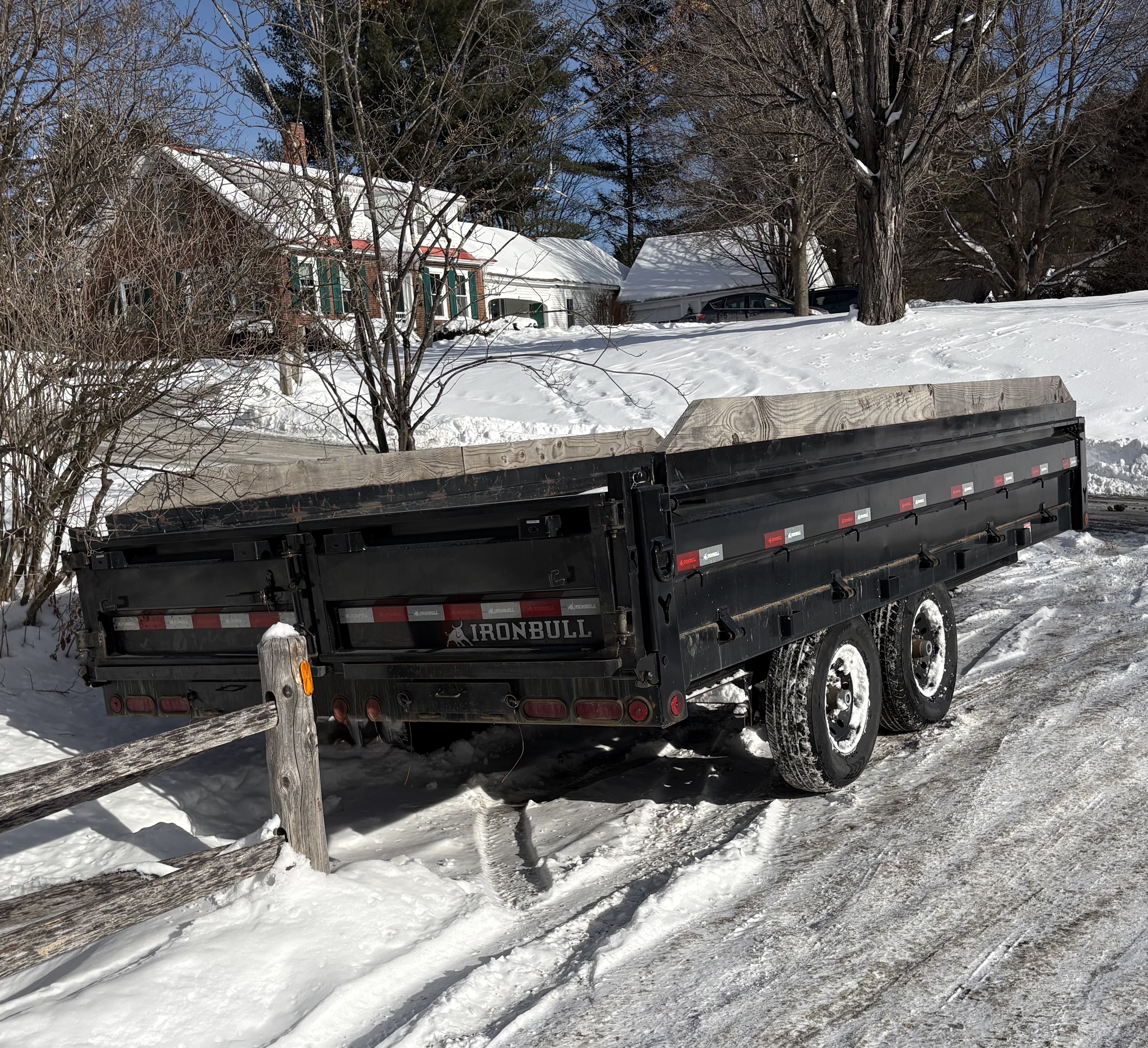

The trailer is a ‘24 Iron Bull 15k 7x16 dump with drop sides. It would be right at the max bumper pull for my f350.
The fellow I got it from had added a hydraulic jack and welded sleeves for 8” sideboards and used it only momentarily before buying a dump truck for his masonry business, so it looks pretty new except for a couple of spots where the paint is peeling (leading edge of the tarp cover for example).
I drove about 3 hours each way for it. I could have bought a ‘26 from a dealer 90 minutes away for about $1000 more but it would not have had the add ons and I felt they were valuable and worth the trade off.
Anyone know whether it’s worth using a rattle can of rust-oleum on those spots where the finish is flaking?
Yes. I always try to stay on any chipped or damaged paint, either with rattle can or a small can and brush. Anything beats rust!
If you can rig up some quick cardboard and masking tape to isolate an area or panel from overspray and properly prep it with a little synthetic wool scuffing, you'll thank yourself 2 years from now, when that overspray would otherwise turn matte and possibly peel. Sometimes I'll even just mask off a little 1" square around a chip, to scuff and rattle can that, knowing the paint line will be much less visible than a massive area of overspray, after a few years' weathering.
View attachment 4889056 View attachment 4889058 View attachment 4889057 View attachment 4889059
That is a great firewood setup.
