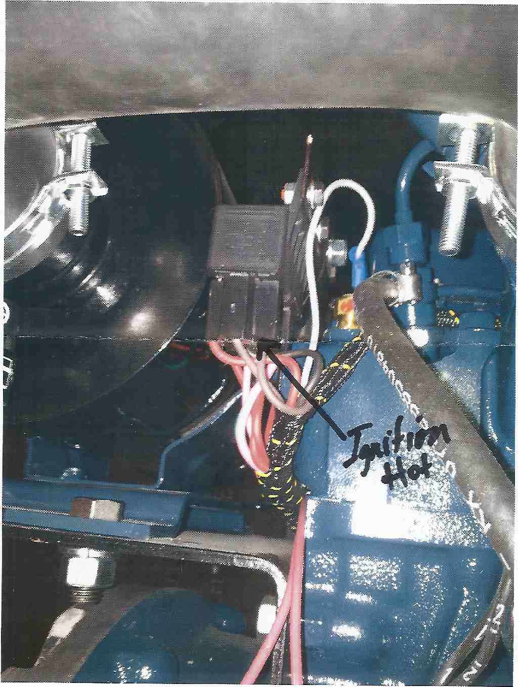

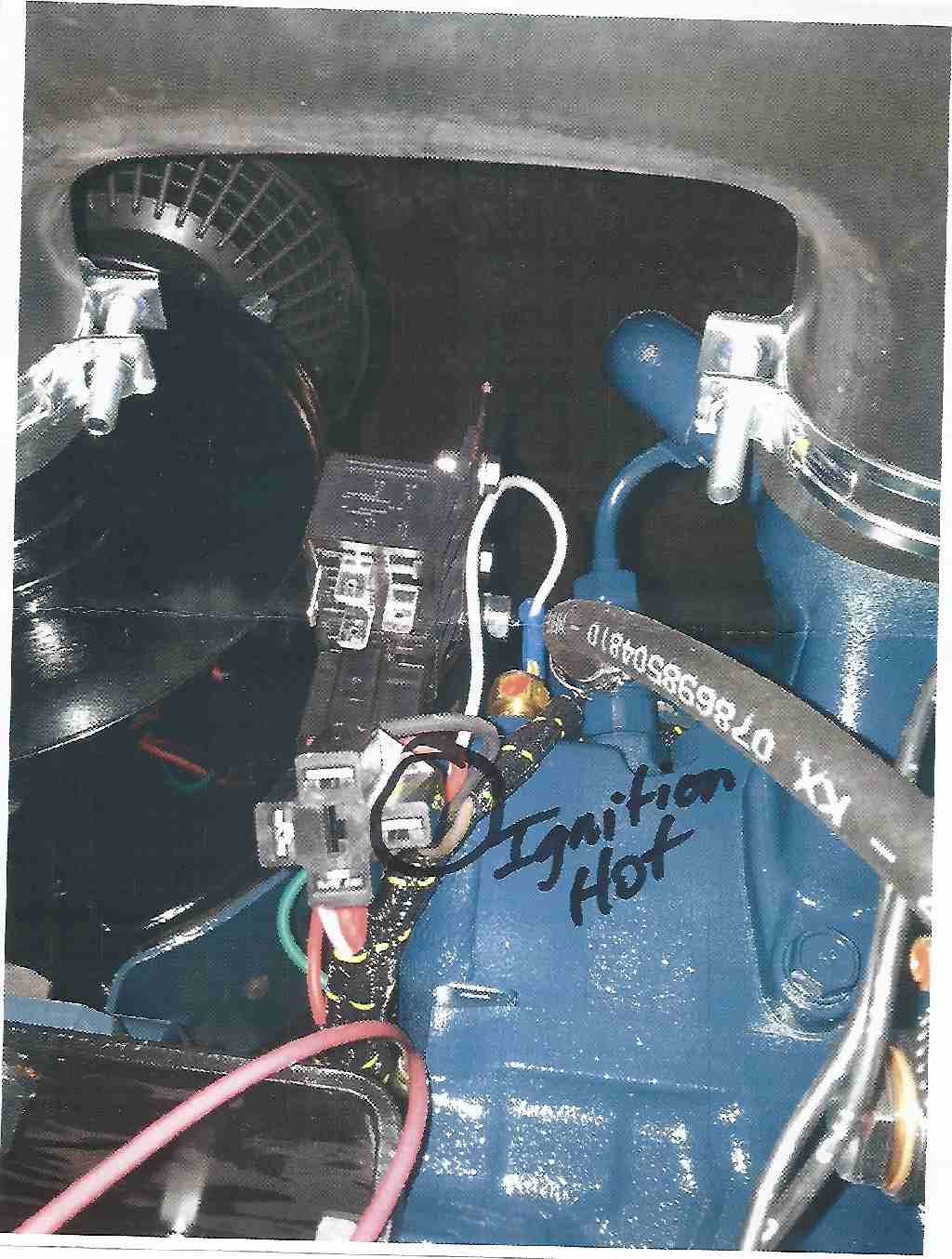

Not certain if this is the best sub-forum area but will try.
I have a need to tap into a wire that is "ignition hot" off of a relay on a piece of equipment. Purpose is to run an aux fuel boost pump on a diesel engine. The OEM manufacturer told me that I should tap into a specific wire which goes into the relay output (50 amp, 12V). The problem is the wire that is outside the wire harness at the relay plug has less than 3/4 inch of available wire from the harness exit point to the plug.
I am not a fan of wire spice taps but there is not enough room to get one on it anyway at that location.
They (OEM) told me to just cut into the harness to get more wire available.
I want to avoid cutting into the harness if I can, so I thought I would turn to the collective knowledge of the group as I am certain someone out there has either the knowledge to tell me that what I am looking for exists or does not exist.
What I am hoping to find is if there is an adapter plug that can be plugged into the harness (female) and then into the relay (male) that has terminals or some such that I can connect to without the OEM's method of cutting the harness.
I have included a picture best I can of what I am taking about and the orientation of the plug/relay connection. The OEM sent me the pictures to show the location and wire. In the picture the harness appears to have more available wire than does my harness or it is an illusion.

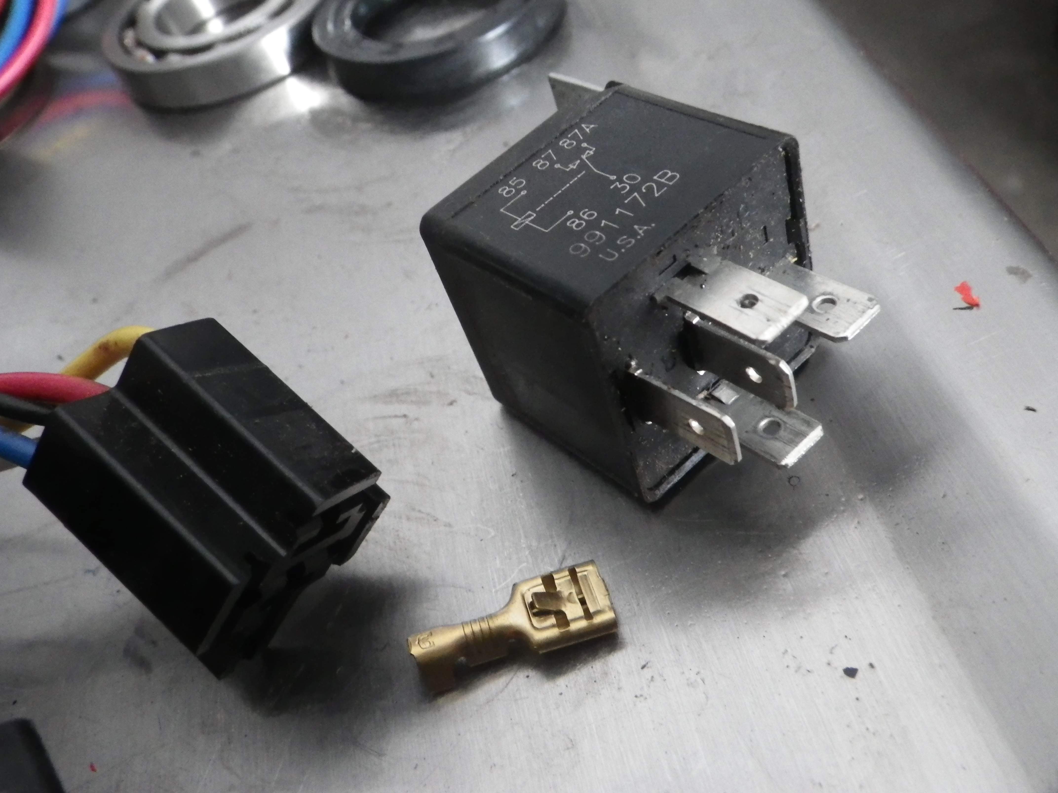

It's a 5 minute fix with just one wire and a new relay to replace the one you now have. You can buy a relay with 5 spades and utilize the blank slot in the socket already installed on your engine there. The only downfall to this is that the wire you install in the blank slot will only be powered off the relay.
Cheap and easy. The picture I posted shows the wrong relay, the relay you need has 87 and 87B ganged together. This one toggles between 87 and 87A.
Here's the one you need:
