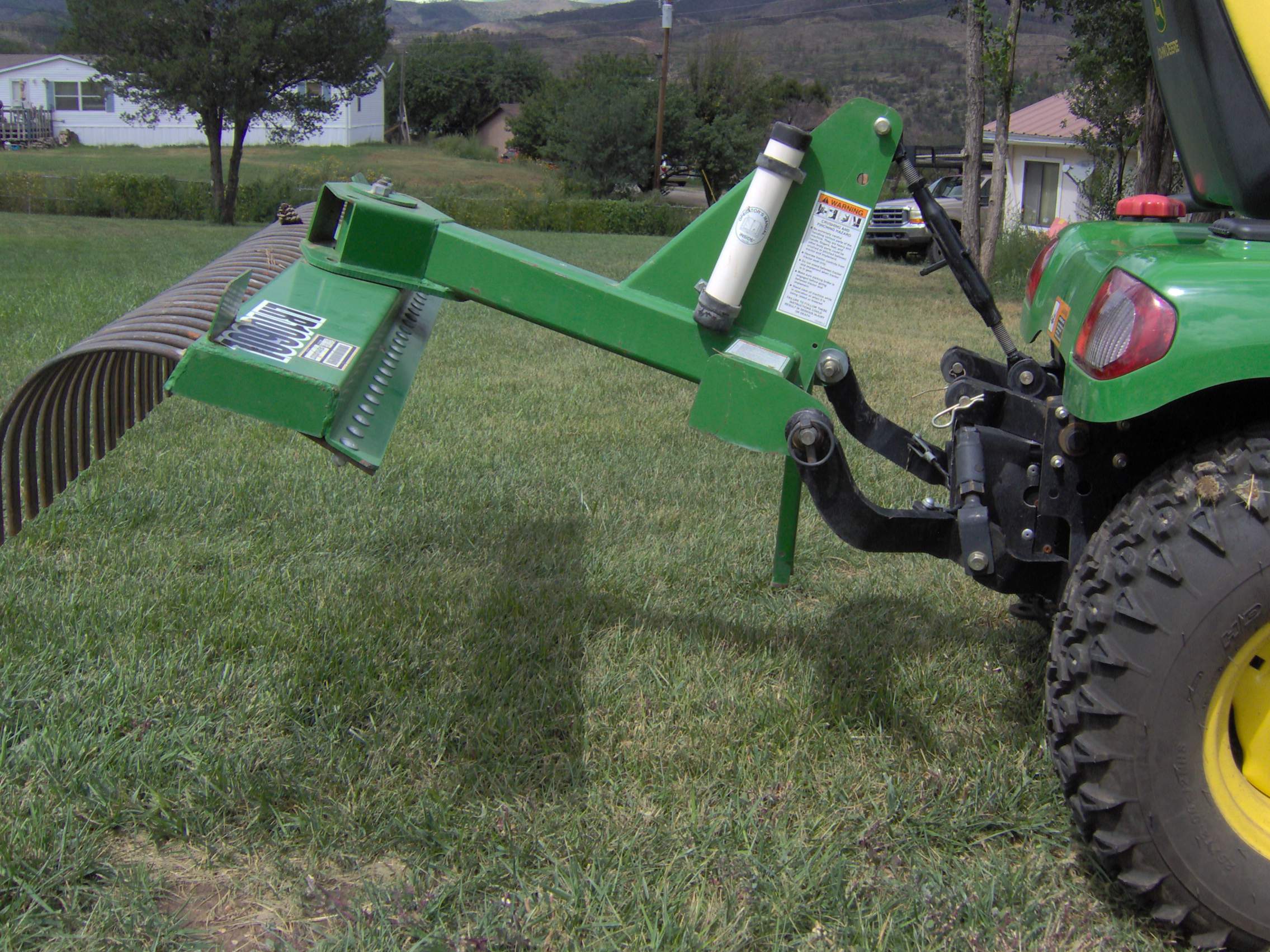

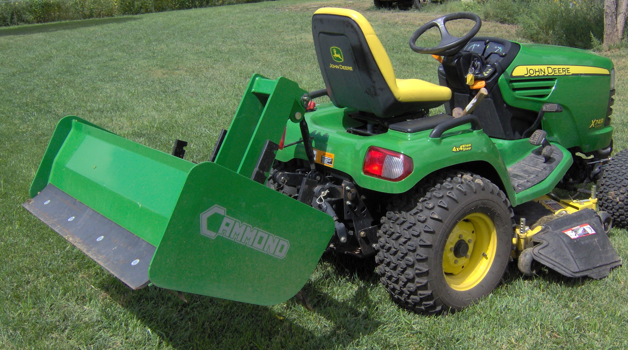

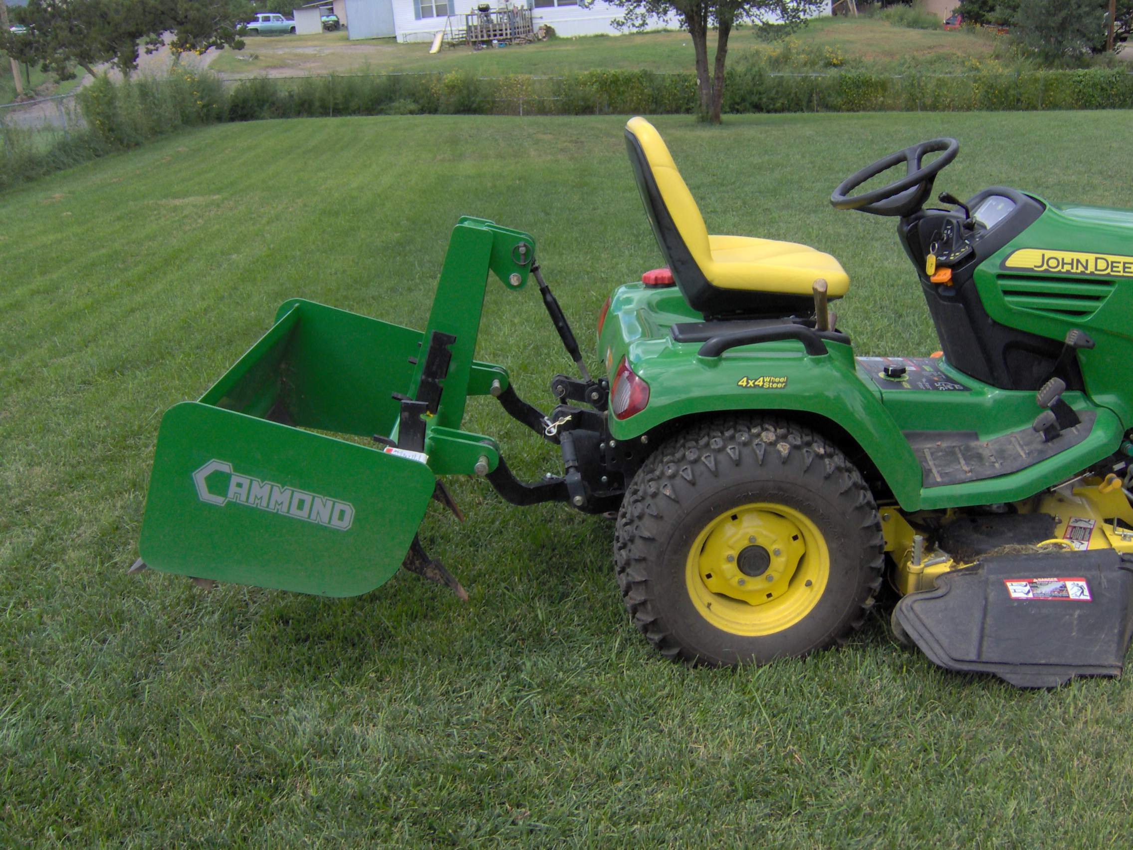

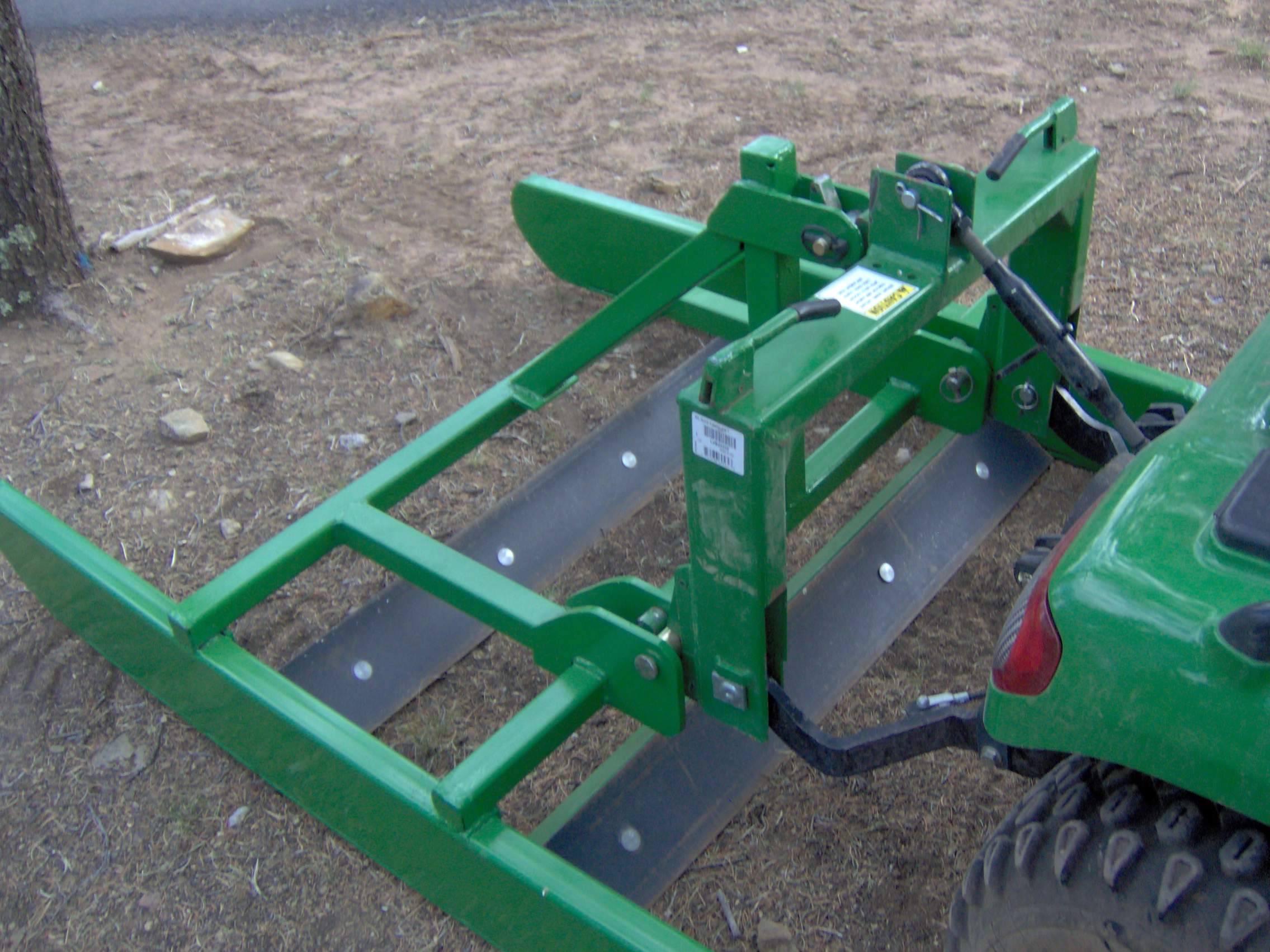

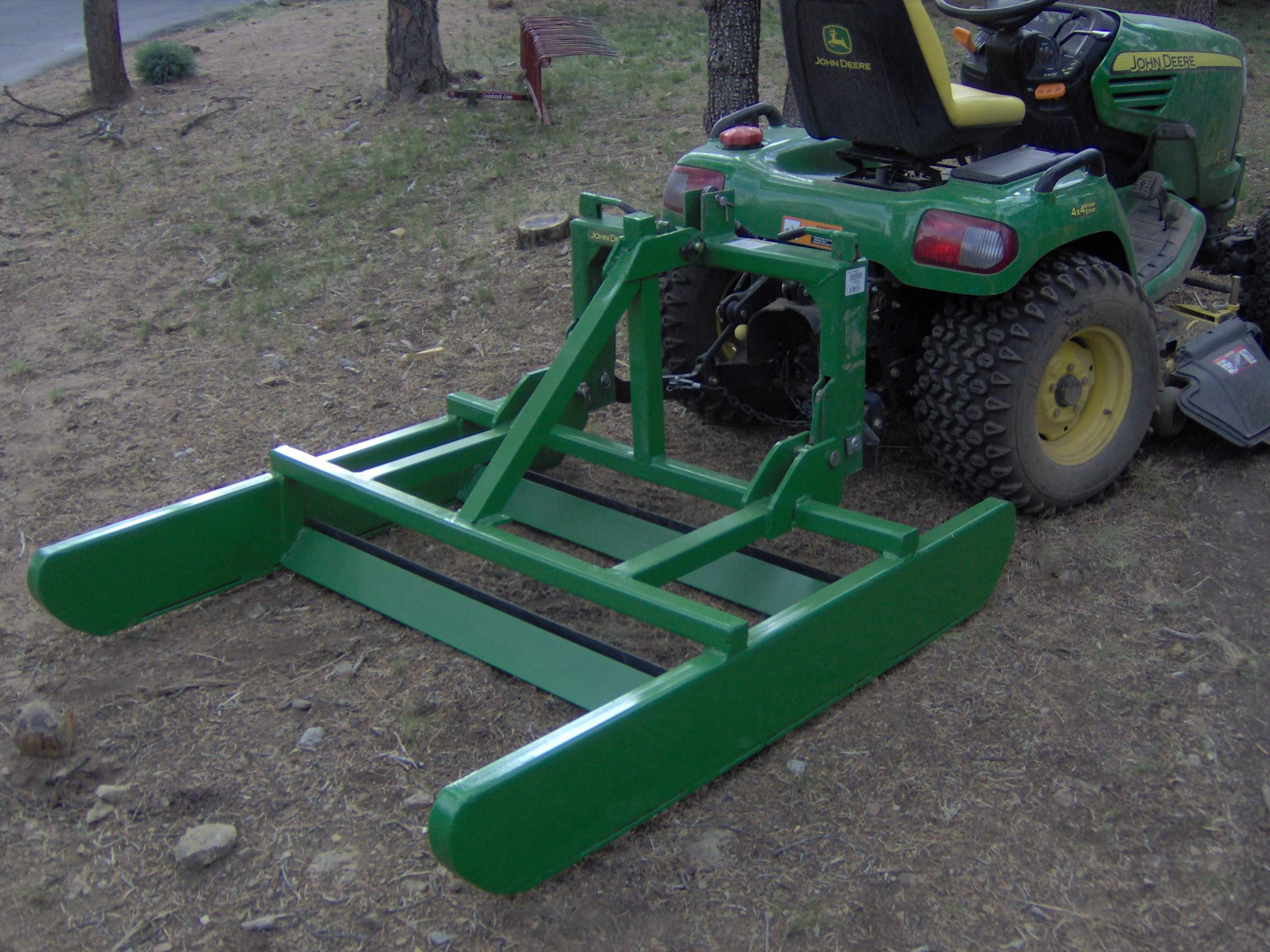

Here are some pictures of cat 1 implements on my x749 before I added the I Match quick hitch. Soon after these pictures were taken I added another IMatch as shown with my home built land plane grader scraper. Note that there are no cat 0 pins on any of these implements as all are cat 1. I don't see any problems with lift height either. I have many other implements for this mower not shown and they all seem to work pretty well.
Really nice rig!
Have you had any issues with the rakes picking up too much dirt?
I don't own a rake but have heard guys mention they fill up with dirt too quickly unless you take tongs out, from your pic, looks like a successful pass.
Another thing that comes to mind is ballast, box blade weights quite a lot, are you running any front weights?
I have seen guys run the little suitcase weights on the front of there x7xx's and they think it helps with stability.

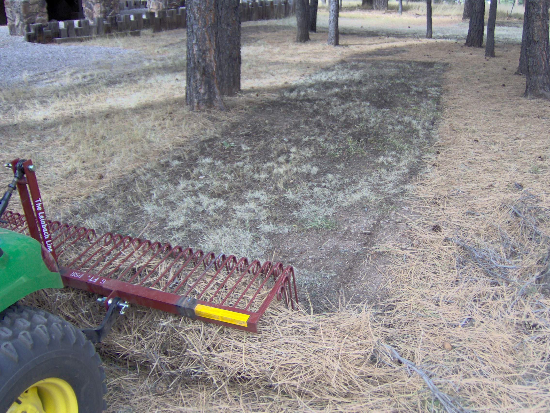

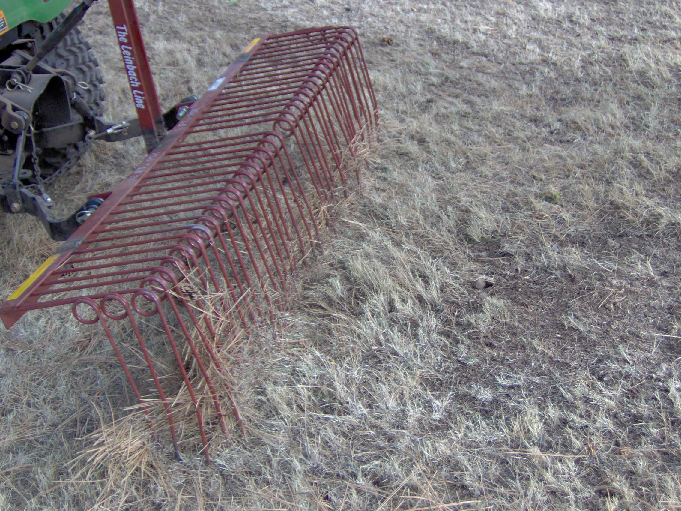

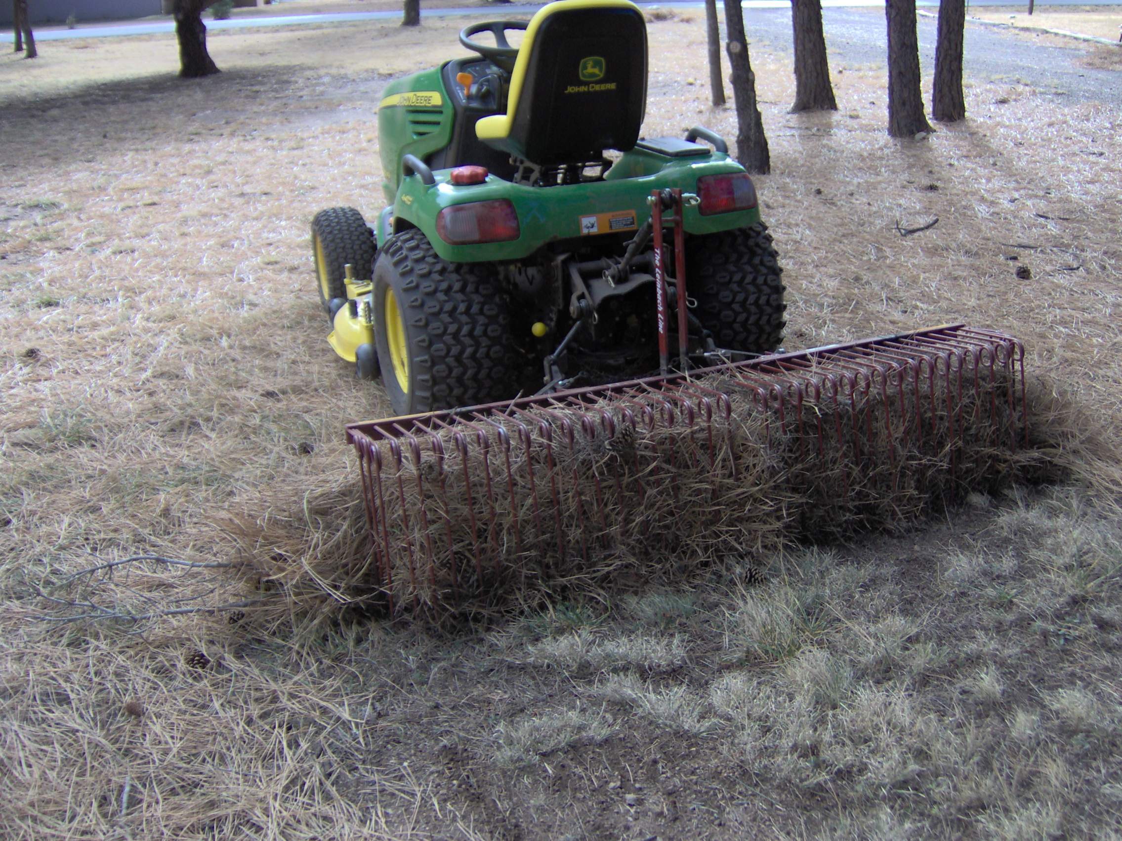

The pine straw rake really does a great job, doesn't seem to hurt the grass but does a great job with the needles. I will add more pics of it so you can get a better idea. It does not gather dirt to speak of. Everything Attachments makes a nice PSR with replaceable tines I plan to order a new one soon.
The landscape rake will gather dirt as you mention above but is more aggressive than the PSR. Just depends on what is needed. Right now I have a 7' landscape rake with every other tine removed and the 5' pictured above with all of the tines in place.
I have the 42lb. weights for the front they make a big difference with heavy implements on the rear. Four weights adds 168 lbs. to the front and that is easy on and off.

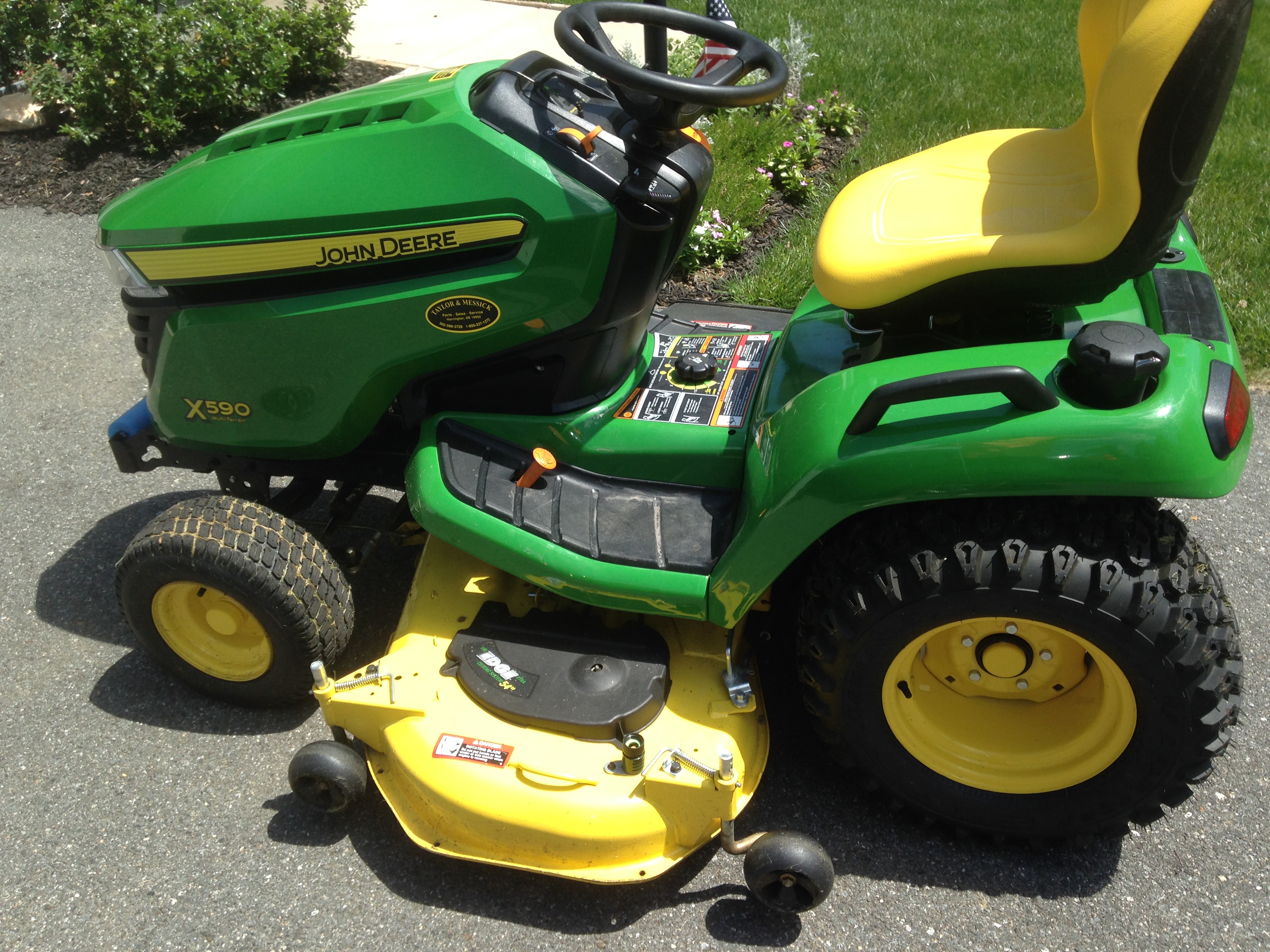

Thanks Crazyal for the extra info on the differences between those two model transmissions - was trying to look for them online but no luck!
I really do like the X590.. looks to be a really nice machine and very close to the X730 (well - if you don't consider the K92).
Trying to be conservative as possible here and get the best bang for the buck and the best tractor for my needs.
People asked me if I'm going to spend that kind of money (4000-5000 maybe?), then why not get a zero turn? I asked them.. have you tried mowing my slopes/hilly terrain?? According to my research.. if you want to get a zero turn that can handle hills/slopes and side mowing slopes, you need to get those high dollar commercial grade ZTRs which are a ton of money. I'd prefer to not lose control going down hill nor flipping backwards while going up hill because I sure as heck cant afford a $12k zero turn. I'm not doubting ZTRs, and I usually see commercial businesses use them, but my terrain is a big dangerous and I would also prefer to have a transmission that can handle anything.
The X590 will handle any terrain you have. I've used my 590 on some steep hills and with HDAP tires did not even have to use Diff lock- although it nice to know its there. In fact only times I've had to use Diff lock is with snow. The EFi option is really nice; tractor starts with turn of key no matter how hot or cold outside. The constant speed governor is also nice, tractor does not bog down no matter how steep the hill or thick the grass is. You will also enjoy power steering- I never thought I needed Power steering (and I did not) but once you have it, I would never own a tractor without it again. Fairly easy to service transmission and change tranny oil and filter. Option to add more implements over time ( 2 stage snow blower. Tiller, hydraulic sleeve hitch etc etc ) - 4 years bumper to bumper warranty John Deere promise- a lot to like in that package. If you are considering going that way- get to John Deere dealer today- 500 dollar rebate expires at COB today
Good stuff Smoothas. The more I read up on the X570/590 the more I want to buy one. So currently, on my L130, sometimes when going down one of my steeper hills hill, the tractor will just roll down at FULL speed and I cannot control it with braking (foot is off the gas). Mind you yes they are steep, but ive seen much steeper hills which people can handle with bigger machines than my L130. When I try to brake, it actually makes it go faster down hill and doesnt slow. Does this also happen with the x590? I would think not.
I am def interested in the implements, especially the tiller, cab, plow, blower, etc. I really like the fact it has the hydro lift on it. Part of the reason why I dont want a zero turn - because I can do much more with a tractor.
