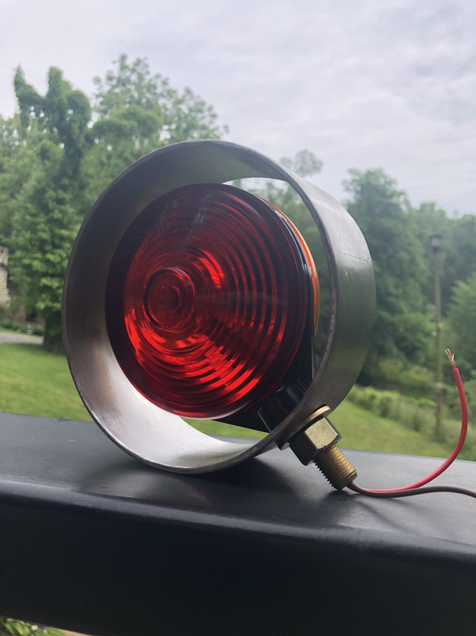

Something knocked off the leading left signal light lens yesterday on the B2601. I've seen grills for these. Where does one get them?
Guess it's the dealer for another lens? Messicks?
Think some have replaced bulbs with LEDs. Source? Work okay? On our old 1983 Benz, its signal light system would not work with LEDs.

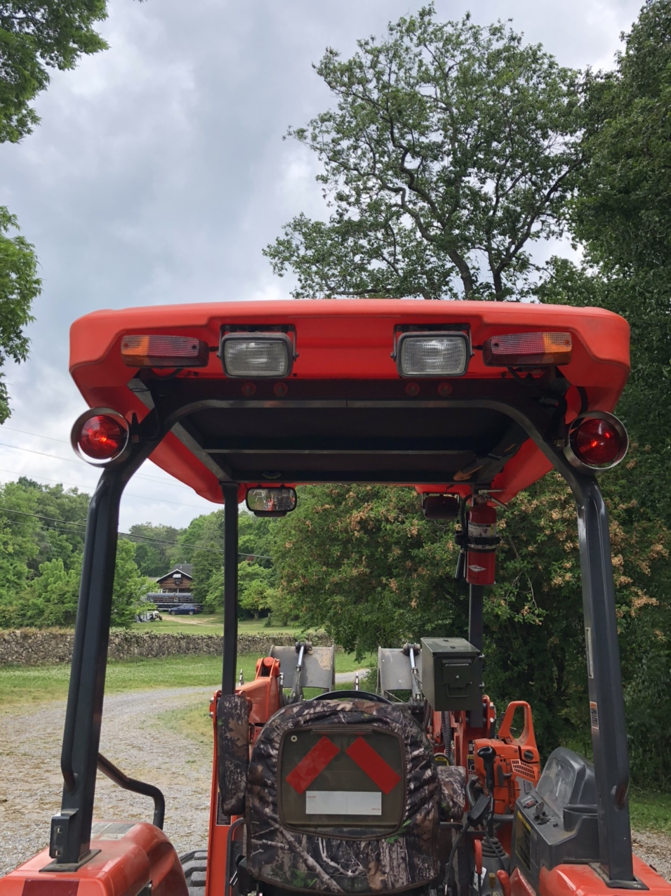

On the 3 JDs, I moved these lights to inside the ROPS. Twas easy to do on them. Just unbolt and pull wire connectors apart, label, and move to inside. Cannot apparently with the gizmo that these are mounted on.

I've knocked them off more than once. Kubota prices for replacements are absurd. Last round I found an identical unit (whole light assembly, not just the lense) at Tractor Supply. Cheap comparatively.
   / Lost lead lens on signal light #4
Light fixture $8 tractor supply.
Guard a piece of SS tubing.

No holes drilled in ROPS. Factory light positions.
Other unused holes in ROPS for options.

It will if you install a resistor in the light circuit. The flasher unit has to 'see' an amp draw to operate, unless you change it to a solid state flasher unit.
Far as the lens goes, I believe that will be a dealer item but you might want to search 'Stanley' with your browser. Kubota uses Stanley warning lights.
