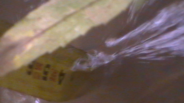

  4. the overflow on lake the end of the pipe, to creek, has eroded a 3 foot x 3 foot channel. and removing a culvert i had in place. causing me to loose access to front portion of pasture / wooded area.

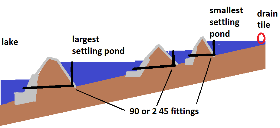

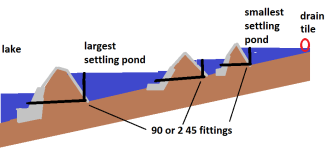

  3. putting in 3 settling ponds (mini ponds) into grass waterway to help slow down the water velocity, to reduce errosion and to act as a filter to let stuff sink down into the mini ponds. were hopefully my TLB with 8 foot of reach or so can clean the mini ponds out.

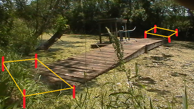

  5. dropping some additional posts at each end of bridge, to raise bridge ends up out of the water, and most likely a larger platforms (couple large size steps) to deal with gap between the bridge and hill side that is now there.

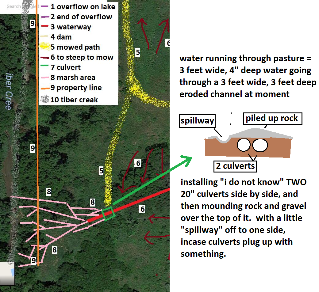

  6. installing a couple culverts side by side down in pasture. to deal with 3' feet wide, 4" deep water coming from lake overflow pipe, along with a spillway around it.

moss covering lake, a lot of it all blew down into bridge and to other side of bridge for these pictures.
bridge ends had 12" to 18" worth of dirt under them before drain tile went in.
dock also had 12" to 18" worth of dirt under it as well. vs lumber falling down into the water.

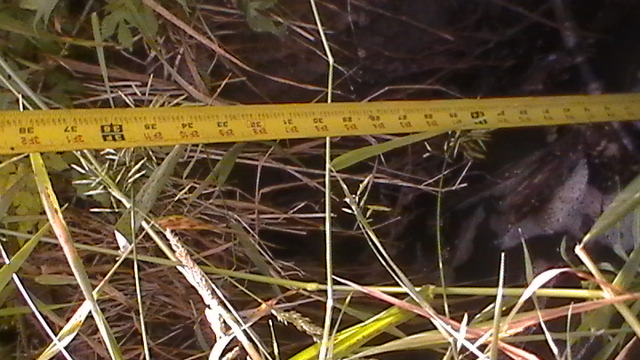

8.5" inside diameter drain tile pipe neighbors installed. rock = approx 12' diameter round end of pipe.

settling ponds
have yet to actually measure, just guessing at this stage
smallest dam = approx 5 to 8 feet wide, to 3 feet deep, 20 foot pipe going through bottom
middle dam = average between the small/large dam, with 20 foot pipe going through bottom.
largest dam = 50 feet wide maybe a bit wider to 8 to 12 feet deep, 40 footer pipe going through bottom

#9
approx 1 to 1.5 feet step from hill to bridge. once bridge ends are re-raised out of water.
showing very ugly drawing of min 4 more posts, and a large step or steps being added.

down in the pasture. the culvert. washed out completely. i do not remember what size it was exactly i want to say either 12" or 15" pipe i did have in place.
looking at 2 smaller size culvert pipes. to deal with area. and then needing to pile up dirt/rock over it. in order to obtain enough "depth" of material. so i can drive over it, without crushing the culvert pipes.
have video. best i have for pictures taken for showing depth of water and width of sheet of water flowing through area.
