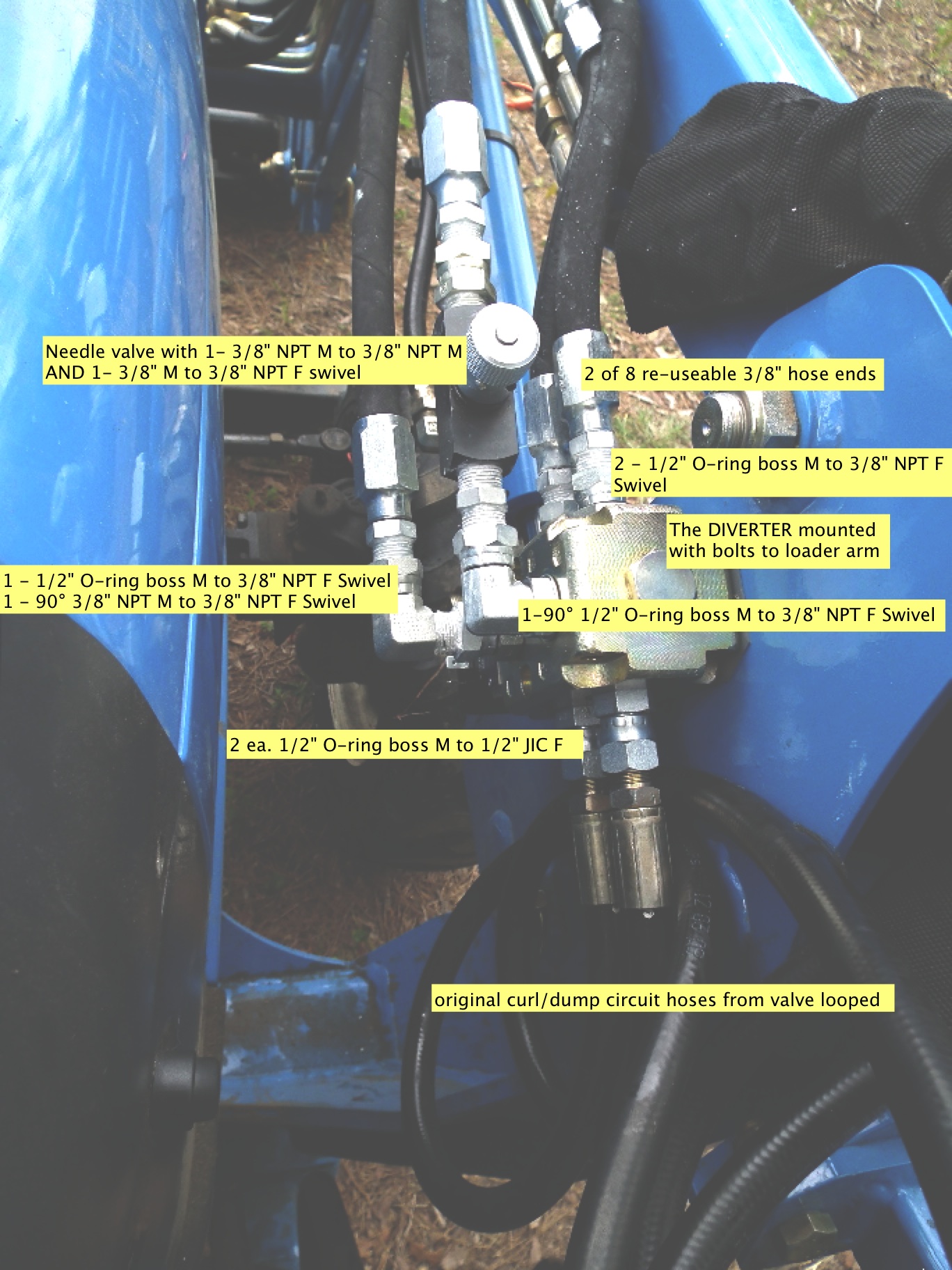

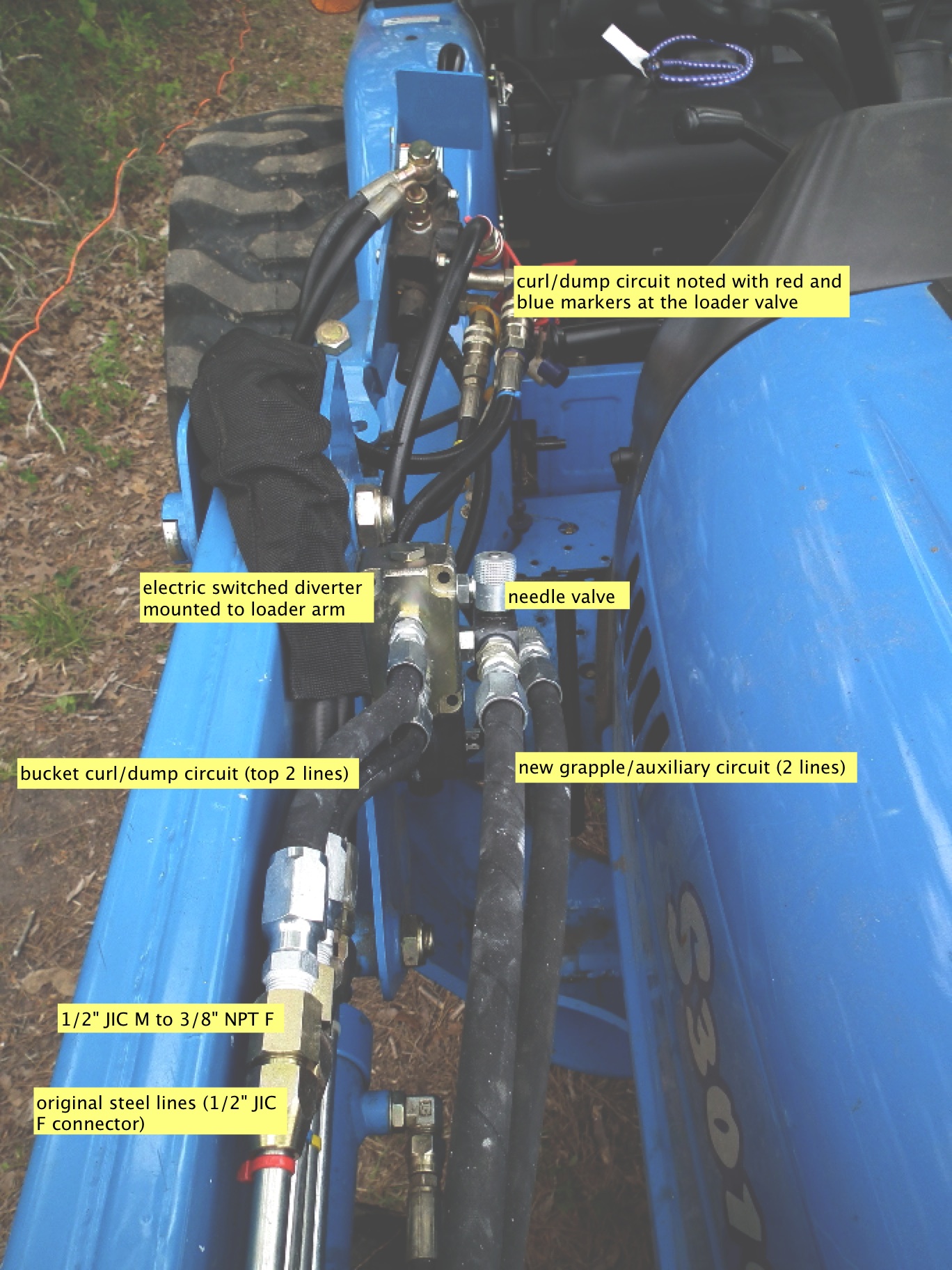

I've been trying to gather the parts to add a diverter to the loader curl circuit. That would give you the third function you need on the FEL for a 4n1. Discovered I still don't have all the CORRECT parts during a dry fit last weekend. You might want to wait for me work out all the details before you decide to go in that direction. It's been a challenge thus far (for me anyway.)
   / LS3010 Hyd 4 in one bucket? #3
Have any pics of it installed?

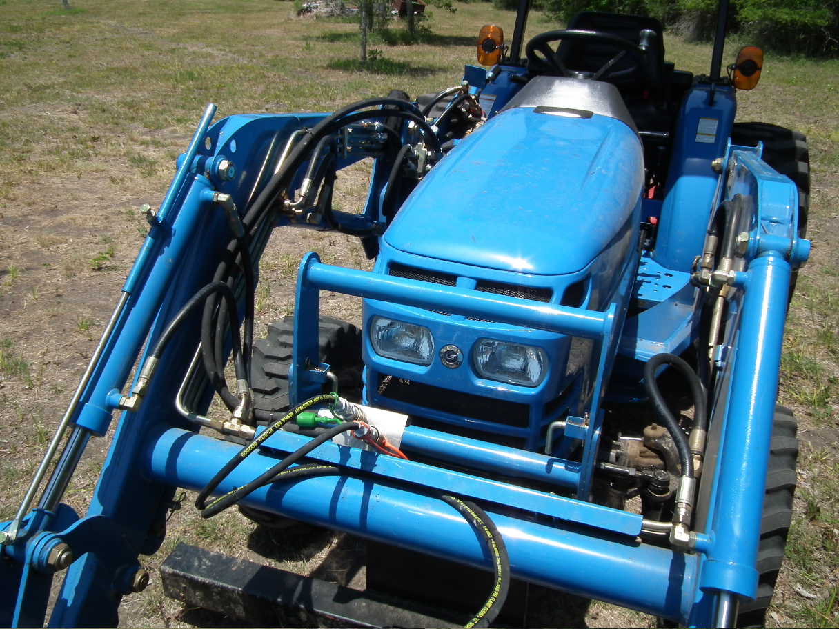

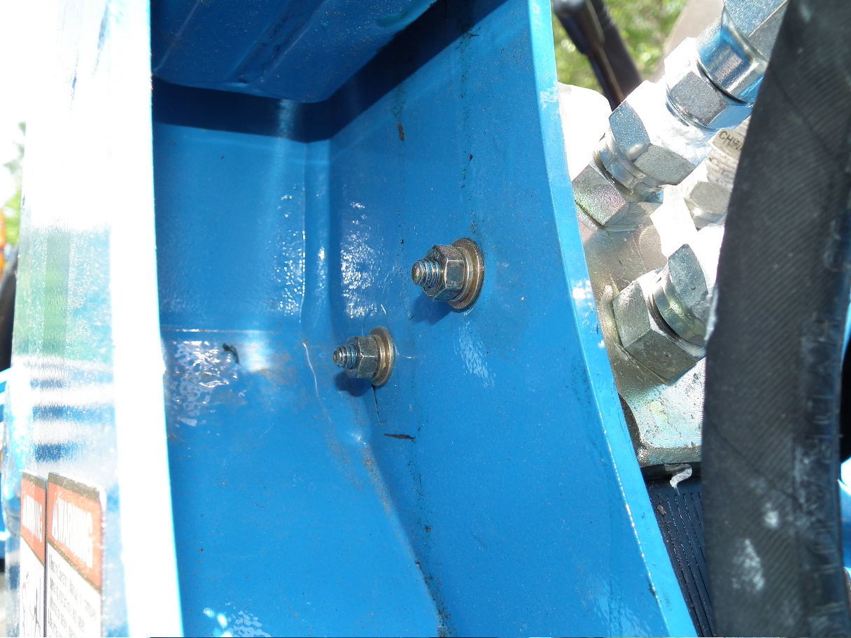

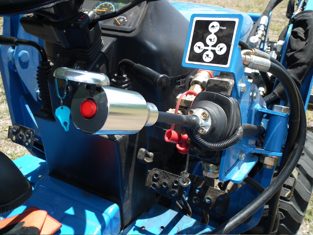

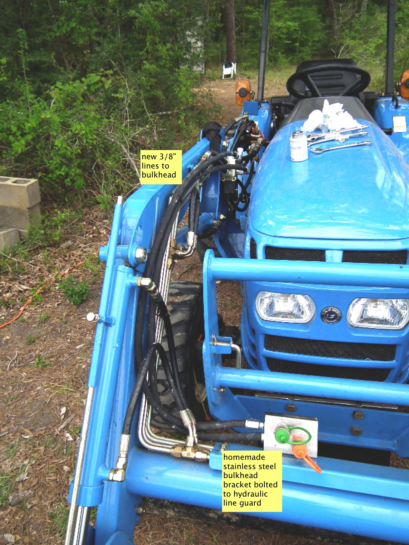

I believe I finally got the plumbing of the diverter right yesterday. I didn't get to installing the new handle w/switch, but as the curl/dump function is working fine I'm confident it's OK. It took me too long to figure out all the fittings, so I labeled everything for the newbie like me. I can post clean pictures if I covered up to much with all the annotations.
Be sure to check out kennyd's "re-useable hose fittings" tutorial before attempting something like this -- it was invaluable:
kennyd's tutorial
So why did I re-use the original hoses from the loader valve? Because if something goes wrong with the diverter it'll be really easy to go back to the original configuration.

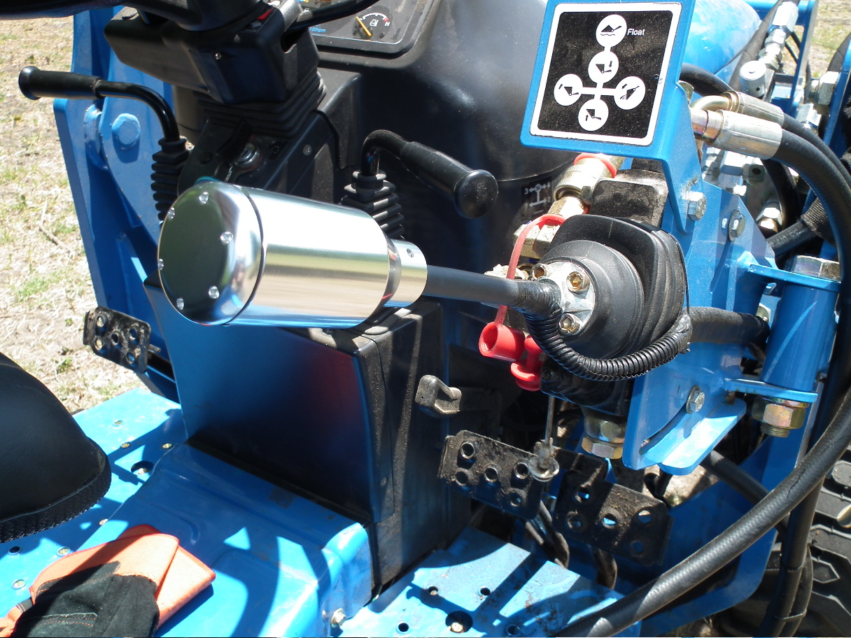

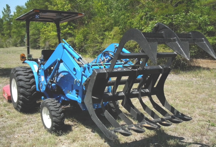

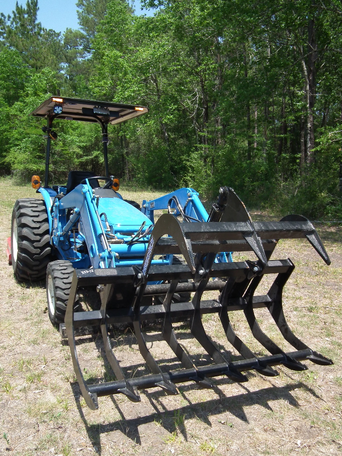

Thanks! Stay tuned for the electrical aspect of the project in a few weeks. Then maybe some pics of the grapple in action.

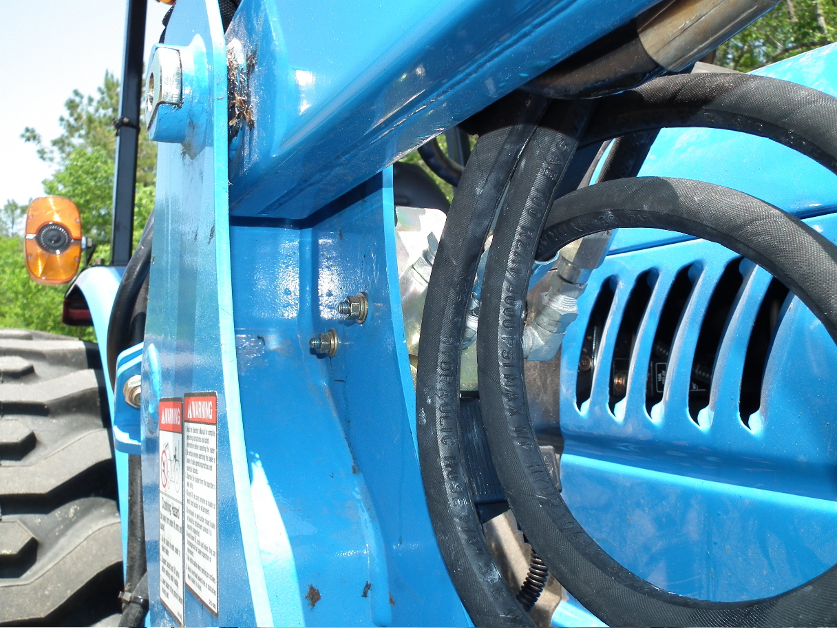

Discovered a problem with the design of my diverter install yesterday. The two short little hoses in from the diverter to the original loader curl circuit (in the picture linked to below) have to be longer. Didn't find out until I raised the loader arms pretty high. Looks like I'll have two use two looped hoses instead.
The problem is that the diverter is mounted on the frame of the loader. I would have been fine if I had mounted it to the arm itself. The distance between frame and arms changes more than I thought when you really raise the loader. Just wanted to make sure anybody trying to go in the same direction was aware of the issue.
I'll post a complete page about the whole project IF I ever get finished with it. Did the electrical switch part yesterday. Well, at least I can reuse the "re-usable" hose ends and I have plenty of spare hose.
