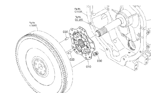

I agree with ptsg. The M5-111 has a damper assembly very similar to my M7040 that has no linkage(note photo below) to disengage it. As pstg stated pushing clutch pedal down just opens a hyd valve. When handling rd bales with FEL on my M7040 that I depress clutch pedal to help me handle bales more precisely but sometimes at low ground speed/low engine rpm's I shift reverser without depressing clutch pedal.
