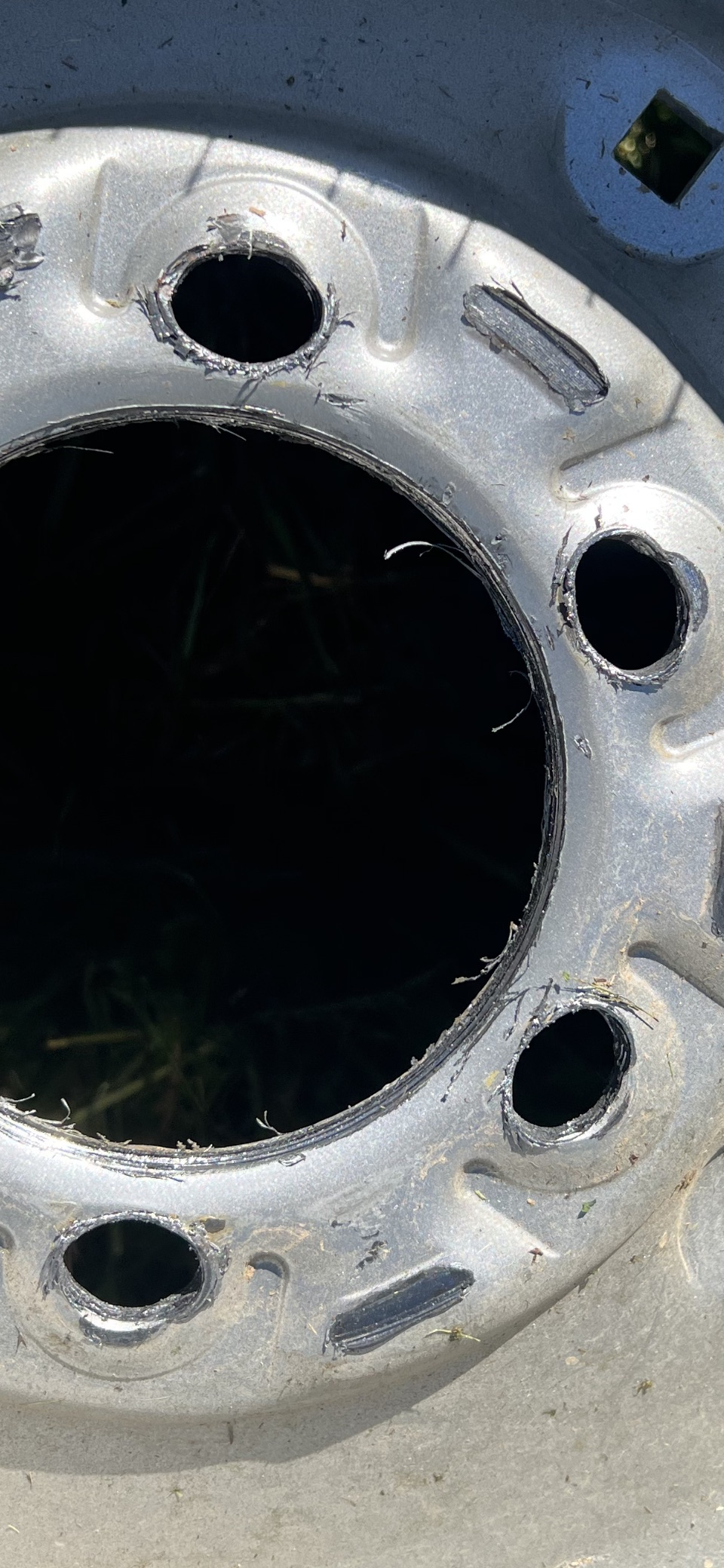

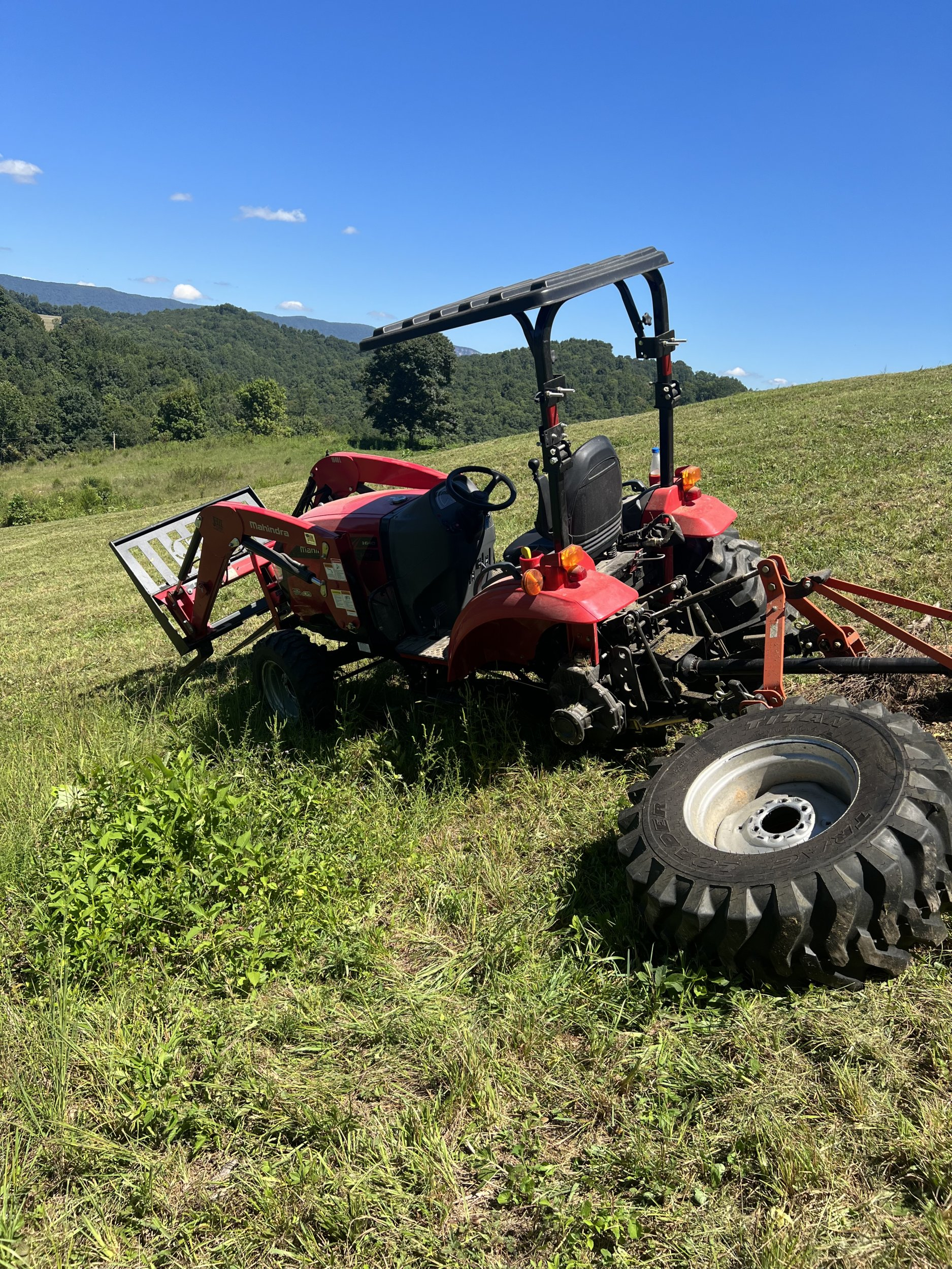

About two weeks ago while bush hogging my West pasture, the left rear wheel bolts decided leave the chat. Don’t want to discuss why 😆
Anyway - the 19.5 x 12.25 rim bolt holes were destroyed. Mahindra is way, way behind with parts. Anyone know of any other manufacturer or aftermarket rim that’ll work? This is my first foray into tractor rims.

Good luck with that and next time, check your lug nuts for tightness and torque them properly as they usually start making a creaking noise prior to exiting stage left...
   / Mahindra 1640 rear rim mess
Yes - I’m ashamed. I did a full torque check 53 hours prior. I should have rechecked. It never made a noise or shuddered.
   / Mahindra 1640 rear rim mess #6
Make a new flange and weld it in. Easy fix
