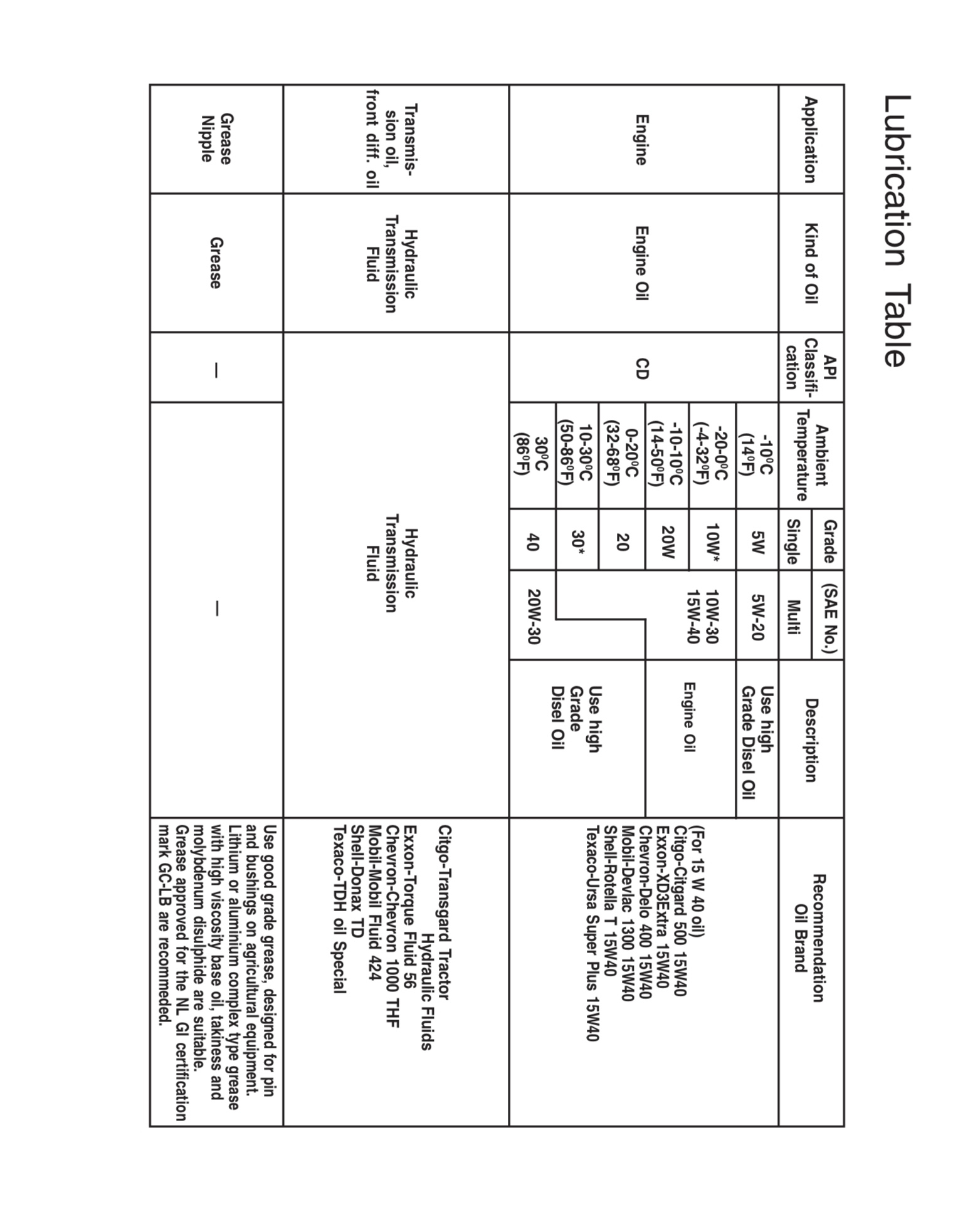

Mar 24, 2021 / Mahindra 2816 Hydraulic Fluid #2 RjCorazza Elite Member Joined Apr 6, 2000 Messages 3,022 Location Maryland Tractor Kubota L4060 Cab, ZD1211, ZD326 The manual lists the following...
