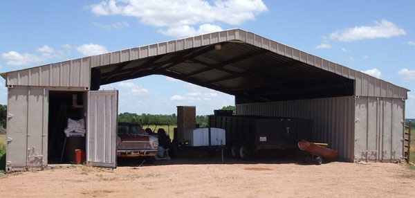

I currently have 2# 20' shipping containers. I just ordered a new 40' container, hopefully be here next week. I'm looking for ideas or pics of putting up a barn style structure up using the containers. I'd back to back the 20's for one side and use the 40' on the opposite side. I was thinking about getting trusses for a roof system.

No matter what you do, create a roof with trusses as otherwise it will become a hot humid oven and rust all the contents. Create some openings to have ventilation as well. Otherwise a great structure that can be very secure.
If you plan to heat as for a shop the only option is really foam and then a standard wood structure is probably more economical.
