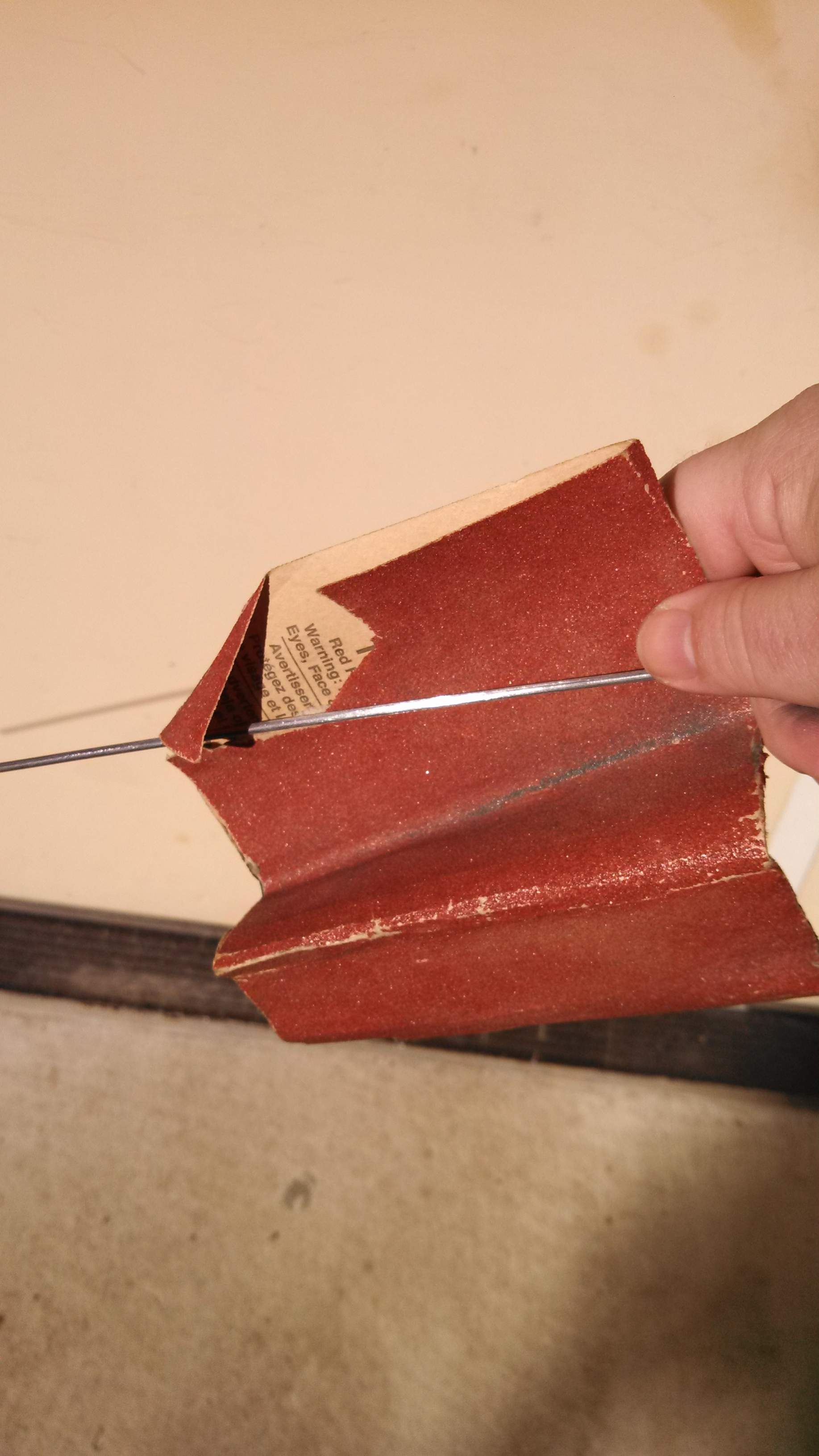

First I took some hanger wire, originally intended to hang ceiling tile grid, and sanded off the coating. IMG_20131018_100930_781.jpg

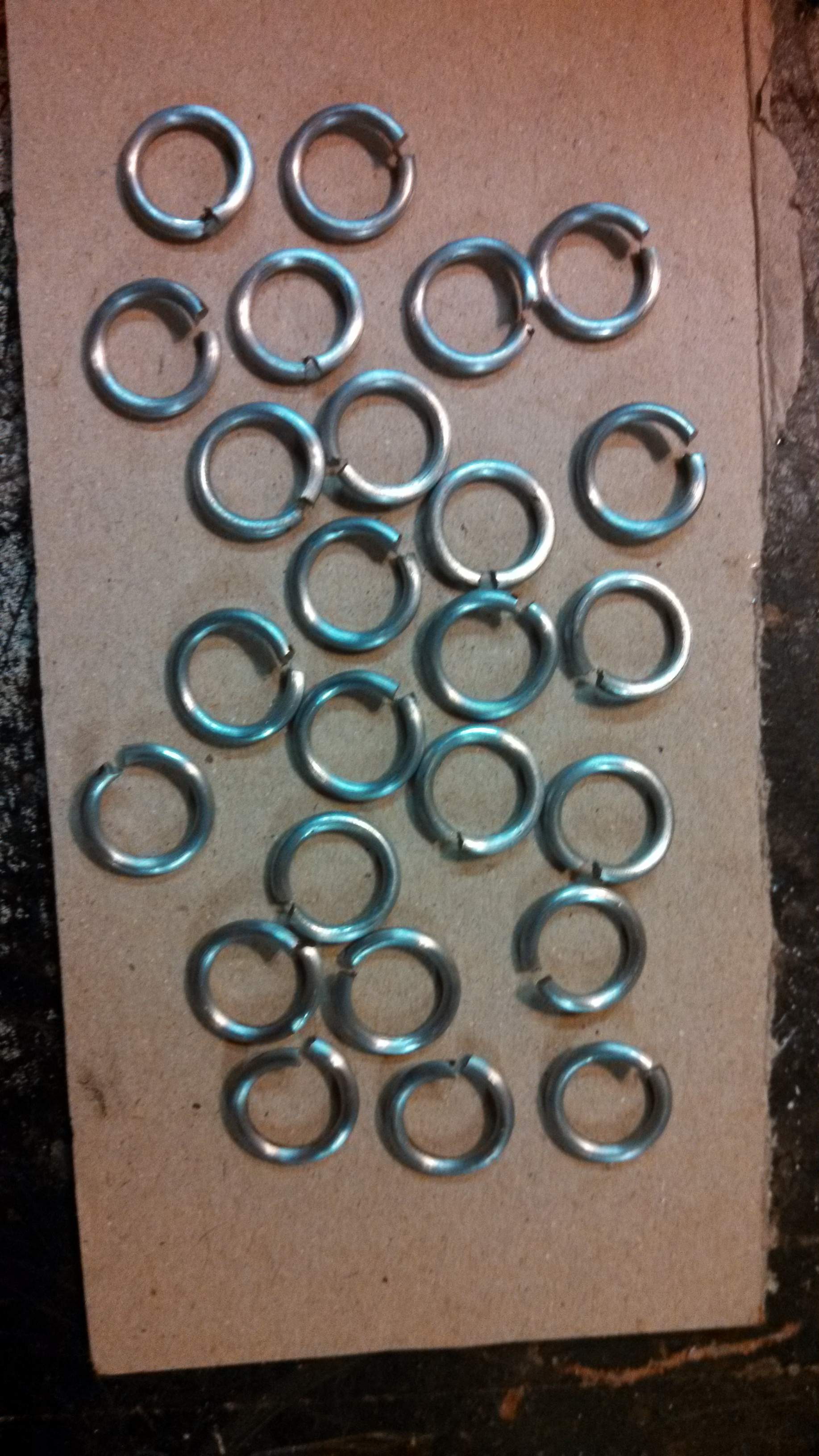

Then I wound the wire around a piece of ground rod and cut it with a Dremel disk. As shown hereIMG_20131018_103554_525.jpg
Here is what the rings look like when they come off of the ground rod.IMG_20131018_104229_173.jpg

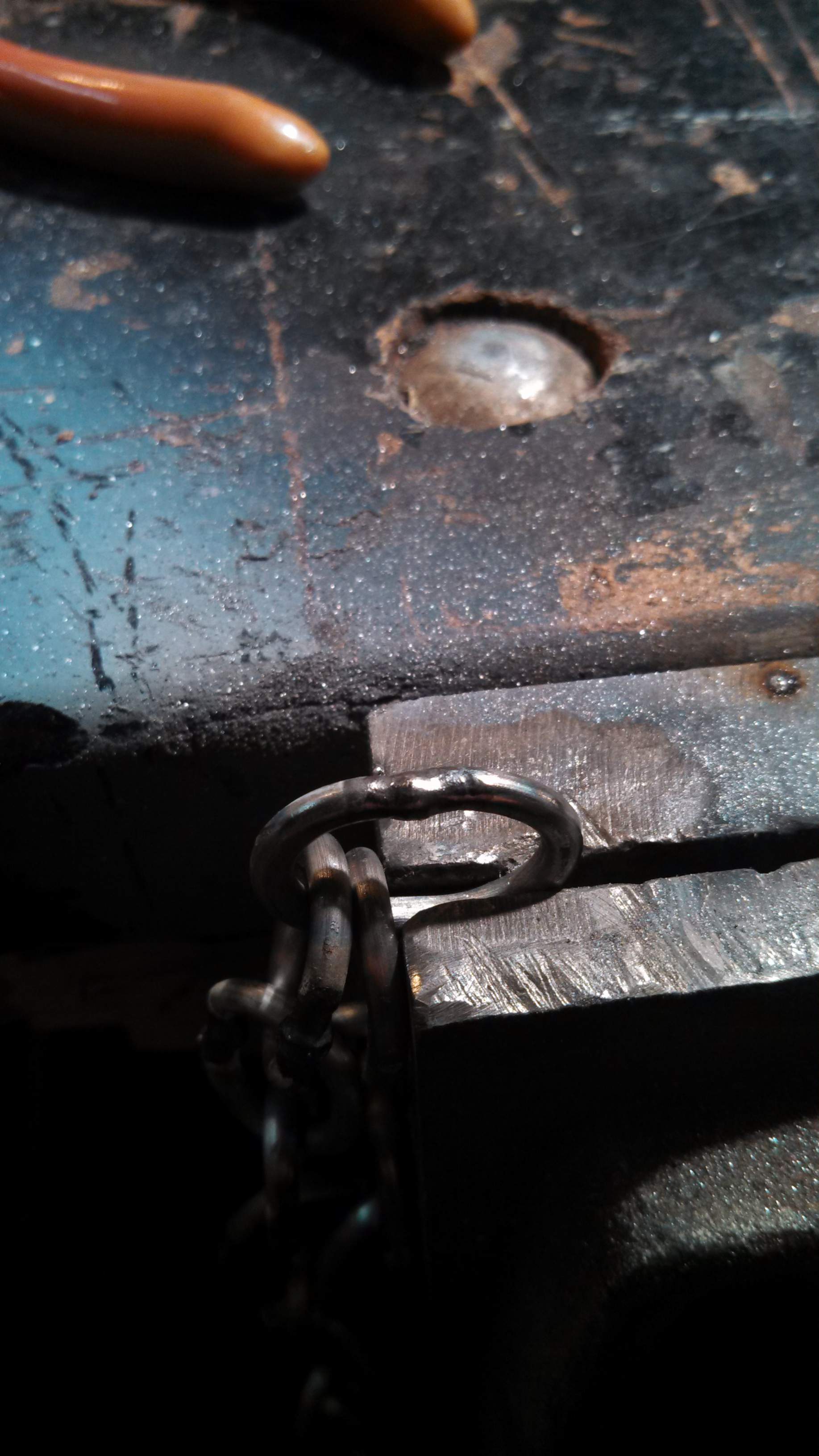

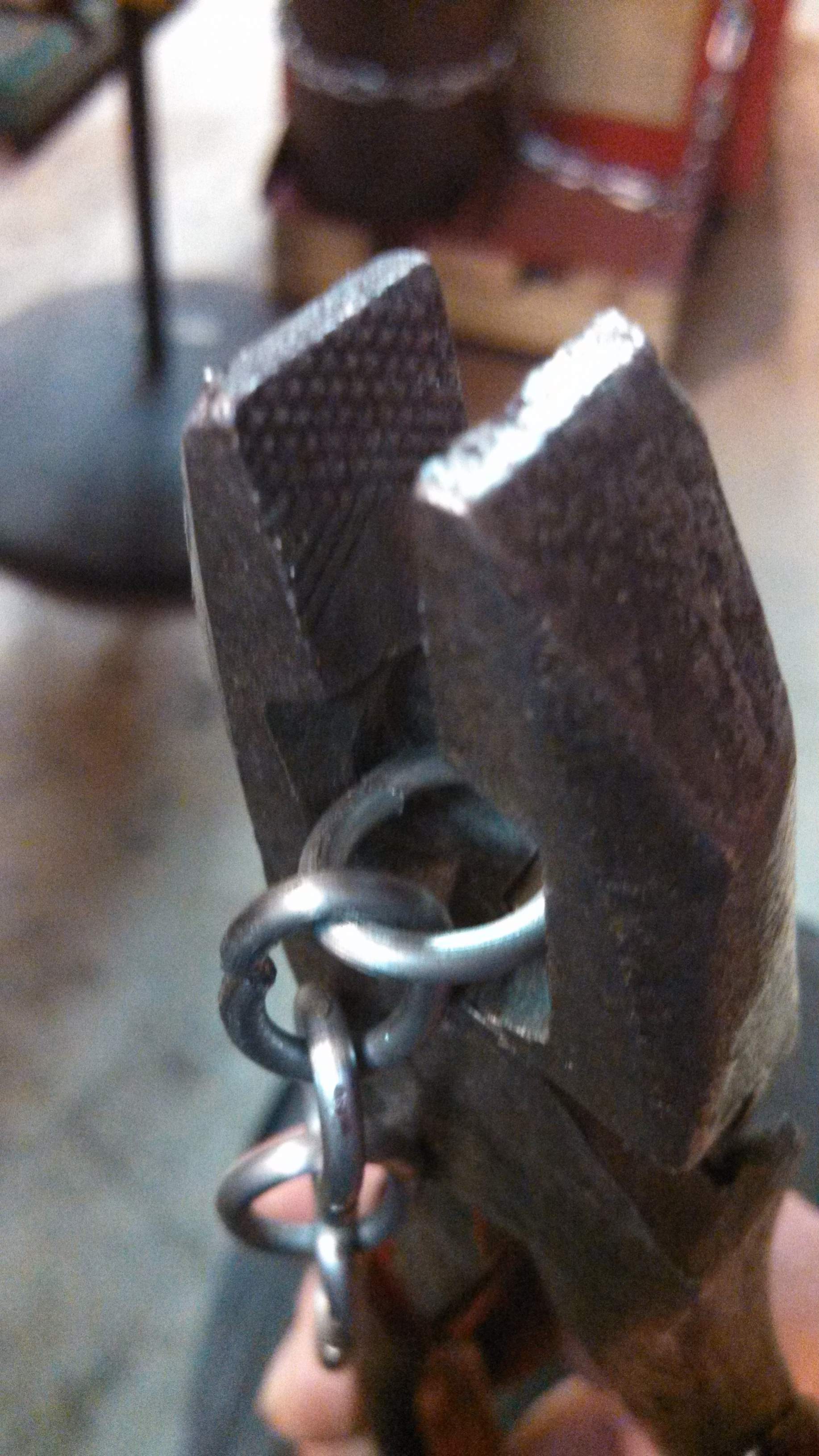

I formed the links using a pair of Linemans pliers as shown here. Keep the ends lined up for the welding operation to follow.IMG_20131018_105129_520.jpg
Here is the completed chain now ready to TIG weld the ends of each flattened link together. Gas welding would work as well or better. and I imagine MIG would work well here also. Stick welding would really suck at this operation.IMG_20131018_114918_529.jpg

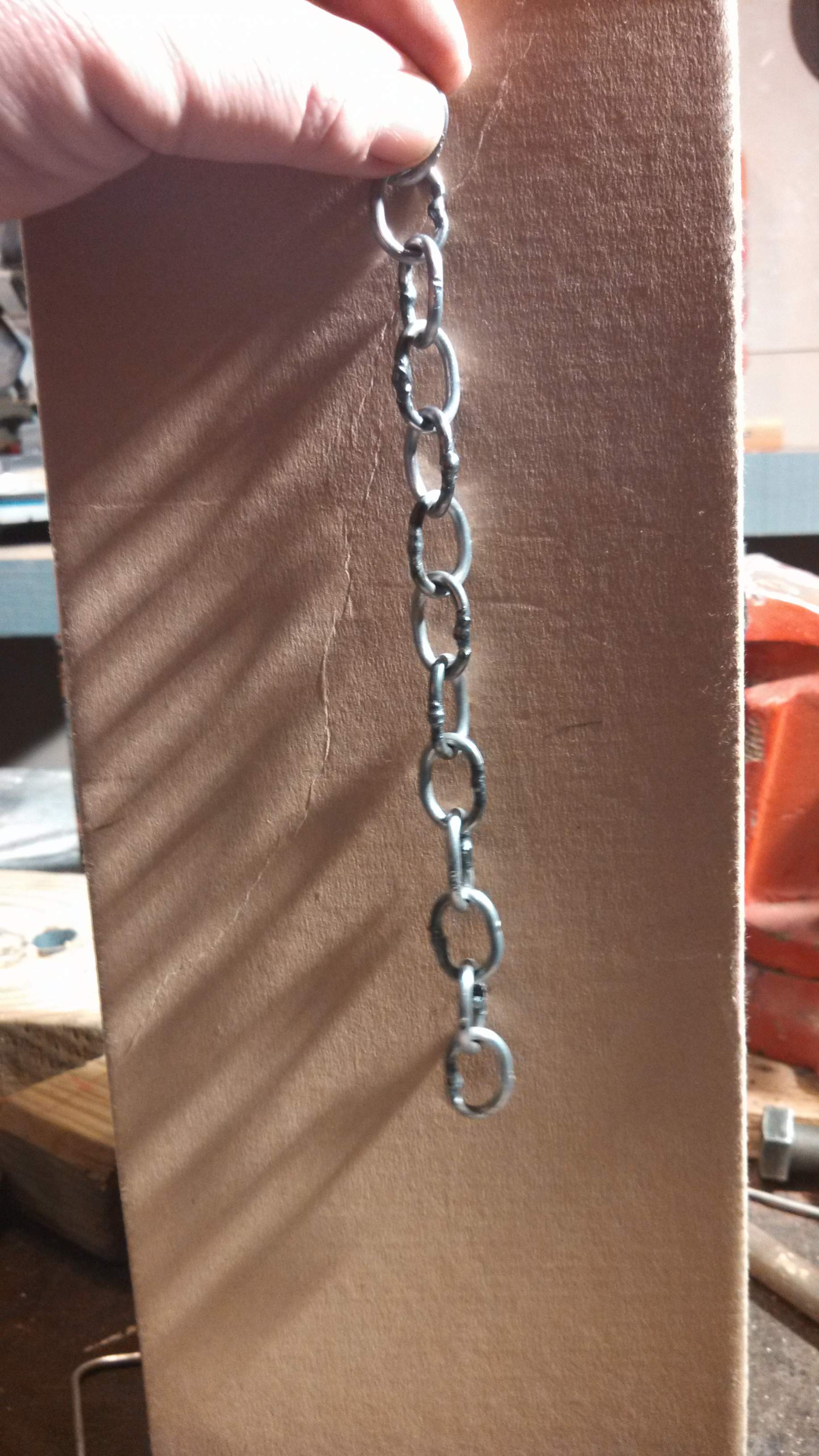

And here is the completed chain. Some links look better than others, but they all held when I tried to pull it apart, and it will not have much stress on it for what I intend to use it for as a pin keeper chain.IMG_20131018_115507_563.jpg
