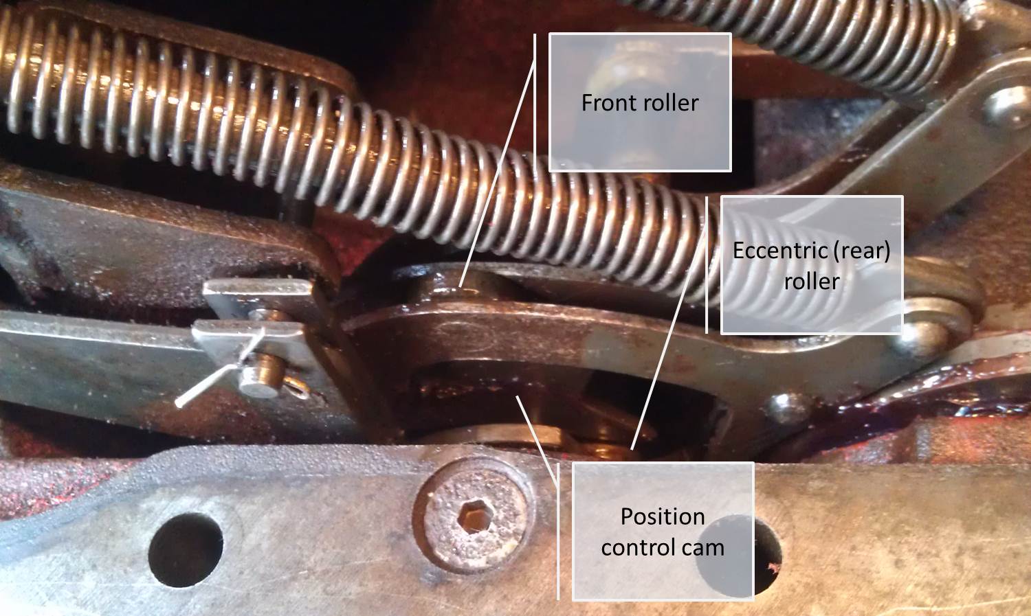

My Position Control is not working. On other sites I have seen references to this issue: speciifcally the position control linkage becoming displaced when the position control lever is moved outside of its normal range of motion. Back in 2004 on a forum in Yesterday's Tractors, Big Dean Austin stated that "the Position control has a piece of linkage that when you move the position lever to (sic) far it will jump out of place it will happen almost every time you do that. To get it back where it belongs you will have to remove the liftcover. I have a picture showing this & how to get it back in place." Does anyone know anything about this or have the fix that Big Dean was referring to?
Thanks!

Well I repaired the position control problem, but I am not precisely sure about the exact cause. It could be one or more of three things (refer to photos below):
1) the eccentric (rear roller) had become displaced from the position control cam.
2) the front roller (position control) was frozen in place (i.e. sliding instead of rolling along the cam face).

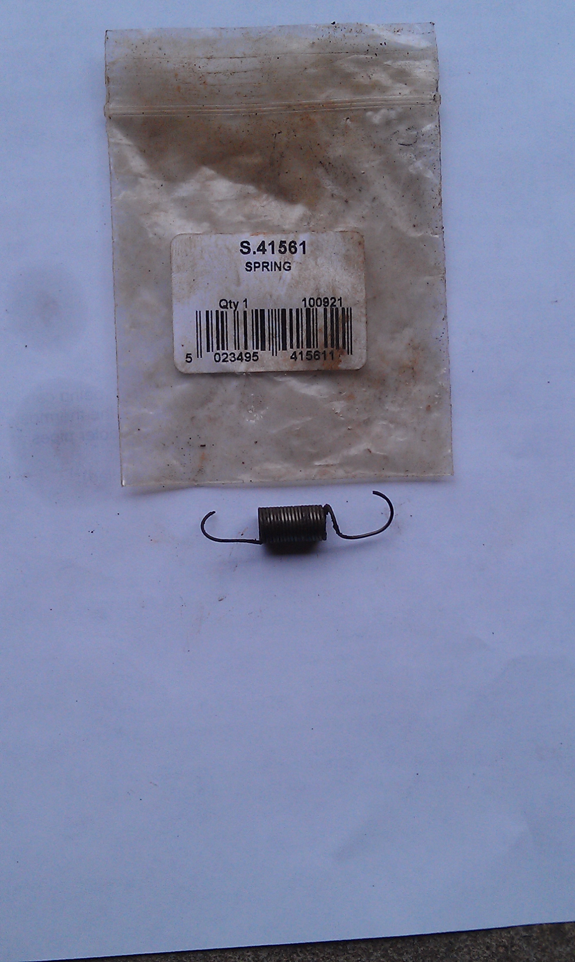

3) the position control return spring was elongated (the last coil was stretched away from the other coils).
My thought is that the eccentric (rear roller) had become displaced from the position control cam. In the process of trying to understand the mechanism, I was moving the position control lever and "feeling" the cam with a screwdriver blade. I think I caused the rear roller to correctly re-engage with the position control cam tip. I replaced the spring, freed the front roller, adjusted the hydraulic linkage and re-assembled. The position control is now operating. At this point it seems to me that "Big" Dean Austin's fix (referenced in my original post) was to remove the top cover and re-position the rear roller on the position control cam. However, a broken return spring would also be a problem. I hope this may help someone in the future.
