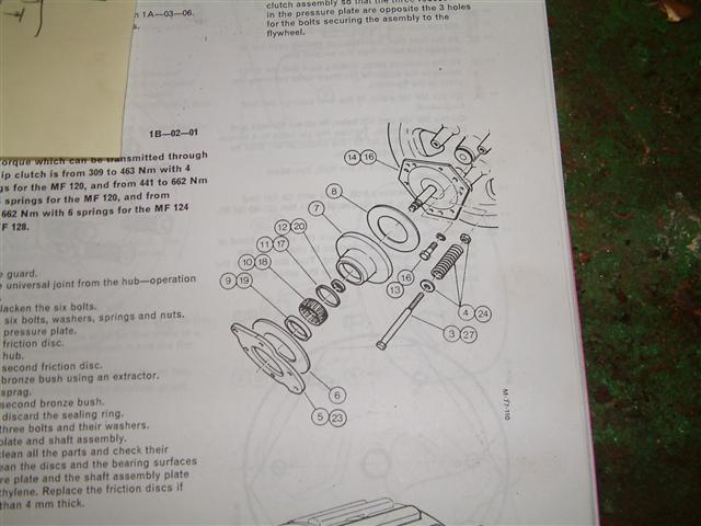

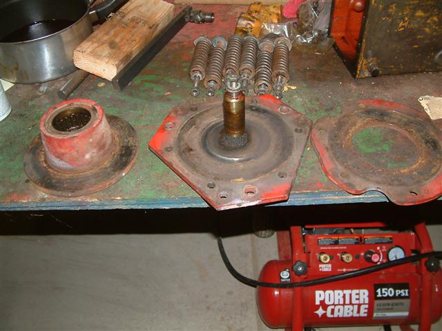

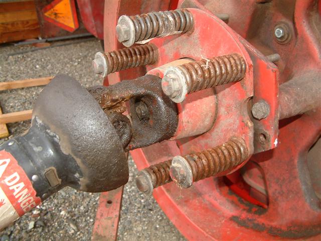

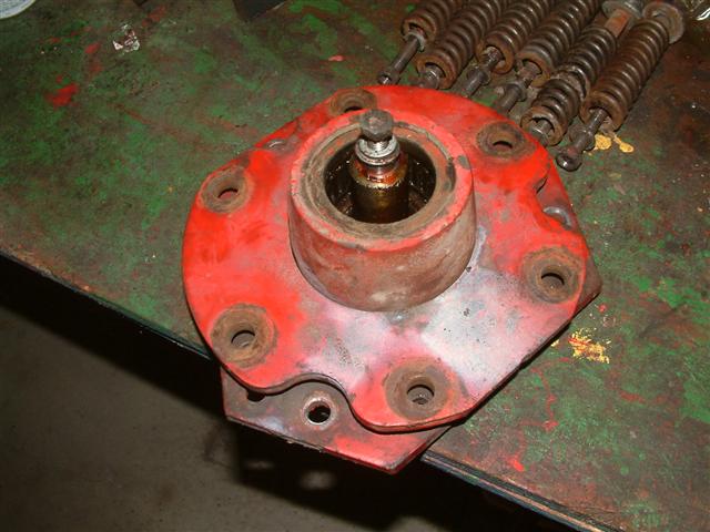

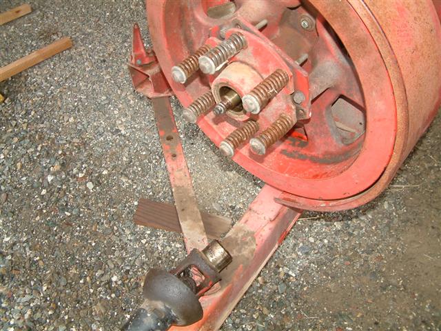

SG: thanks for that info. It's really timely since today I disassembled the slip clutch on the MF124 baler.
The pto shaft plugs into the sprag clutch inside the hub of the slip clutch.
There's supposed to be two friction discs (#6 and #8) sandwiched between the drive/driven plates. Those discs have been worn down to nothing.
With nothing left between the plates, I could do short bales (24" long or so) OK. But when I tried to do a full length bale (~45" long), there was so much resistance in the baling chamber that the slip clutch started slipping.
I think I have a vendor for new friction discs. Hope to hear from him tomorrow. If not, I'll try the MF dealer in Chico. Don't like to do this because prices are high.
I may be using your suggestion if nothing else pans out.
