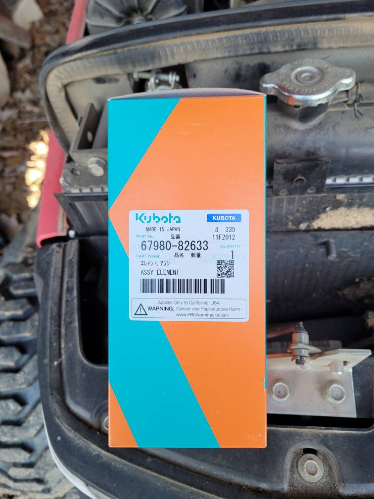

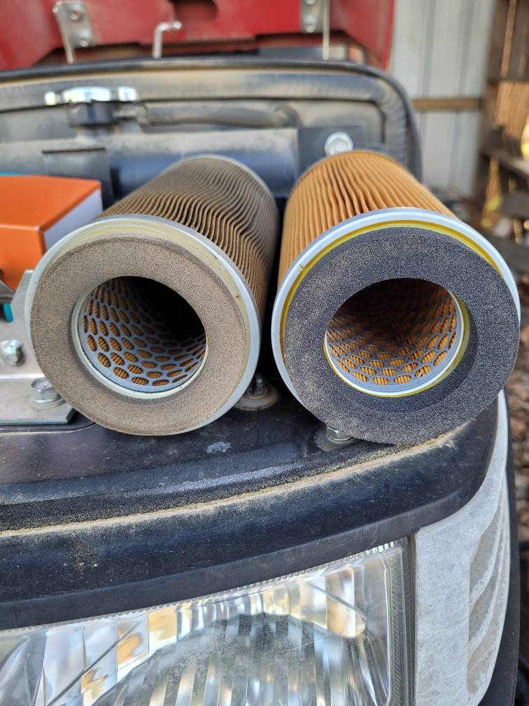

I have a max 26xl. I ordered air filter from Amazon. When it comes in I will update on if it worked
   / Max 28 Filters #3
Here is filter off Amazon seems to fit perfectly. Note the box that was inside Amazon boxView attachment 741797

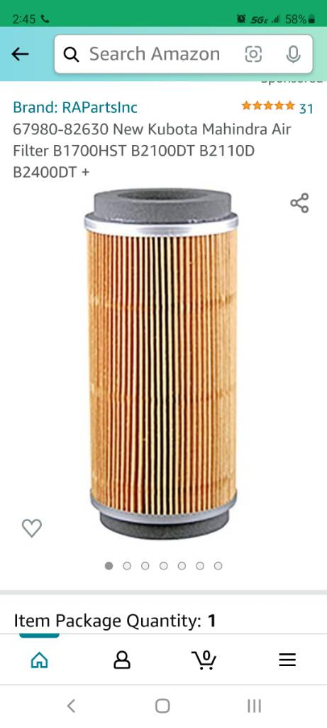

What is the Amazon number to order?
Thanks
   / Max 28 Filters #5
Can you read it off screenshot
   / Max 28 Filters
Yes, thank you! I’ll get one ordered.
