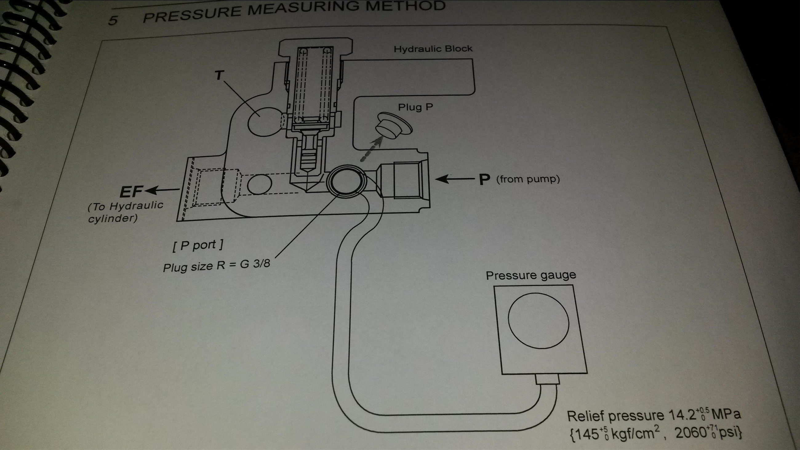

Ok This is for the Max 28 shuttle.... there are some variations between the auto and the manual shift (these are for the manual)
Hope this point you in the right direction
Good luck, J_J is right - you will need a hyd gauge to check the pressures. Please post your results as I am curious as to what is causing your issues
Don
   / MaX28XlL is 98 lb weakling, Main Pump Pressure Low
Don

Thank you. I appreciate you even titled the photos!
I'll order fittings and plug in a gage.
