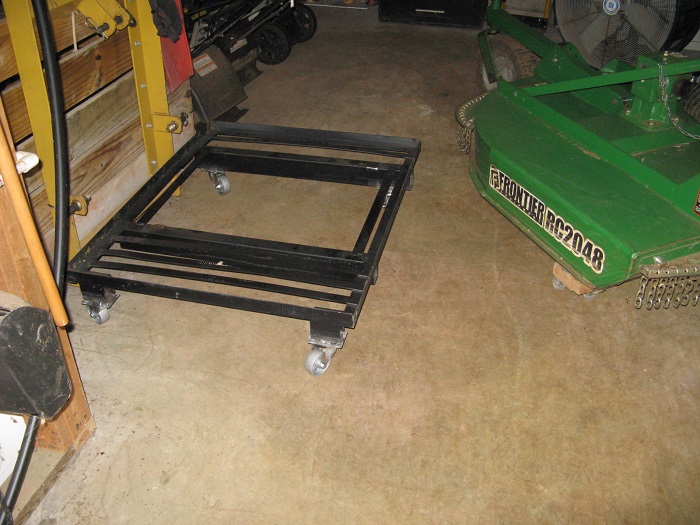

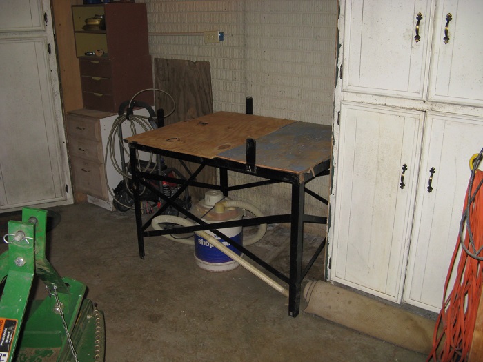

The Woodland Mills chippers come inside a box but with a metal reinforcement frame inside the box.
Here are pictures of what we made with the metal frame. The top was made into a table. The bottom was made into a dolly to sit the idle chipper onto to allow rolling it around. Cost me $70 for 300 # metal castors from TSC and $100 to get them welded.
You can also see the 2 by underneath the front of the bush hog with steel casters underneath it.
